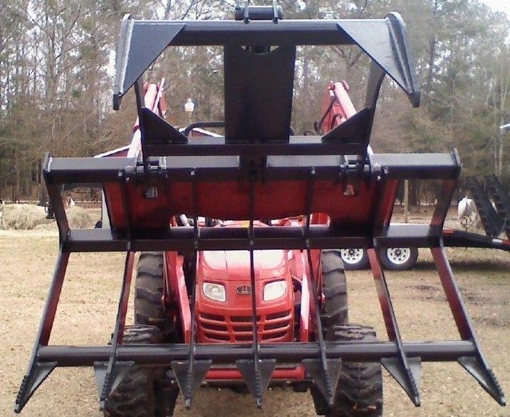

I got the EA 72 inch wicked root grapple for my 52 hp Kubota. This grapple is no lie, very heavy duty, and pops out small trees like there's no tomorrow. Runs through the ground cleaning up small stuff very efficiently, with little soil disturbance. Highly recommended. View attachment 346343
Thanks, I'll take another look!

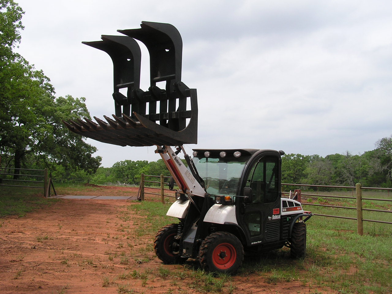

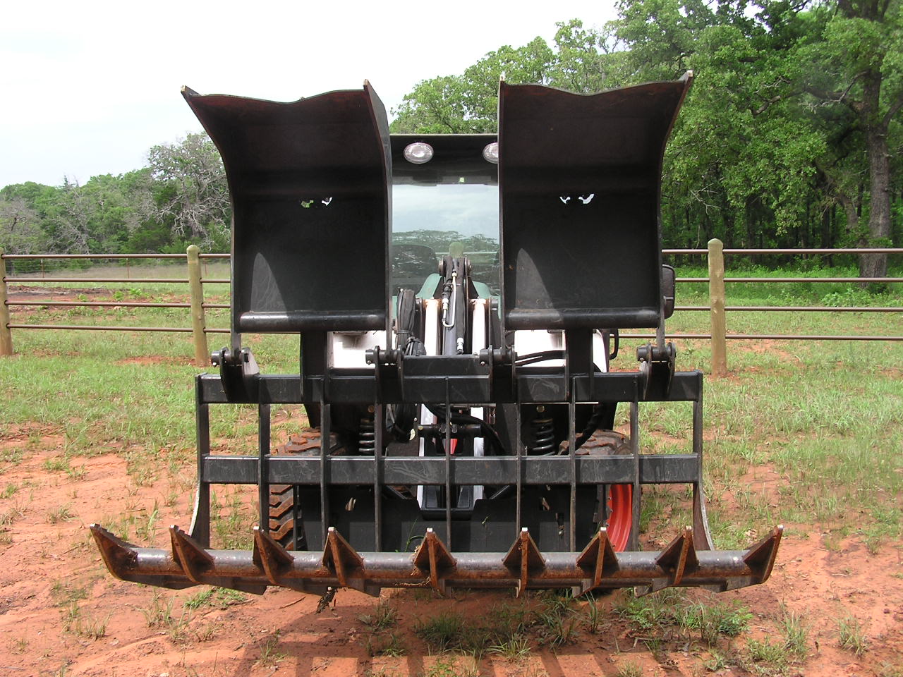

I got my Monster Grapple from eBay, It was recommended by the Bobcat dealer.
The same seller has several to choose from. Here is a single lid.
I'll second everything he said.

I got the EA 72 inch wicked root grapple for my 52 hp Kubota. This grapple is no lie, very heavy duty, and pops out small trees like there's no tomorrow. Runs through the ground cleaning up small stuff very efficiently, with little soil disturbance. Highly recommended. <img src="http://www.tractorbynet.com/forums/attachment.php?attachmentid=346343"/>
Just remember it is the loader that is popping out the trees. Any grapple, including much smaller and less expensive ones, can do the same job. No one should assume they need a grapple as wide as their standard bucket. Indeed, for popping out trees, a narrow grapple is preferred as it is easier to stick under the roots and curl up. Loaders with lift capacities of over 3000 lbs have been used successfully with very light duty grapples. If you think about it, a grapple made of 3/8" mild steel has far more structural strength than any standard bucket. Small is beautiful.

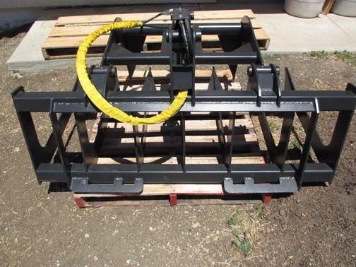

Right, these would be good diggers. They have a 42" opening to boot, more than most of the smaller grapples. Favor makes Skidsteer and large loader grapples, so they are not an unknown.
http://www.ebay.com/itm/Skid-Steer-...avy_Equipment_Attachments&hash=item3f2be30bc5
