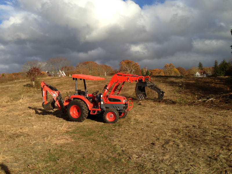

Here's a few action shots as promised... I cant believe I waited so long to get a grapple, they sure are useful once you get the hang of it!! I built a SSQA adapter to work with my Euro QA with universal SS conversion plates from Titan....it turned out to be a little too light duty for my needs so Im in the process of building a HD model to keep on it permanently. Im building my new SSQA based off the design of mwb(Mike) from TBN. I should be done with the new SSQA in a few days Ill try to post pics of it when its complete. I will also post a few before and after pics of my land clearing project once I get it all cleared and piled up. As you can see from my last pic it was a little to wet out to be moving brush around so I wasnt able to push my brush pile as tight as I would like without making pretty severe ruts. I look forward to finishing this field next week! Thanks again to everyone.

As far as I know they are made in the US, but I am not positive. If they were imported, my bet is that they would not come assembled from overseas, I would think the tops would be stacked as well as the bottoms then assembled here to save space. Like almost anything theses days, it is hard to avoid overseas goods, particularly components.
