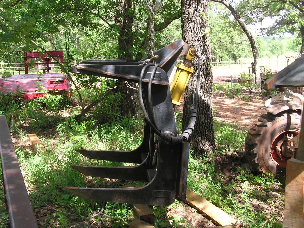

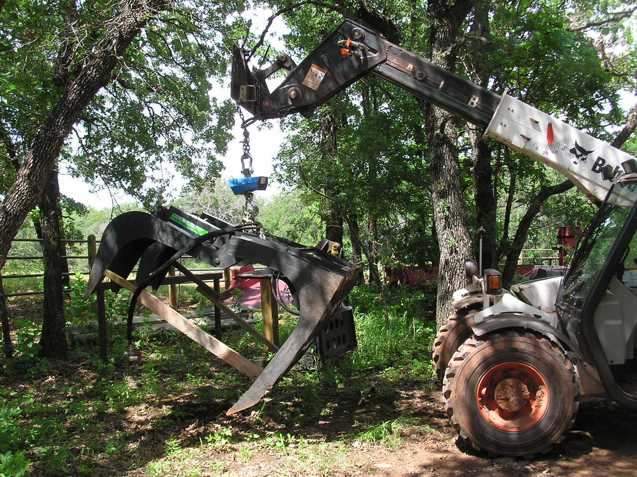

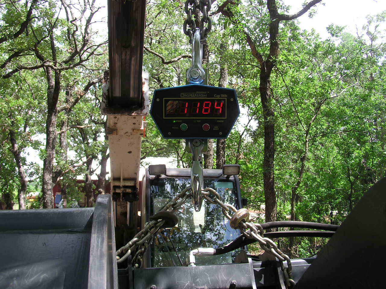

I am right here, but can only show you what mine weighs!
The Gorilla Grapple, 946 pounds.
The Monster Grapple, 1,184 pounds.
