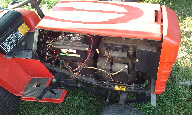

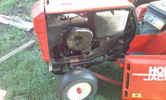

I got a homelite/Jacobson garden tractor that i am looking to build a loader. Anyone ever do this?? Could someone help me design one. I know the tradition design of a loader but could someone help me with attachment points
Can get more/better pictures if needed

Yes, people have done it. I designed and built mine, but it is for a 4wd tractor that came OEM with one as an option. Difference is nothing on that Homelite is heavy enough to handle the extra weight.
/ need help designing a homemade loader
If you had a personal look at the tractor the frame and front axle is super heavy. The frame its self is 3/16+thicker 2 in pipe. The front axle it's huge for a garden tractor. And the the tires. Yup about junk. Those will get replaced

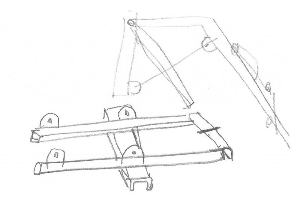

I would with that mower, most likely flip it on it side and start to figure how to make a entire sub frame and attaché it in the front the middle an back to the rear axel, (my first thought would be to use 2 inch square tubing about 3/16 to 1/4 wall, two pieces on each side, then use some flat to reach up and bolt to the current frame may be a heavy angle across the front or a U shaped piece attach where the front axel goes, and then attached the front axel to that,
come out the about the middle with a channel or tube to attach the loader to, and some place in the front to mount some angle braces, possibly the front U shaped piece I said to mount to where the front axel mounts, extent it a little to bolt the angle braces on to the up rights,

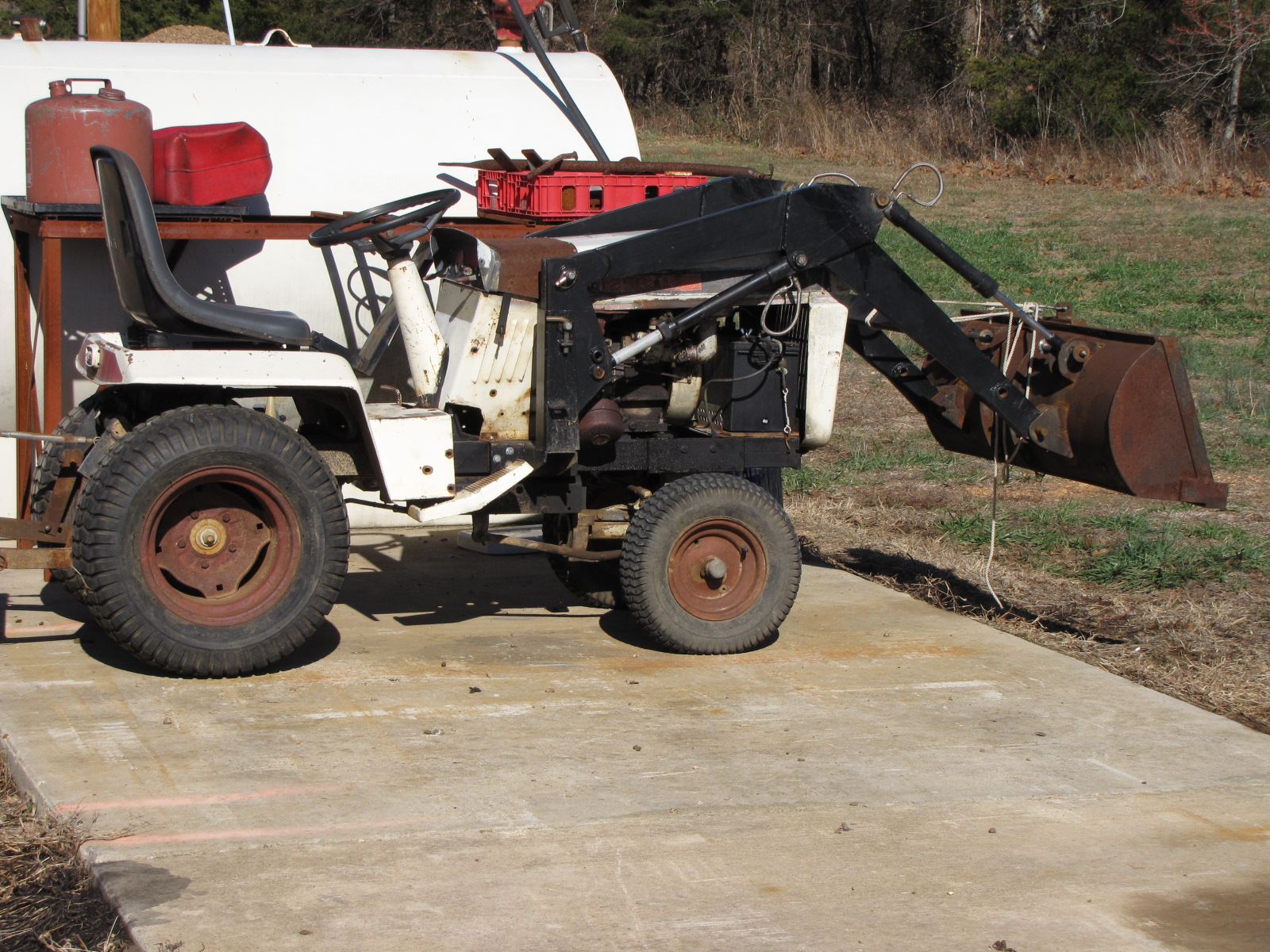

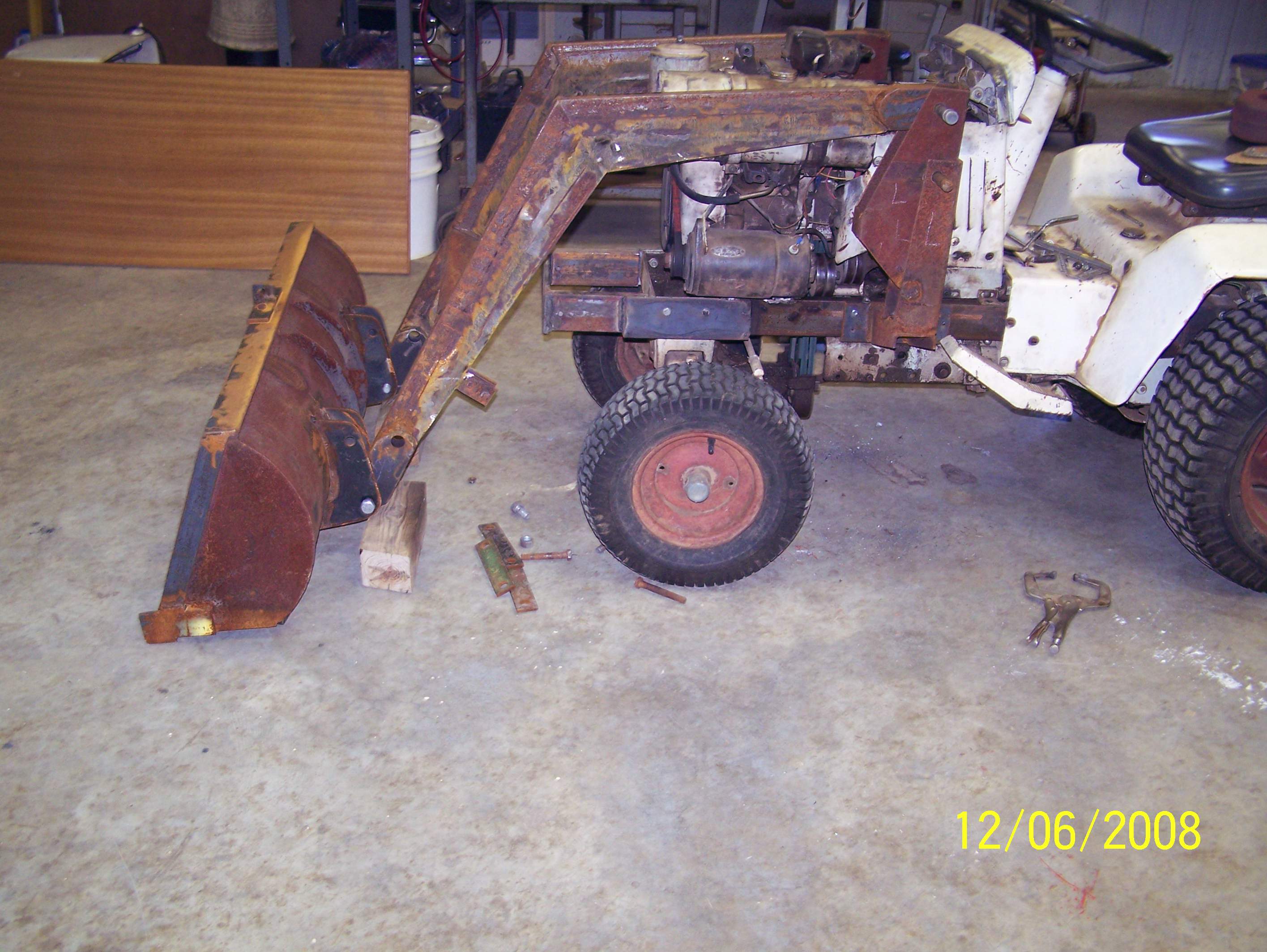

I did one for my Bolens.I can tell you the tube frame isn't as heavy duty as you are thinking. I changed the frame on mine from tube to 1" X 3" X 1/8" wall. Also made it a little longer so I could move the battery. Here are some pictures of it. Before I got the hyds hooked up traded it for a lawn mower with a bad trans. and a good engine. Most of the parts to fix the trans were NLA , if not NLA the price was way up there. So I cut in half and got a old Ford rear end with the eaton 11 trans. Now I have a kubota front and a ford rear end. Here are pictures of the K-F.
That's one heck of a loader. Though I'm not building another complete frame.
What i want to do is build a long subframe most of the way back to the axle and over the front maybe. And make out attach with 6 or 8 bolts. At the same time have the possible pto pump mounted to the subframe. Not sure what I'm going to do with the electric or hydraulic pump

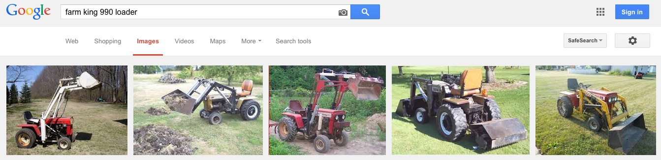

Have you looked through the sites found on Google images to see how they mounted their loaders?
