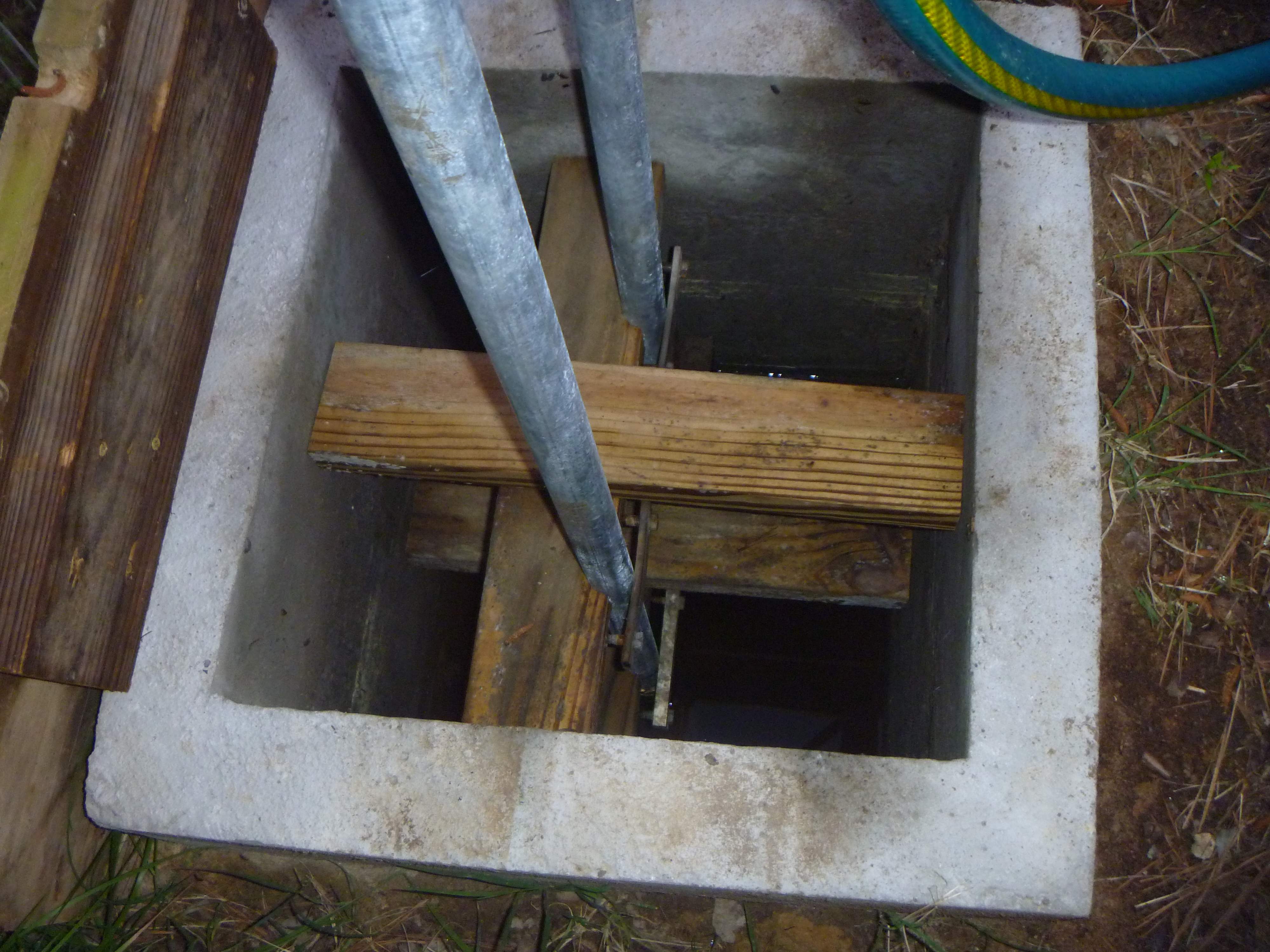

I had a similar problem with a 3/4" Pex to hydrant connection. My connections were in a concrete box which was a lot of trouble and may not be an easy solution. The pic shows 2 pair of treated supports wedged inside the box with the pipes bolted to them. (There two lines - well water and rainwater from a cistern.) The pipes can't move left, right, up or down.

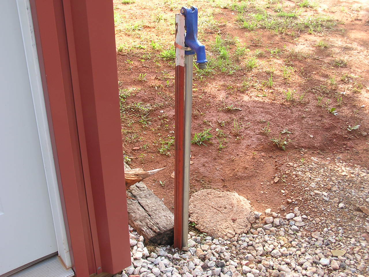

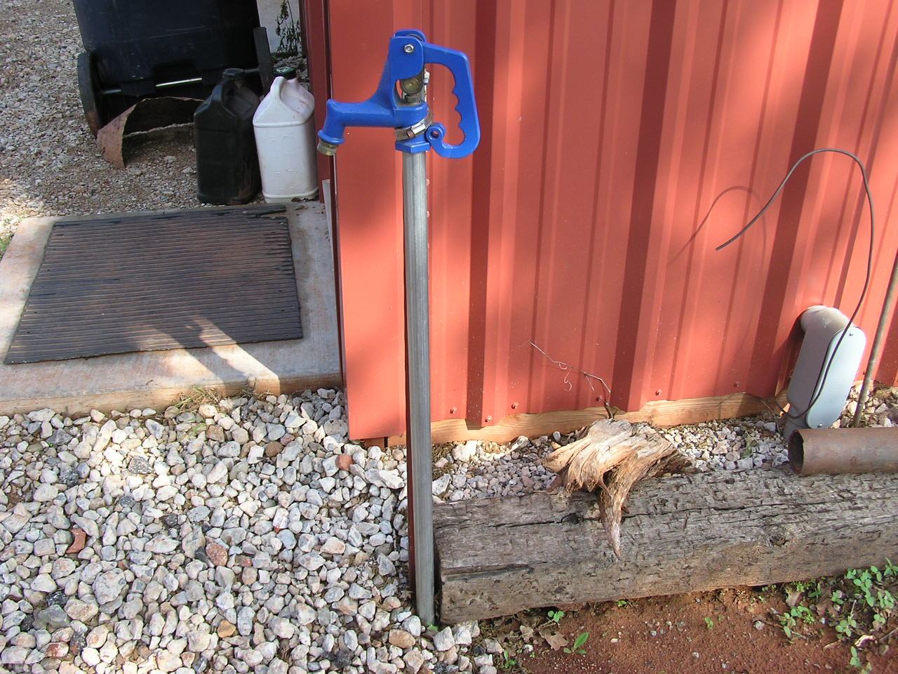

This is what I have on the Tee Post.
Bailing wire even works! :ashamed:
Looks like I need to brace the electric box.
