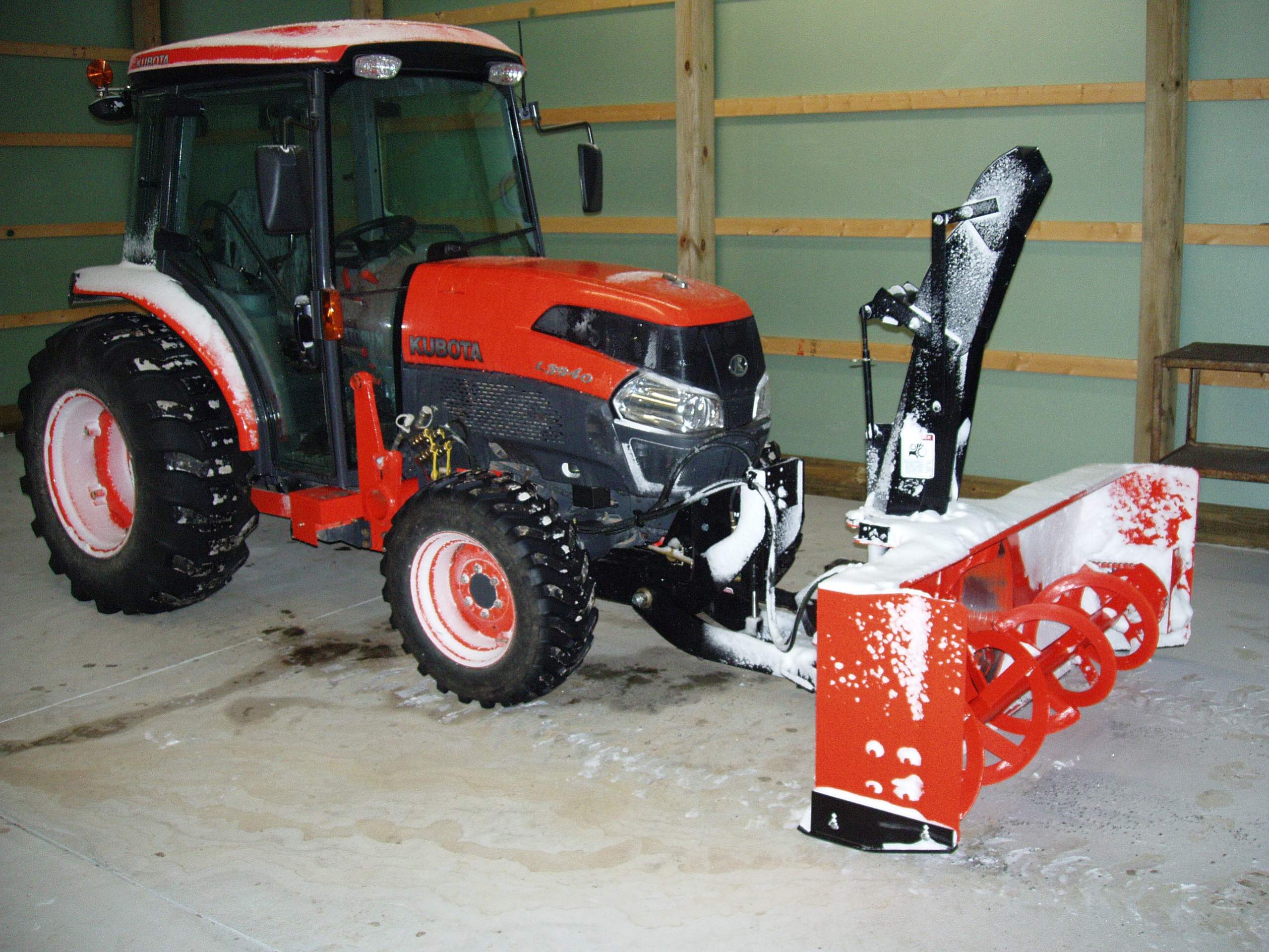

Those with front mounted snow blowers on L Series tractors. Reference L3130tractor and quick hitch L2180.
Do you still have the Grill Guard attached when mounting the Quick Hitch? I have seen pictures with the grill guard in place, but on my tractor there is interference (see photo). My grill guard has a metal support that prevents the quick hitch from going inside the grill guard (see attachment). Is there a different grill guard available for use with the quick hitch or does the grill guard has to be modified (cut the support bracing from grill guard).
I do not have instructions on how to mount the quick hitch and working blind, so I need your help.
Yes, I know I can remove the grill guard or cut the bracing off the grill guard. I just want to understand what Kubota recommends and what others had to do.
Just sold my rear snow blower and this needs to get on ASAP.

Remove the grill guard and reinstall it in the summer season as you want t protect the motor compartment anyway as a priority.
The snow thrower frame will not allow it to raise properly with all the metal in the way.
I think a lot this is because of the tire size and clearances as a narrow mudder crop tire and large diameter rim with a taller hieght has a greater ground clearance.
edit: once you remove the grill guard the quick hitch should mount directly in the nose of the frame with matching holes- be sure to use nylock nuts or the blue "Loctite".
edit: do you have suitcase wieghts that mount on the grill guard?

I had a sub-frame on a L3130(for a plow but same for blower),you must remove grill guard.Two bolts not a biggy.
/ Need Help. Front Mount Snow Blower Question #4
The smaller framed Grand Ls (3240, 3540, 3940) can have the guard attached but on my 4240 in needs to come off. If you are having problems trying to make it work, leave it off. Just put some anti-seize on the threads of the bolts since you'll be removing them twice a year.

I ended up removing the grill guard, but it was frustrating as I spent too much time mounting the QH bracket and grill guard before hand. Only to realize I'd have to take it off. It is difficult holding both of these heavy parts and trying to get the bolt started. Used some ratchet straps from the raised FEL to hold both brackets in place.
I already have the grill guard removed and the front pins in the QH. Now I have to figure out how the back mounts and get the length of the QH correct... Then modify the fixed drive shaft. This QH came off a L4330 and therefore has a longer fixed drive shaft.
In a private message some one said they had to cut the bracket off the grill guard to make it work. I'll do that later when I have more time.
Oh, and anit-seeze is my friend.
Any tricks to mounting the back of the QH or adjusting to the proper lenght?

I will tell you that you mount the BACK first and you jockey the thing with the hydraulics.
To give any better info you will need to post some more pics of the whole setup and how you are trying to mount it.

If the thing is set up right the front pins slide in easy and the middle pin sockets are adjustable.
I do not understand your concerns.:confused:
Look at my avatar, I do have one of these and have some idea how it works, I even assembled it from the crate myself.
Your dealer should be able to order the manual. :confused2:I would think that they have info there as they must service this stuff.
You need manual 70060-04542

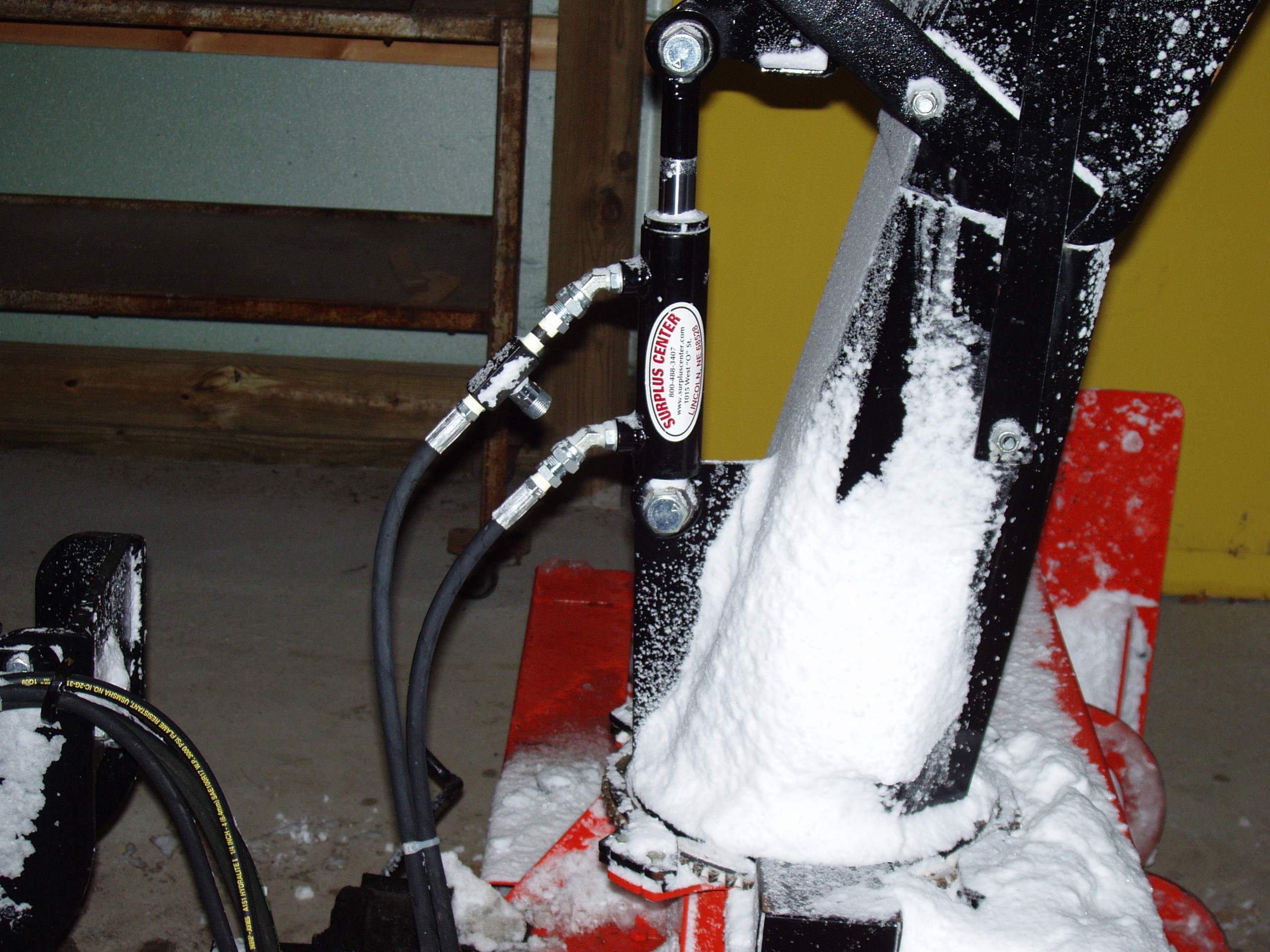

Loader sub frame stays on, but the loader must be removed:thumbsup:

Thanks for posting the pdf files. They are a big help! I realize I need the manual, but the Kubota dealer I got the frame & blower sounded like they were going to supply and then said they couldn't get the instructions, so it put me behind the eight ball ordering one for this weekend from my local dealer.
Where did you mount the switch for the chute deflector? I'm thinking about mounting it in or near the 3-pt lever cover.

My chute is hydraulic.

The posted PDFs look like the same instructions for the 6' blower on our GL5240. We bought tractor, quick hitch, and blower new from our dealer, and had them assemble, install, and test everything. Apparently they did not read the manual, because when I went to install the quick hitch before snow, it was too long to bare against the drawbar which is intended to accept the axial force of the blower. They must have not used the drawbar when they adjusted the QH length. Reading the instructions, I realized that my 1/2" torque wrench would not produce the required 297 ft-lb at the center joint that sets the length. (Thats in the third bullet in step 6, on page 20.)
I called the dealer, explained my lack of tools, and the dealer came to check. I think they thought I was nuts. It proved fortunate, because those 297 ft-lb bolts came loose with LOTs less torque than that. If left as-delivered, or with the drawbar one hole back or out (as the dealer suggested) the force would have come out on the front mount and possibly damaged the tractor.
The reason I write is to suggest you ensure the length-adjustment bolts are correctly tightened.
The dealer's tech agreed the QH was set too long, and he did torque to the spec with a 3/4" wrench. The blower works great. You will love yours!

The driveshaft is cut to length and welded. Just waiting for the paint to dry. The electrical switch for the chute deflector is installed and the wires to the front are wire-tied in place.
Getting close, but need to do some other non-tractor activities.
