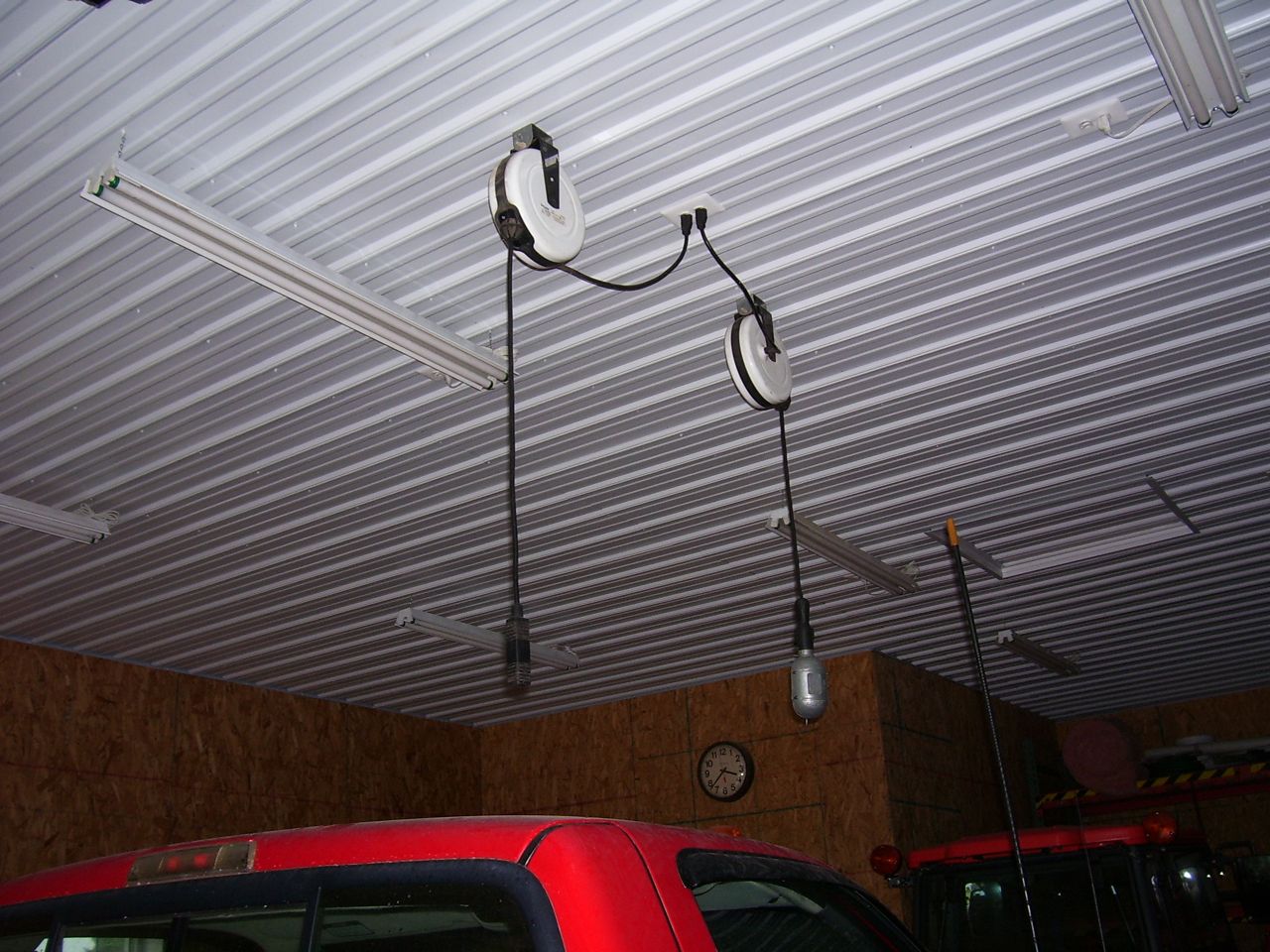

By them once, stay away from the Home Cheapot/Lowes crap. Go to a EL supplier and get the T5 54 watt HO tandem fixtures. These are the new style that has the very thin (about 3/4") bulbs. Here is a picture of the ones I put in my pole barn, more pictures are in the link below in my signature.

That is what I have in my shop. An industrial electrcian friend told me to go to an industrial supply house to buy the good stuff and to stay away from HD/Lowes for shop lights.
   / Need Help lighting for new garage #24
Yup, They are awesome! So bright you can hardly look at them directly. And they are quiet because of the electronic ballast's.

Kenny, T5 lamp is 1/2 inch.. all lamps are sized in 1/8" increments,, It's good to see you used the T5 fixture It was a good choice.. they do tend to run a bit hot but other than that they put out great light in a small package,,

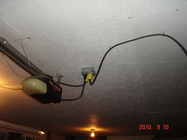

I used a combination in my garage: four 26W CF bulbs on two switches, followed by what I could find inexpensively: three 8-foot doubles, and one 8-foot single. All are on their own pull-chain switches. Later, I added two more 26-watt CFs in sockets, also with pull switches. That way, even if I turn on both switches when I enter the garage, I have reasonable light and only a bit over 100 watts. I can then pull chains to get more light where/when I need it.
I also used the outlet-on-the-ceiling route, but used "4-holers." That way, I can easily move light fixtures around later, as the garage evolves....:laughing:

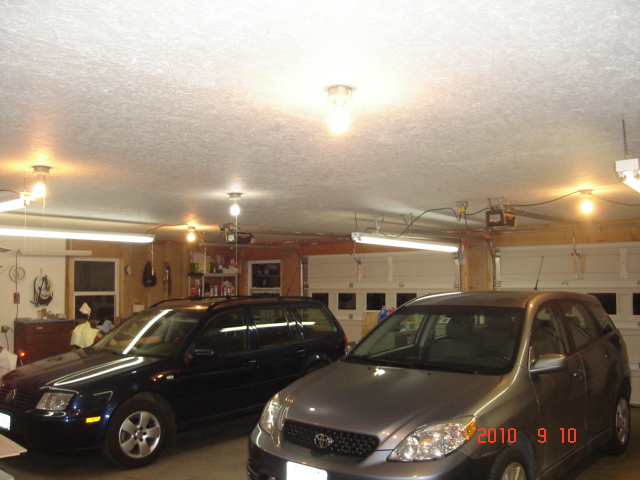

One of the biggest favors you can do for yourself is to get some white paint on the walls & ceiling; makes a HUGE difference in how the light gets spread around. I used el-cheapo $7 Home Depot 7/16" wafer board and slapped a coulpla heavy coats of white primer on them. My garage is 32 x 32, but (unfortunately!:() I went with an 8 foot ceiling. (Wish I had more height now!)
