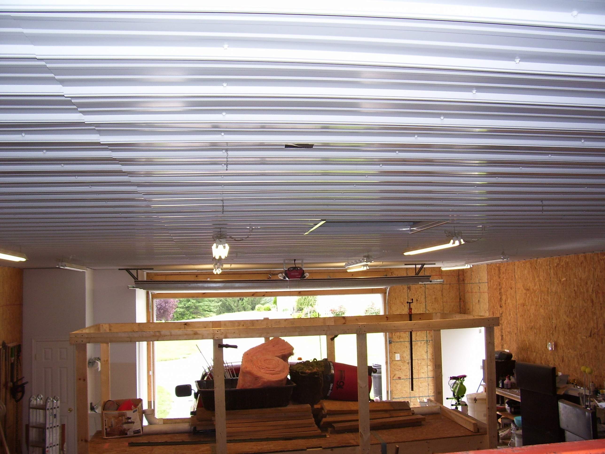

scrivy69, I have a 30 X 40 with a 10'+ ceiling. As far as the the cheapest you could go with the keyhole type sockets and just put in light bulbs. What I did (on the cheap side) and quite pleased is I went to Lowes or HD and bought the 4 foot 2 bulb shop lights with electronic ballast. I think they are T-8 bulbs. I place outlets in the ceiling controlled by wall switches to turn the lights on. I have a total of 4 rows of lights. 3 in the front, due to the garage door opener, 4 in the second row, 4 in the third row, and 3 in the back, due to a small room there. Haven't had any problems with humming due to the cold winters and if one should fail I'll just buy a new shop light. The lights have been in 3 years now and I'm very pleased. I'm sure the 8 foot bulbs as suggested may be better but like I said I went cheap. Let us know.
Here is a picture of some of my lights.
