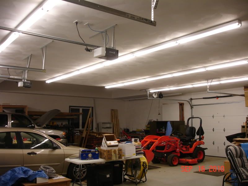

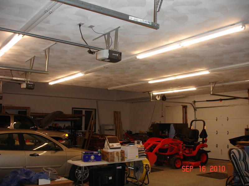

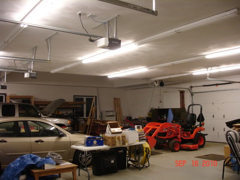

Here's what I did. Garage is roughly 30x50x10. Setup 4ft fixtures uses T8's and made it so I can have either half on or all on for extra light. Plenty of light with just half on, camera doesn't do it justice. :)
