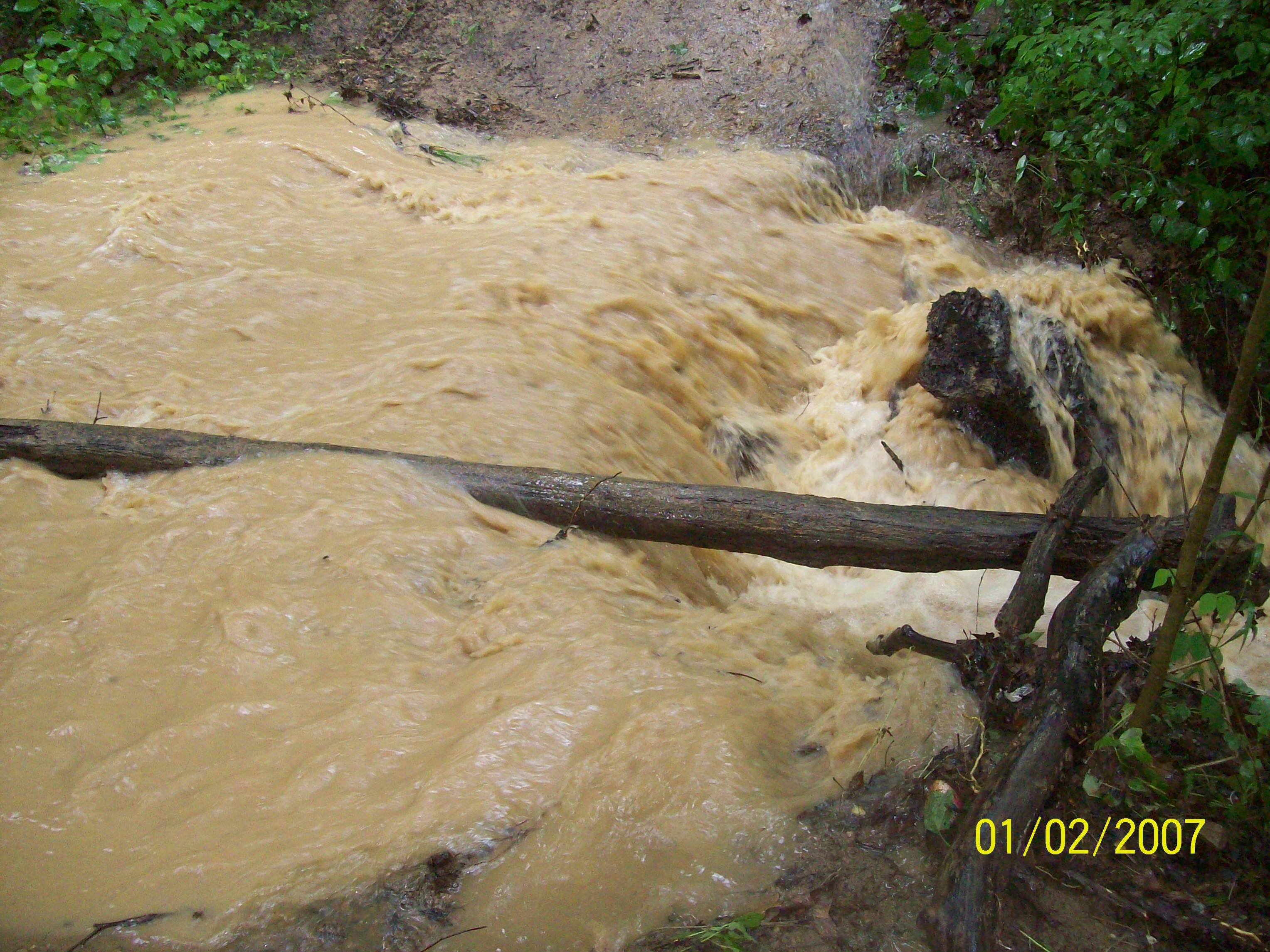

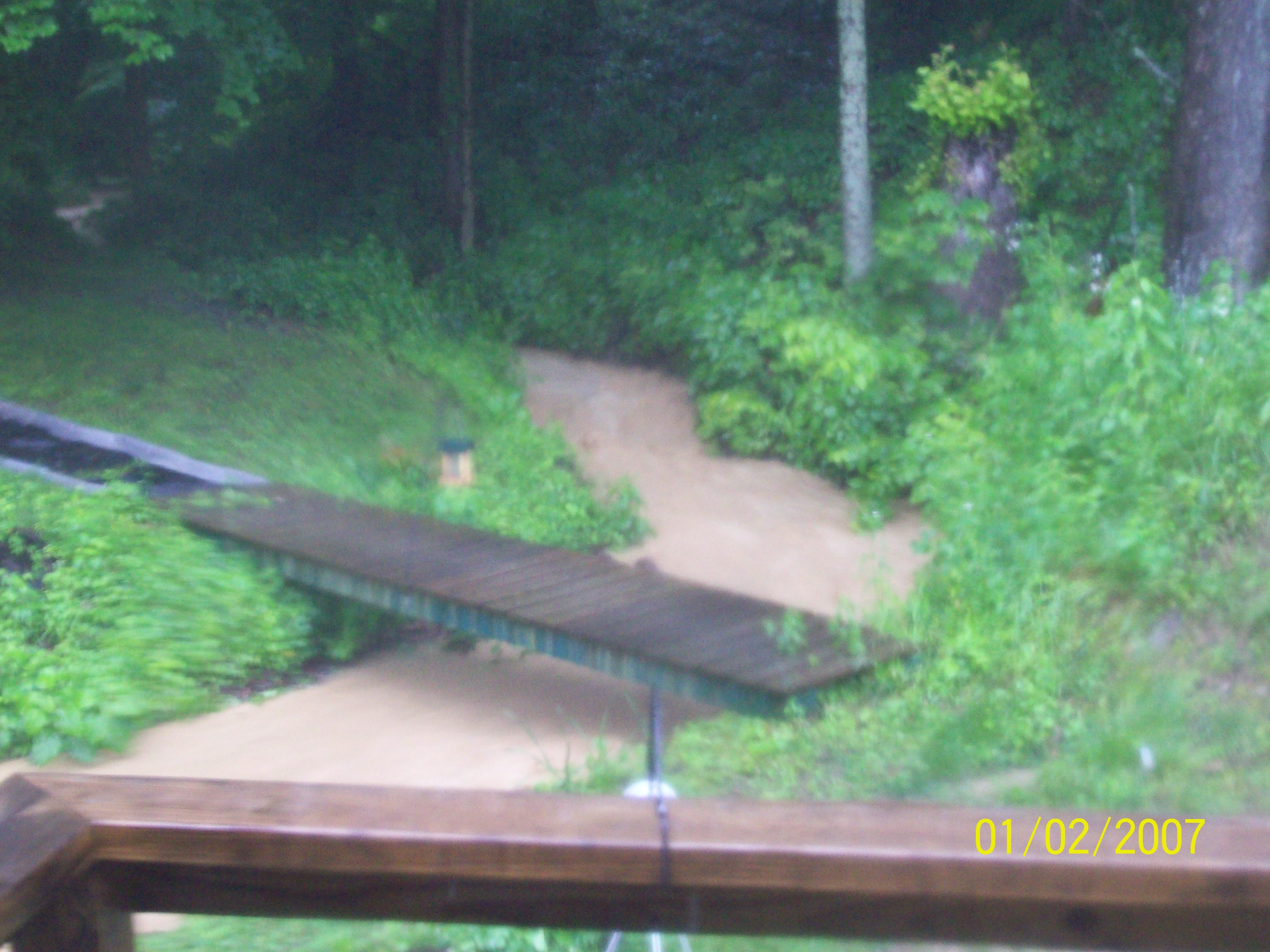

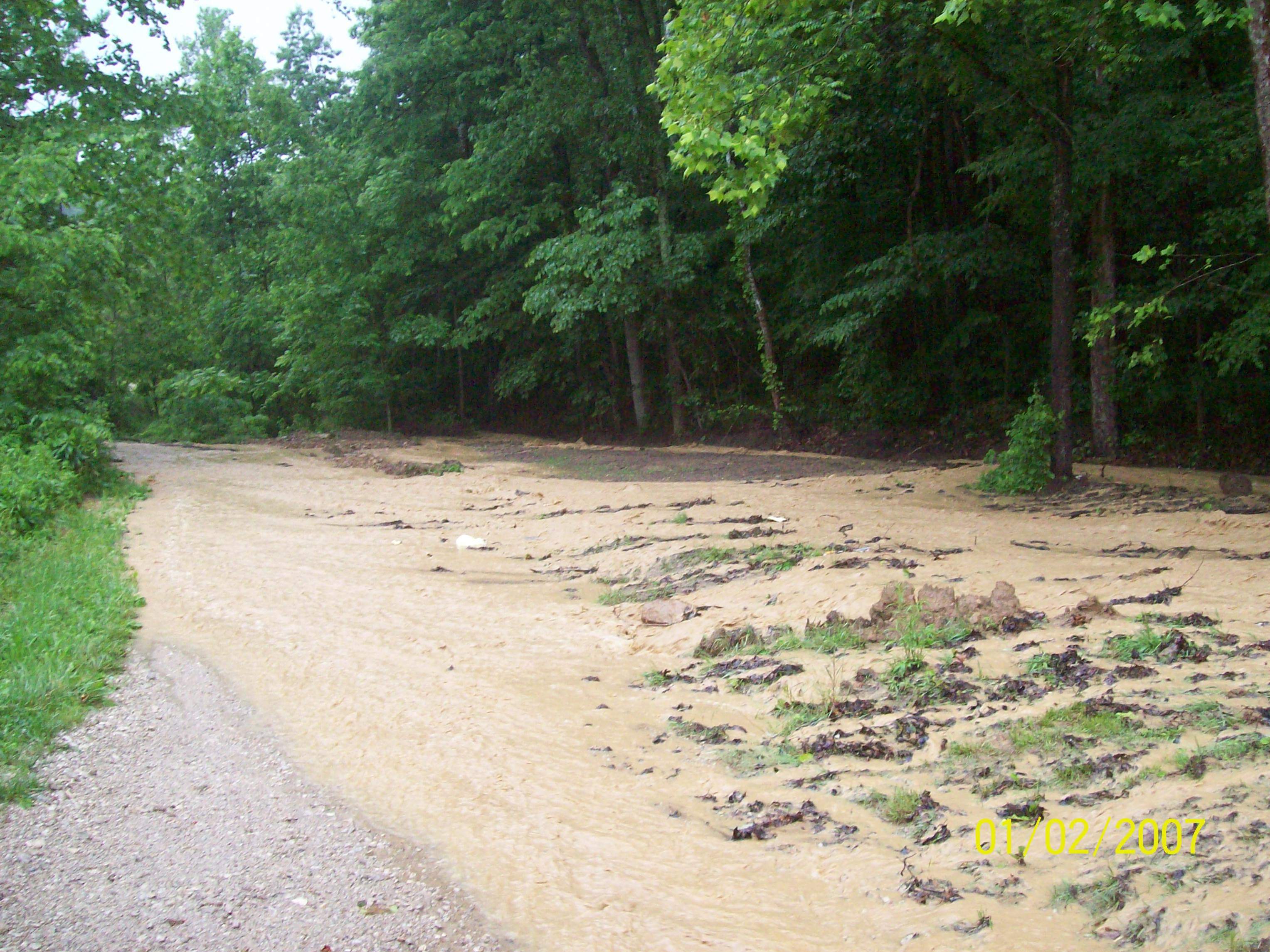

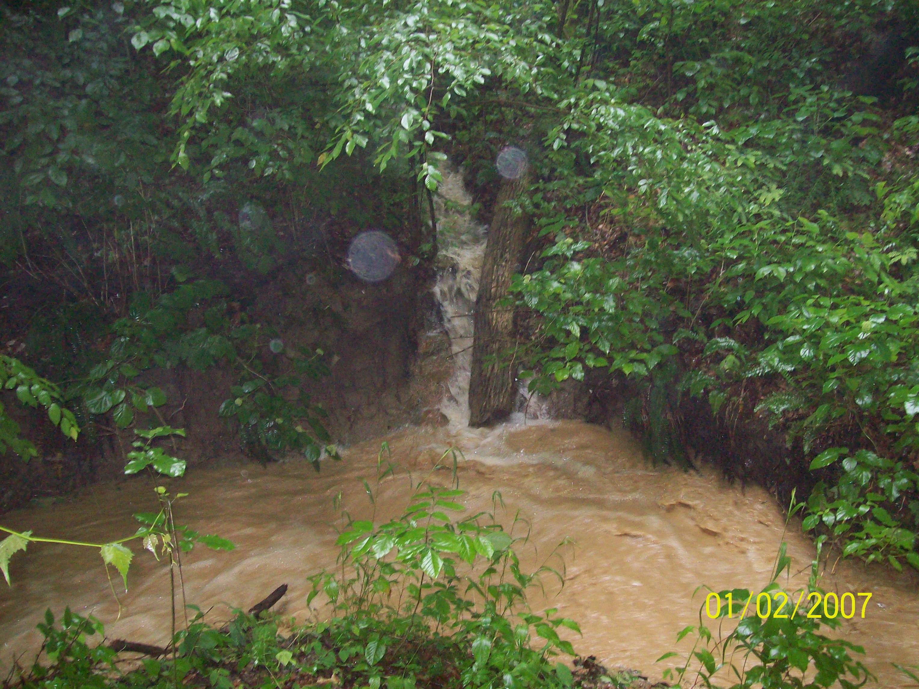

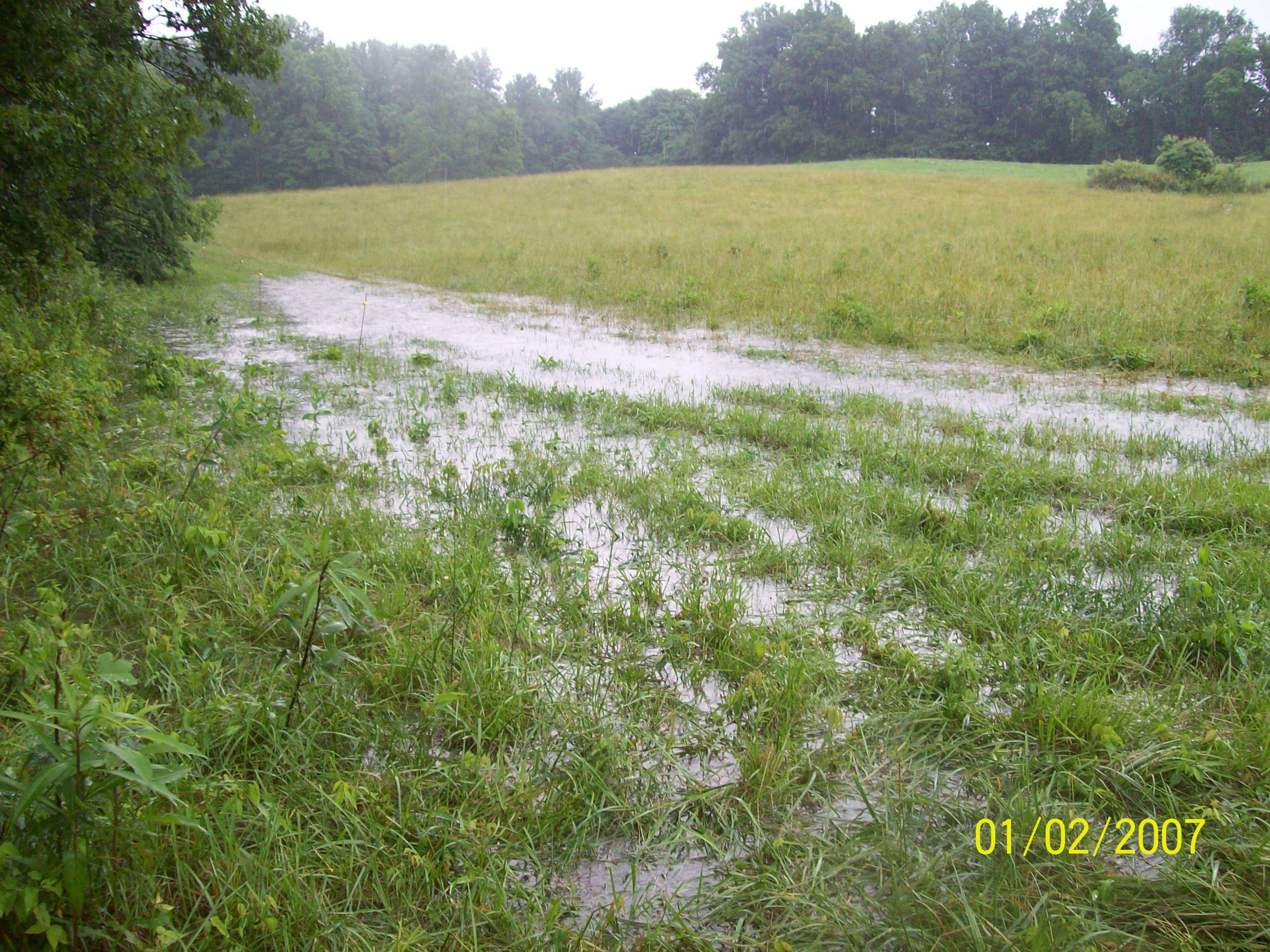

I'm having problems with a "dry branch" creek that goes through my back yard. We got quite a bit of rain today and the small creek was gushing with water, it does this a few times a year during heavy rains. It washes ditches out of my yard, washes the gravel off the driveway and floods everything with all kinds of debrie..... Today I walked the ravine all the way to where it starts. I found that it basically starts out in a low spot in a feild then grows and grows from many smaller runoff ditches feeding into it as it gets closer to my place. The whole thing is basically in a large ravine until right before my back yard so this will make it almost impossibleto use heavy equiptment.......I've included some pics form where it wreaks havoc:eek: to where it starts

Any ideas on how to control the water/slow it down? I'm wondering about putting a restriction in the waterflow upstream of my back yard. My concern with this is the water might just wash out around the said restriction.........What can I do to slow the water down? I have a dk40 with fel and a box blade to work the accessible areas and a long handled shovel for the rest :)......TIA

This might be oversimplification but if you can't dig the existing channel deeper, you can build up the banks to create the same effect. I'd line with riprap to keep soil from being continually eroded. Keep a wide shallow "V" profile so as the creek gets higher there's ever more cross-sectional area.

The rip rap will act to slow down the flow and allow the water to disperse more underground. The more rock you have in the low spots, the better it will disperse. It should act like a french drain --- the water will follow the path of least resistance through the rock and not wash out the soil on either side. I would dig out the channel and fill it with rock as much as possible to encourage that dispersion and stop erosion. Dams are going to end up as debris on your lawn sooner or later:(
