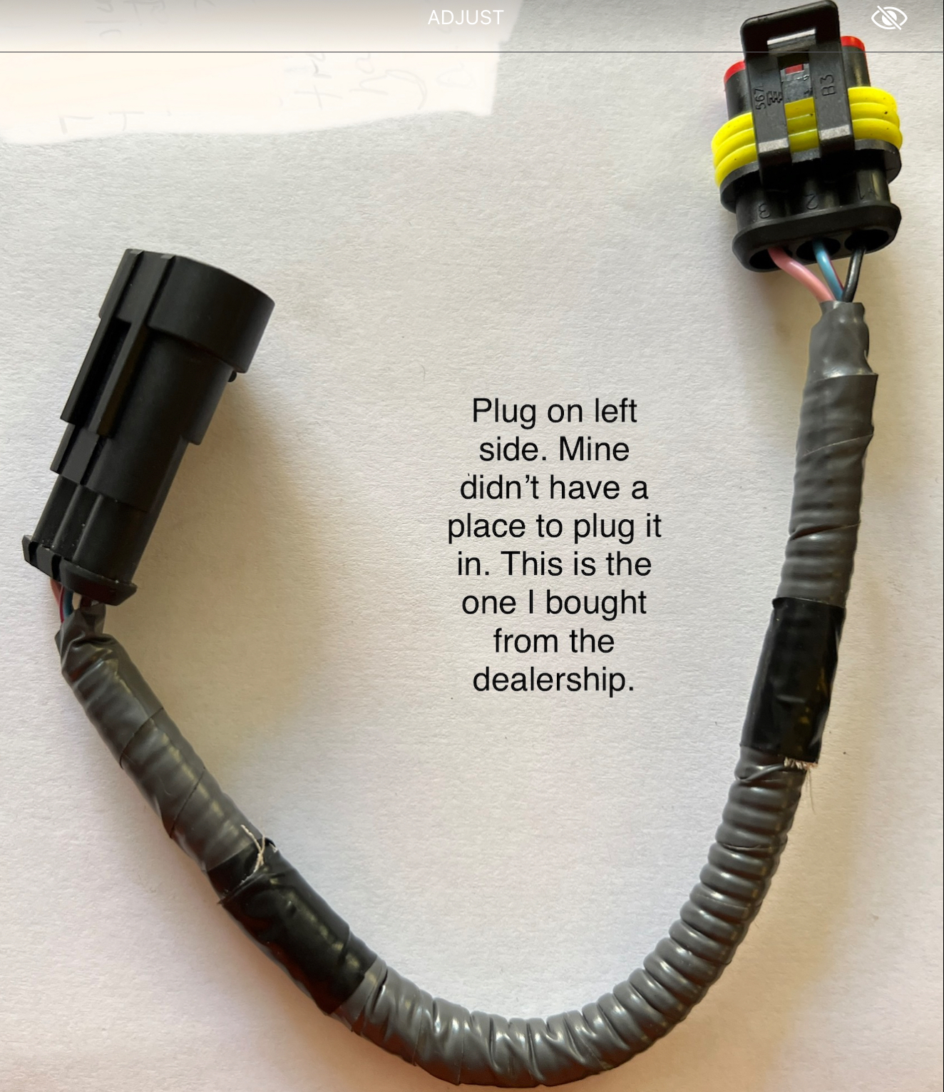

Well Ace, I am puzzled on two planes: 1. why do you keep quoting my post and basically giving me the same answer 5 times?
2. When you say "they replaced the plug", what plug do you make reference to?

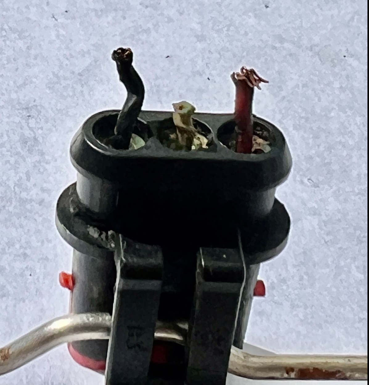

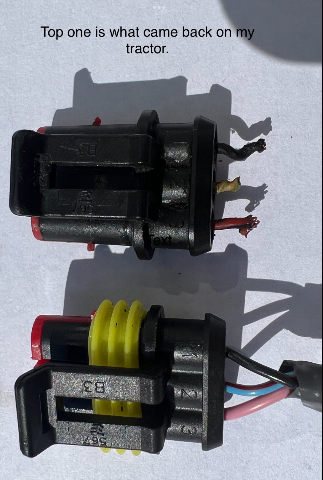

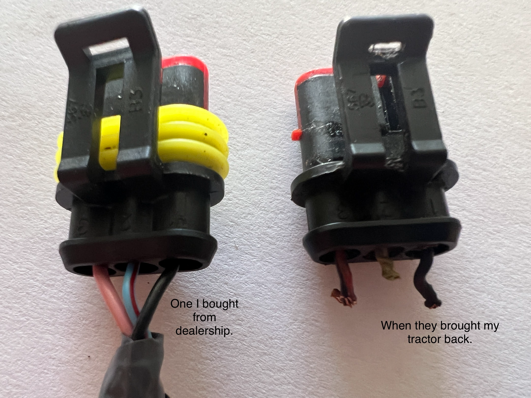

After re-reading some of your posts, I now get the idea that the "plug" was an electrical terminal connector going to one of your sensors.
It sounds that someone botched this up horribly.
Just for your info and what you can say to anyone if you confront this type of treatment again relating to electrical is "did you back probe the connector" meaning placing a probe at the back of the connector to make sure there is an electrical transmittance in the wire attached to the "plug". This test is done upstream or before the connector and tell-tales if the connector itself is the culprit if the wire is getting juice.
Thank you! I can show this to my friend that just bought a Kubota and if this ever happens again, he can help me. Or I hope he can. He is an electrician.
Thank you again arrow. my guy friend that is an electrician can help me if that ever arises. They did botch it. And for it to come back serviced like it was, well it didn’t even look good. And it sure didn’t sound good. They have never brought it back in the shape it was in. And when the retired dealer said he had told me that if I had a good man, he could fix my tractor. He said that in front of new guys, salesman, and people waiting in line. I had a good man. But if he was still with me, he wouldn’t have known a thing about a tractor. I didn’t either until I moved back to the farm. My daddy and his friends handled everything. Here are the pictures that I took. It was just the plug to the water sensor. They must not have known how to splice the wire back together if they didn’t have the right part or they didn’t know what to do and didn’t want to get in trouble. I don’t know but it was a mess. They just barely attached the wires to the sensor and sent it back. Two months of them having my tractor just to be serviced. When my tractor was serviced before, it always came back great. Not this time with new personnel. But when they came back to get it, they took it to the shop and it was back just like new(I hope) in two days. I hope you are having a great day. I have dealt with the public. It is a challenge some days.
You're welcome....jeez. This looks like a torturer from the middle ages worked on this.
I said this in a previous post but, the information you provided leads me to believe that the unskilled workers claiming to be mechanics were not, this proves it.
