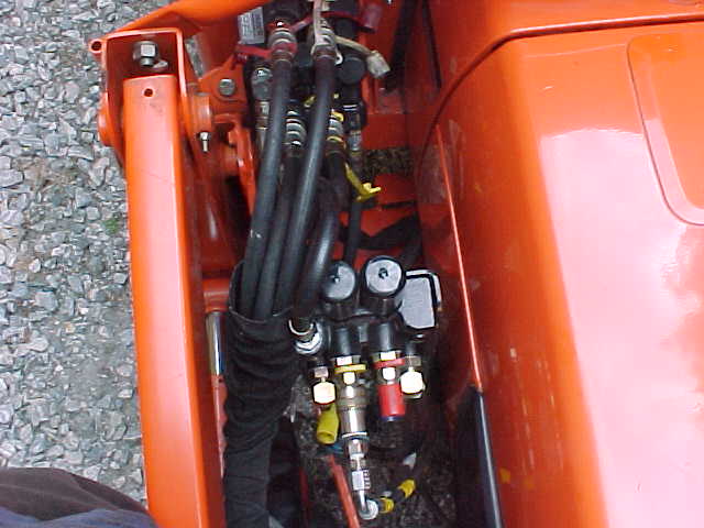

A little back ground, tractor is a B2910 with a LA402 loader. I have been frustrated for years at having to remove the loader hoses to use the front mount snow blower and angling grader blade. I would like to be able to use the loader and use the other implements without disabling the loader.
I have acquired a complete loader valve, joystick and hoses for the LA403 loader.
My first question is, can I T-off the main feed which comes from the case to my original valve (photo A) and hook up the main feed of the second valve (photo B) to it?
Second, can I route the returns for the second valve to the "option" (photo C) which are the parts for the rear remote option on my tractor?
And finally if this can be done, will it affect the performance of the hydraulic system? I will not be using any two implements at the same time. It would be nice to be able to pick up a load of gravel and grade it out without having to take of the blade.
Any suggestions would be gratefully appreciated.
I don't think you can do that.
You need to feed the second valve from the first valve via power a beyond port. I'm pretty sure you have an open system, so if you "T" the pressure side, when you use one of the valves, the hydraulic fluid will just flow through the open center of the other valve. It will find the path of least resistance. The valves need to be hooked up in series ... one after the other.
You can however, "T" the returns from the 2 valves back to wherever they go.
/ Need help plumbing 2nd loader valve. #3
You definitely can not "T" high pressure hydraulic lines. All valves must be in series. Performance of your hydraulics will remain unaffected.
Do a search for "power beyond" for hours of reading on this subject.

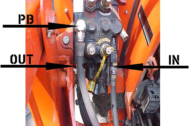

Photo A is my current valve, IN comes from the hydraulic block along with the PB (this is "power beyond"?) and the out returns to the case.

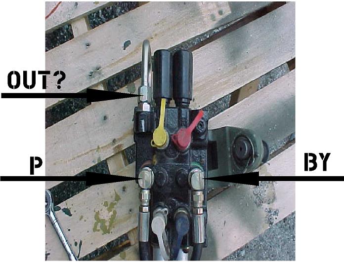

Photo B is the new valve, what are the letter designations P and BY? One must be IN and one power beyond and it looks like the one on the top returns to the case?
To plumb the new valve I would T the PB port (photo A) with which the P or the BY hoses (photo B)? And the OUT? would go back to the case with another T?
Or, am I missing something!

On your first valve, where does the power beyond go to now? To the 3pt valve? If that's the case, then you can put your new valve in between.
On your new 2nd valve, the "P" is where power goes in, "BY" is the power beyond port and "T" is return to tank or sump.
Here's what you can do once you find a suitable place for your 2nd valve.
1) Take the power beyond from your 1st valve and disconnect it from wherever it goes to now.
2) Connect it to the "P" power in on your second valve.
3) Get a hose and connect the PB (power beyond) from your 2nd valve to wherever your 1st valve power beyond USED to connect to.
4) Get a hose and connect the "T" or return to tank port from the 2nd valve to your tank. Or, you can "T" that one to a hose that's already going to tank or sump.
The Kubota guys might have another way to do it, but essentially adding your 2nd valve in series like that will work.

You asked: "On your first valve, where does the power beyond go to now?"

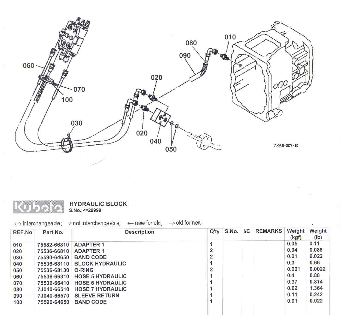

In my first post, if you look at the first photo, the PB hose connects to the hydraulic block (drawing #040).
I lucked out when I got this set up, it came with the mounting bracket, which matches 2 of the frame mounting holes for my FEL, and ALL the hoses and joy stick.
So if I'm reading your post right, I will:
1. disconnect the PB hose from original valve
2. connect the P hose from new valve to the original PB port
3. connect "old" PB hose to the new valve PB port and
4. connect the new valves T(ank) hose to a "T" on the old valves T or OUT line.
Correct me if I'm wrong!
Thanks for taking the time to help me out.
Rick

I can send the schematic tommorow if you still need it, but you seem to have the circuit figured properly:
(P) from the tractor block remains attached to the loader valve.
(BY) or (PB) Power Beyond from loader valve to (P) or (IN) of second valve.
(BY) or (PB) Power Beyond of second valve back to the tractor block where the original Power Beyond Connected.
Tee the (R) or (Out) low pressure return to the original loader valve return.

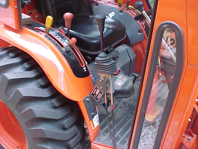

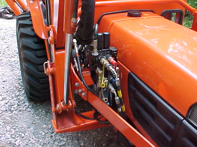

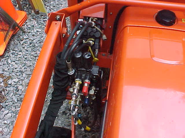

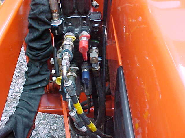

The loader valve is finally installed. Sorry for the delay, got involved with another project that took precedence.
I would like to thank you all for the great help! It went smooth as silk after you guys set me straight.
I can now use my grader blade and snow blower without disconnecting the loader, a real PITA. Hardest part was filling the hole on the loader bracket and redrilling so it would match up with holes on the frame.
Again, THANKS!!
Rick

Wow Rick,
That is an extremely clean install you ended up with. It looks great!
I'm very glad you got it all done. So have you tried all the functions out and does everything work alright?
