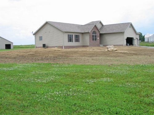

#22
First picture, I left some of the grass in the middle that "survived" the first pass.

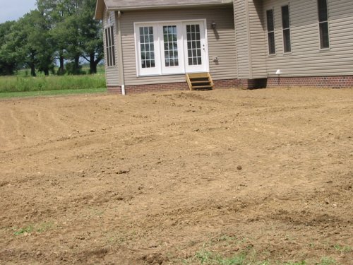

#23
Ruts were down grade from the side of the house where existing grass meets dirt. Rake did very well preparing this area.

   / Need Help with Harley Rake!!!! #25
John,
Nice work and thanks for posting all the pictures! The tractor really seems to fit you well. (note: at the first local TBN lunch my neck start hurt from looking up at everyone when we were talking outside in the parking lot...I'm 5'10" ...started to see what my wife must feel like at about 5' in elevation... /forums/images/graemlins/crazy.gif)
Did you happen to get any close-up shots of the rake in action, possibly showing the working area/dirt flow or whatever you call it?
Just thought I'd ask...if you are like me I already know the answer... /forums/images/graemlins/shocked.gif
I sure could have used one of those rakes a couple weeks ago!
By the way, I love the rainbow picture... /forums/images/graemlins/smile.gif

   / Need Help with Harley Rake!!!! #27
Thanks for the shots - and the brief education you and all the posters have given me. I'll be doing the same thing soon and I'm renting the same tool. I think I can go into it a bit better educated now.
BTW - Gorgeous house - I do love Ranches! /forums/images/graemlins/grin.gif
