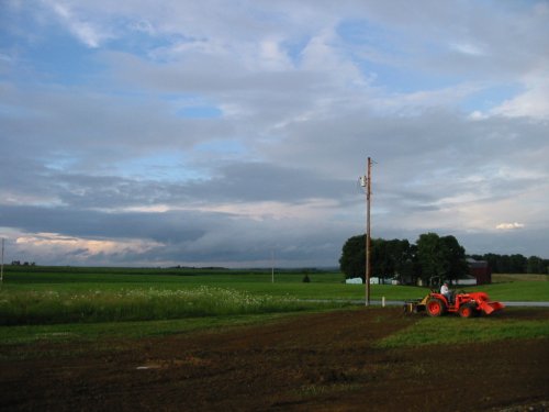

First picture, I left some of the grass in the middle that "survived" the first pass.

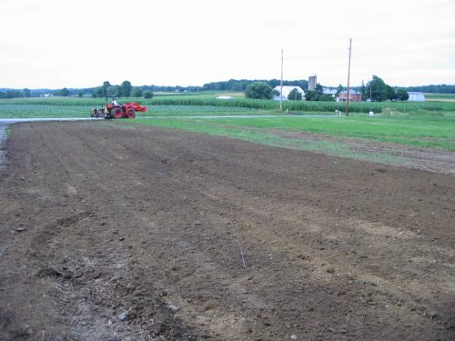

Ruts were down grade from the side of the house where existing grass meets dirt. Rake did very well preparing this area.
