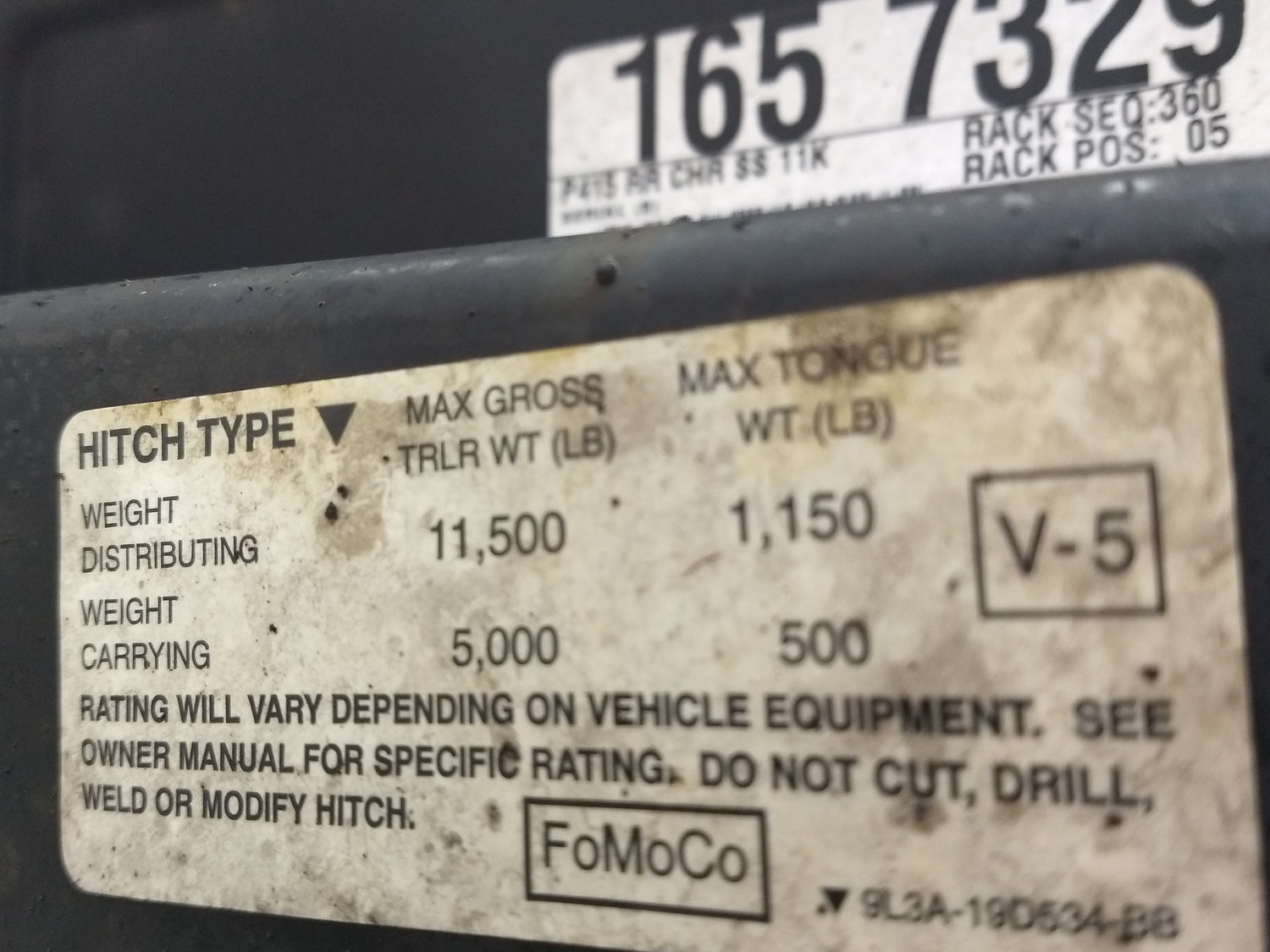

How sure are you your 1500 Ram has a class V hitch? I ask because I had a Ram with a sticker that had a V on it but it turned out it meant something other than a class V hitch. Post up a pic of the sticker and unless you installed it it’s most likely not a class V.

This is a picture that might lead you to believe it’s a class V hitch. I don’t know what the V-5 means but not class V.
The last Chevy 3/4 ton I had appeared you didn’t need a WD hitch for something up to about 11,500 pounds, at least that’s what the hitch sticker said. I didn’t read the manual close enough to see if it said other wise.

Google search says this:
"The V-5 rating just means that it was manufactured to North American standards and relates in no way to the hitch capacity."
"I found at this web site: 4reese.com , they say that the V-5 rating is simply referring to the quality of steel used in the production of the hitch, not the weight rating."
Looks like the V-5 may be related to the metal used not the rating. And from further research it appears that a true class V uses a 2-1/2 ball receiver whereas the class IV is 2 inch. So it appears that our Rams have class IV hitches. And some of the larger pickup trucks have the class V because of the 2-1/2 receiver.

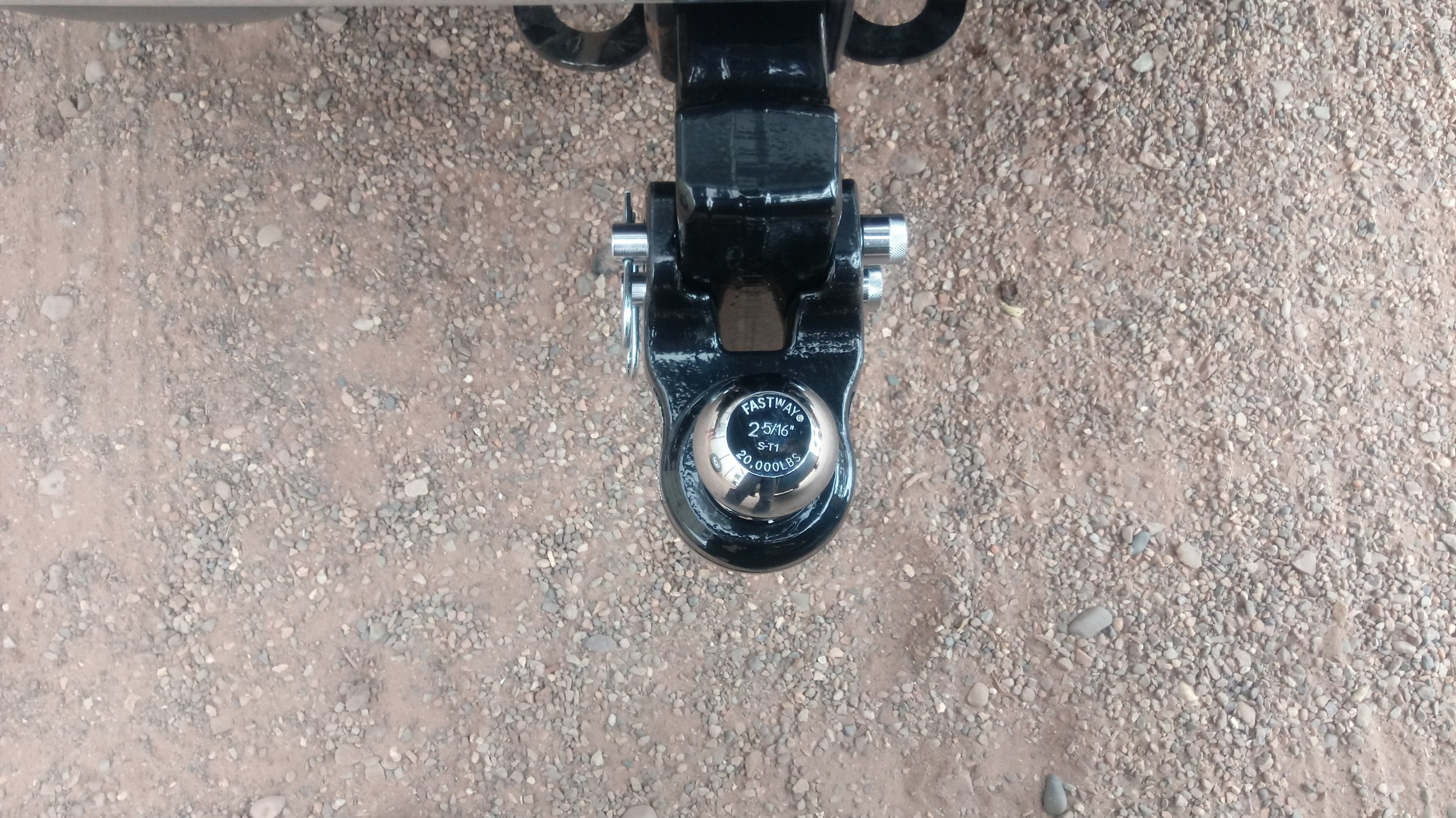

I have a ball mount that was rated for a class V. It was solid steel instead of hollow.
   / Need help with purchase of weight distribution hitch #58
Same here. My solid ball hitch with 2-5/16 ball has a 17K rating.

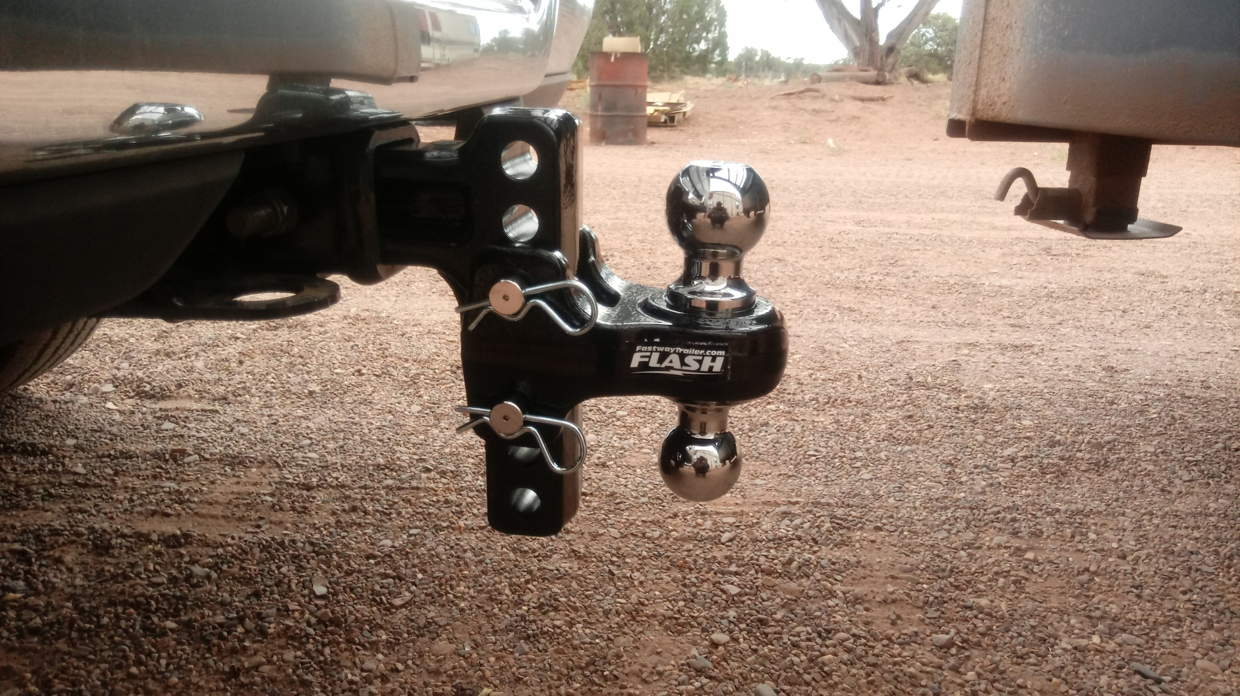

@nisaacs The hitch in the link is the one that I use. I can't see the ball rating right now since it is connected to the trailer as of yet. Mine came with the ball attached to the hitch as a package and was supposed to be torqued at purchase. First time I connected it to truck I checked and it wasn't the required 450 ft/lb
