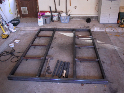

I have used the PowerMIG 215 to weld up the bed frame for a 2 ton dump wagon I am building (see attached pic), welding 3" x 2" rectangular tube with wall thicknesses from .25" to .1875", plus some other fab work on various pieces of equimpment (leaf vac, new stand for my Harbor Freight bandsaw, brackets for my pallet forks, etc.), thickest being .375 barstock. The thinnest I've (sucessfully) welded with it is 16 gauge hot roll sheet that I used to make a boot for my mower deck for a leaf vacuum. Tried thinner but no joy (no doubt my fault) Ran a lot of bead on the dump bed frame and never had the unit exceed the duty cycle.
I have another project coming up with some thick stuff - 3/4" steel for the main wedge and a slip-on 4-way wedge for a logsplitter I am building. It will be interesting to see how it performs on that - it will have to be done in multiple passes because of the thickness.
