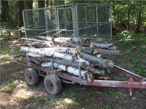

I used a old 4 place snowmobile trailer. Just narrowed and shortened it, then added upright tubes. The equalizing dual wheel works great for off road use. A ratchet strap works to keep logs from falling off.

Jeff, that looks very useful. Do you load it with a second tractor loader, or by hand, or unhitch/load/rehitch? I agree about the walking beam axles - best in the woods. What kind of hitch do you use?

Jim,
I built the trailer to use with my ATV. I do load by hand and unload with my tractor using forks. The logs are fire wood left from my food plot openings. Brush piles are in various places. The logs are about 8-10 ft long 5-12 inches in diameter. About 15-20 per load and between 50 to 80 lbs each. Total load 1000-1500 lbs per trip. I load in the center over the tires with no tongue weight. This is about 1/2 the capacity of the axles.
I do not know what kind of equalizing suspension is on this trailer, it was on the snowmobile trailer. There is a pivoting bar with a center pin that the front and back leaf springs attach to. When traveling through the forest, one tire can drop in a hole and the other will carry the load. It is amazing how well this works. I did not plan this design, it is just what was on the trailer. But when I build another one I will use this design.
