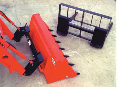

Kubota makes a QA for their loaders, but mine is a ATI and it's a good solid unit. ATI Corporation - Tach-All(tm) Quick Attach not sure what it costs but I've called ATI and asked about the prices on some of their products and they let me know how much and where to get them.

With as much time as I have been spending on here it seem like I'd have come across the ATI link before. I like the looks of the grapple attachment they have. Now my decision is between just putting the grapple attachment on the existing bucket, or adding the qick-tach and a grapple bucket.
