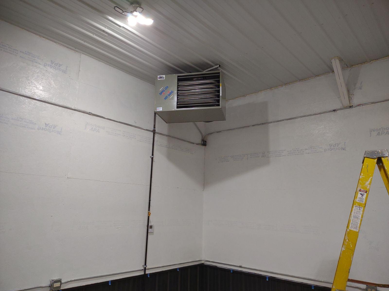

After I retired I started working for a local HVAC contractor. We have radiant tube heaters in the main shop (60x100') and it works great! I have a propane forced air unit in my 30x40' shop and I have been thinking hard about adding a radiant tube heater to my shop.
I also know his heating costs are exceptionally low and we work all winter in tee shirts comfortably.

A propane forced air heater sounds like it might work for my 42x60 and 14 ft high building. Can you tell me more about this one? Any idea what it costs?
