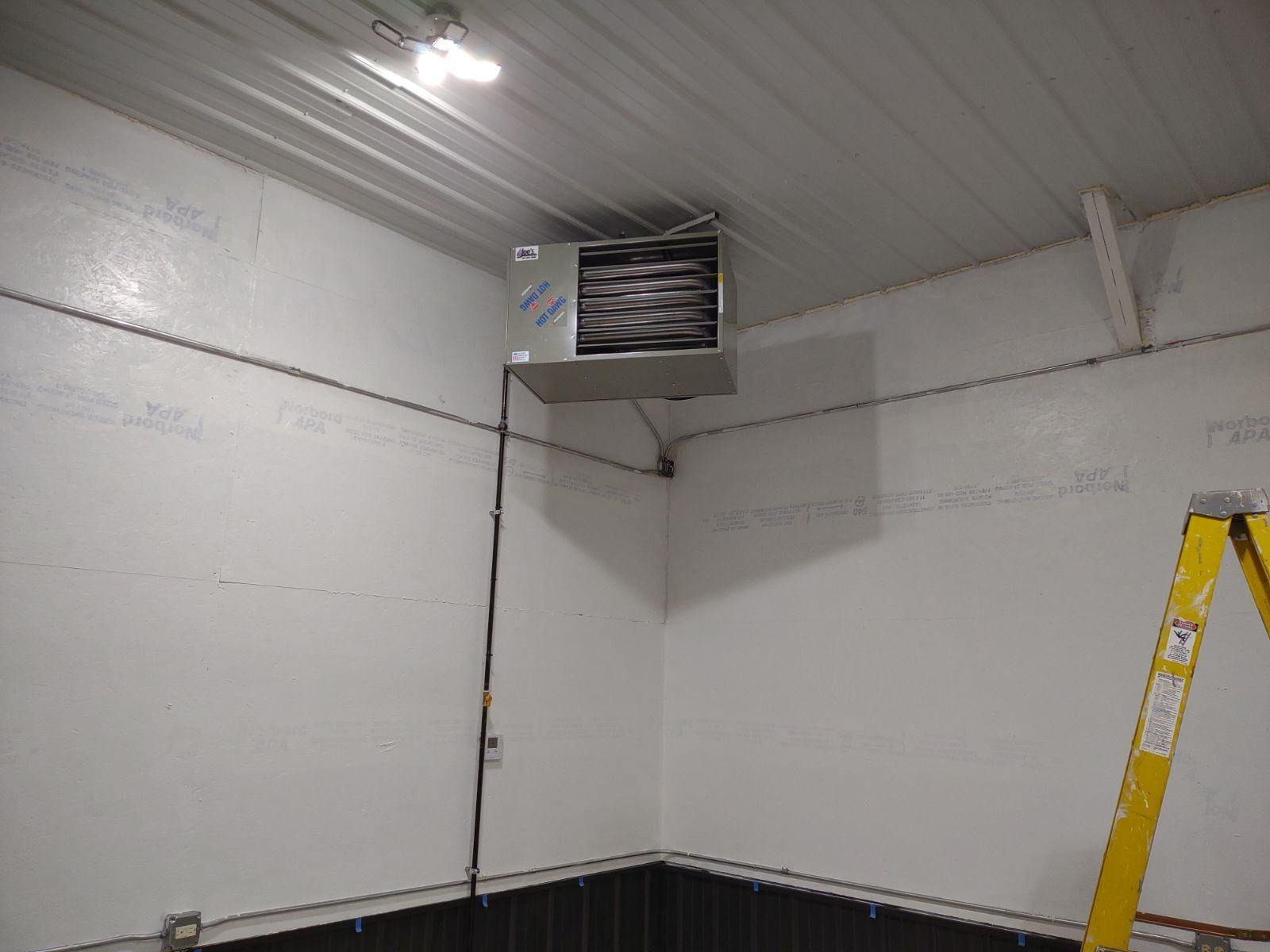

This is what I have in mine, they come in different sizes, they need a small vent, about like a water heater had, run on 110 volts and usually sit up high in the corner.

Yes it would. In my post earlier I said a ceiling fan or two would help. I had mine installed by an HVAC place and they sized it, 60,000 btu’s. It’s oversized for my 28’x30’ shop but I think he said it was only $20 more for this one. I keep mine between 40 and 45 degrees in the winter and it warms it up to 60 degrees in less than 15 minutes.
The good thing about one of those corner units, probably the cheapest option. I’m not sure how big of one you’d need. One like mine cost about $500 now, you might need one that cost around $1000.
