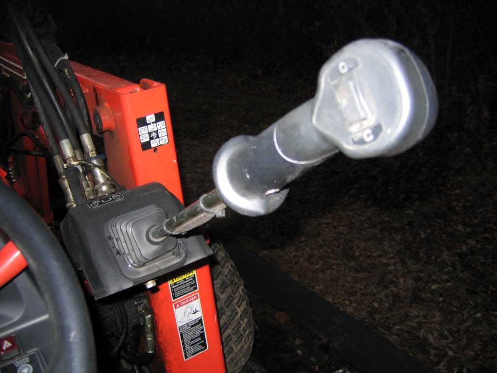

</font><font color="blueclass=small">( If you look at the picture that I call picture #2 you can see the two buttons on the front side of the FEL handle. The top button closes the grapple and the bottom button opens it. These are electric switches that control the electric diverter valve in picture #3. )</font>
Charles, I think what you have is a "SOLENOID VALVE" and not a "DIVERTER VALVE", they operate very differently.
That is a very nice setup though, Who makes the handle for the joystick? I am looking for one for my tractor...
   / Need remote advice on L5030 w Cab #13
Joe -
Here's a picture of the joystick loader control with the rocker switch that controls the solenoid. I'll spare you the pics of the plumbing and valve itself - too much like FL's to be much help. My solenoid is mounted in the exact same place - lower part of R/H loader support. I agree with Kenny, I think FL's setup is the same solenoid type as mine, an improvement over the diverter valve approach. I think the rocker switch might be even a little more convenient than the buttons, but now I'm getting picky.
I can't find my paperwork from the install, but the loader handle/switch can't have been more than $100 or so, and I'd put the solenoid around $150-200. Hoses, fittings, labor extra of course.
And as much as I hesitate to be on the other side of the fence from a Nasa engineer, I find this setup indispensible. Bear in mind, I use mine almost daily in my business, and the task is always the same. As I said, I'm constantly using a loader function while simultaneously opening or closing the grapple, all without taking my right hand off the control. But can I build a space shuttle, or put a man on the moon? No. Not even close. I do plan to install my own steering wheel spinner though. /forums/images/graemlins/laugh.gif
Good luck as you "grapple" with this decision, John D.

kennyd, you are correct. I should not have called it a diverter valve. I have beed working on specs. on service trucks at work and they use several diverter valves, I guess it's stuck in my mind.
The handle is made by "Speedy Loader"
