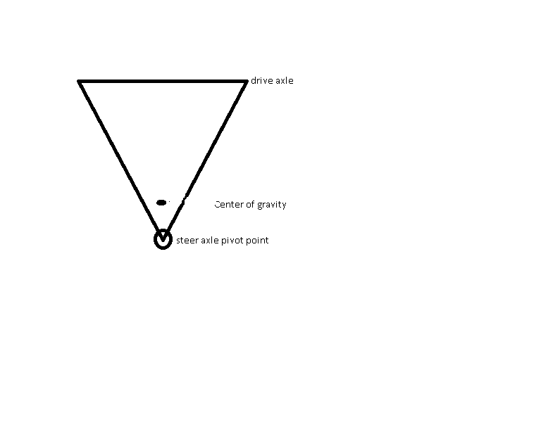

Wear you seatbealt at all time and be mindfull of the center of gravity of the lift. When a forklift is unloaded it is in the most unstable condition. The front tires and rear pivot point dictate the area that the center of gravity should stay in. If the center of gravity moves outside of this triangle, you will have a tip over. Notice how the center of gravity is in the very narrow part of the triangle. When you make a turn the center of gravity will shift to the side that the front of the steer tire is facing. When you have a load on the forks the center of gravity moves toward the dive axle where the triangle is wider, that is why it is more dangerous to make turns with a unloaded lift. This triangle also extends vertically, since the center of gravity is above the horizontal plane of the pivot point, this causes the triangular area to become smaller as it extends upward. That is why you should never make turns on non flat areas, if you do need to turn remember to turn in the downhill direction.
