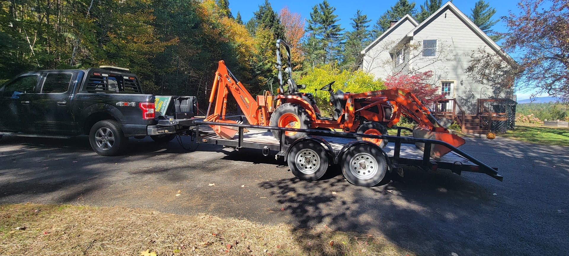

I would go with the first picture where it’s backed on because the tractor is all the way on the trailer that way. You’ll probably end up hitting the bucket in a sharp turn loaded the other 2 ways.

/ Trailer Weight Distribution #26
I have never towed this tractor on this trailer.
I measured from ground level to the top of the rear wheel well and got 39" with the unloaded trailer attached.
With the tractor backed onto on the trailer the measurement is 38".
What I suggest you do is unhitch the trailer. Measure the truck unloaded no trailer. Then stand on the bumper and measure again. Lets say you weigh 200# and the bumper lowered 1". Now we have a good ballpark as to how much the hitch is carrying per inch the bumper drops. Ain't perfect "but that's life."
Also might require a bit of math. Sorry for using the 4 letter word, m a t h.
You have a good idea of how much the tractor weighs so look to put a bit over 5% and no more than 10% of it's weight on the truck. The trailer is already balanced that way unloaded so you don't add the trailer weight.

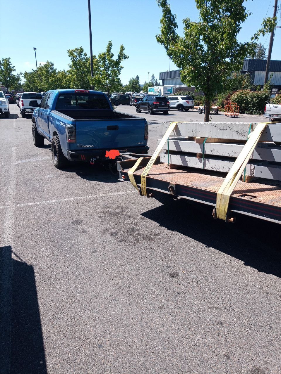

True, although I think I've seen more newbies with the tongue way too low (usually due to way too much tongue weight) than too high. Here's a picture of one I saw in the Home Depot parking lot. He's definitely got the tongue low, that's for sure.

1 or 2 looks good to me. I go by ''feel'' when I drive my tractor to a trailer (or any heavy object for that matter) I look at the rear end of my truck, when the tractor is at the rear end of the trailer the truck suspension is fully extended, as I move forward you can see when the truck get to the neutral position or you can tell that the tractor is balance on the trailer, then I keep moving forward to guesstimate to have 10% of the weight pass the balance point, essentially you want 60% of the weight in the front and 40% in the back to have sufficient tongue weight, you will see the truck starting to squat, I want to be around there some truck squats more then other I have a dodge/ram so I need keep creeping forward as it start squats further then other trucks to be where I am comfortable. I personally ratter a bit too much tongue weight then not enough.

True, although I think I've seen more newbies with the tongue way too low (usually due to way too much tongue weight) than too high. Here's a picture of one I saw in the Home Depot parking lot. He's definitely got the tongue low, that's for sure. View attachment 1511291:D
light 1/2 ton trucks, probably start with a level trailer unloaded, then loaded it up crushing the truck's rear suspension dropping the ball almost to the ground...
/ Trailer Weight Distribution #38
In that particular case, it was a 1/2 ton pickup, towing a 14-16000 lb trailer with those Perma Columns (the concrete posts you see in the picture) loaded all the way to the front. No idea why he didn't at least put them further back. Still would have been way overloaded, but at least it would have been a little easier on his suspension.
Yep, and as RjCorazza pointed out above, it's better to pick the correct ballmount (or adjust the trailer's coupler) to be level when loaded.
If nothing else it'll help avoid that overloaded look when the trailer is sloping forward.
