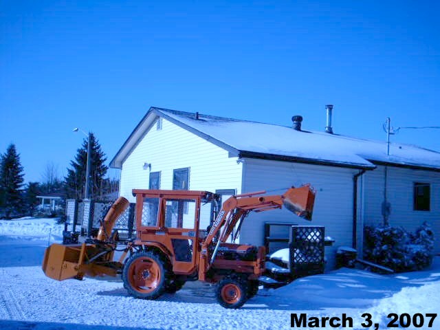

I love the Homemade heated cab idea, looks sharp, good job.

Jmarotz, Hey what kind of machine is that:confused: . That thing looks cool. I would love to see more pics of it.

The tractor is a Versite 276 Bi-directional rated at 100 pto hp. Can use 3 point on either end and by swiveling the seat and console you can face forward either direction. New Holland bought out the Versitle Bi-Directional line in about 1992 and is now called the TV 145.
The snow blower is John Deere but I can't remember the model number, it is 9 feet wide and about 4 feet to the top of the top auger.
By rasing the 3 point up about 4 feet and take a bit of the snow and backing up and lower the 3 point you could clear 8 foot difts with no problem.
I lived on a county road but their 6x6 rod grader with a V wedge could never make it though certain places on my road and would have to wait for me to open it up.
Someone mentioned getting a pull behind forward facing snowblower, all I can say is don't get one. In the past I demoed one for a 40 hp tractor and one for a 250 hp tractor, if the snow was wet a Kubota BX could move more than even the monster one because of packing the snow with the wheels ahead of the blower or just plugging the chute and augers.
Jeff
