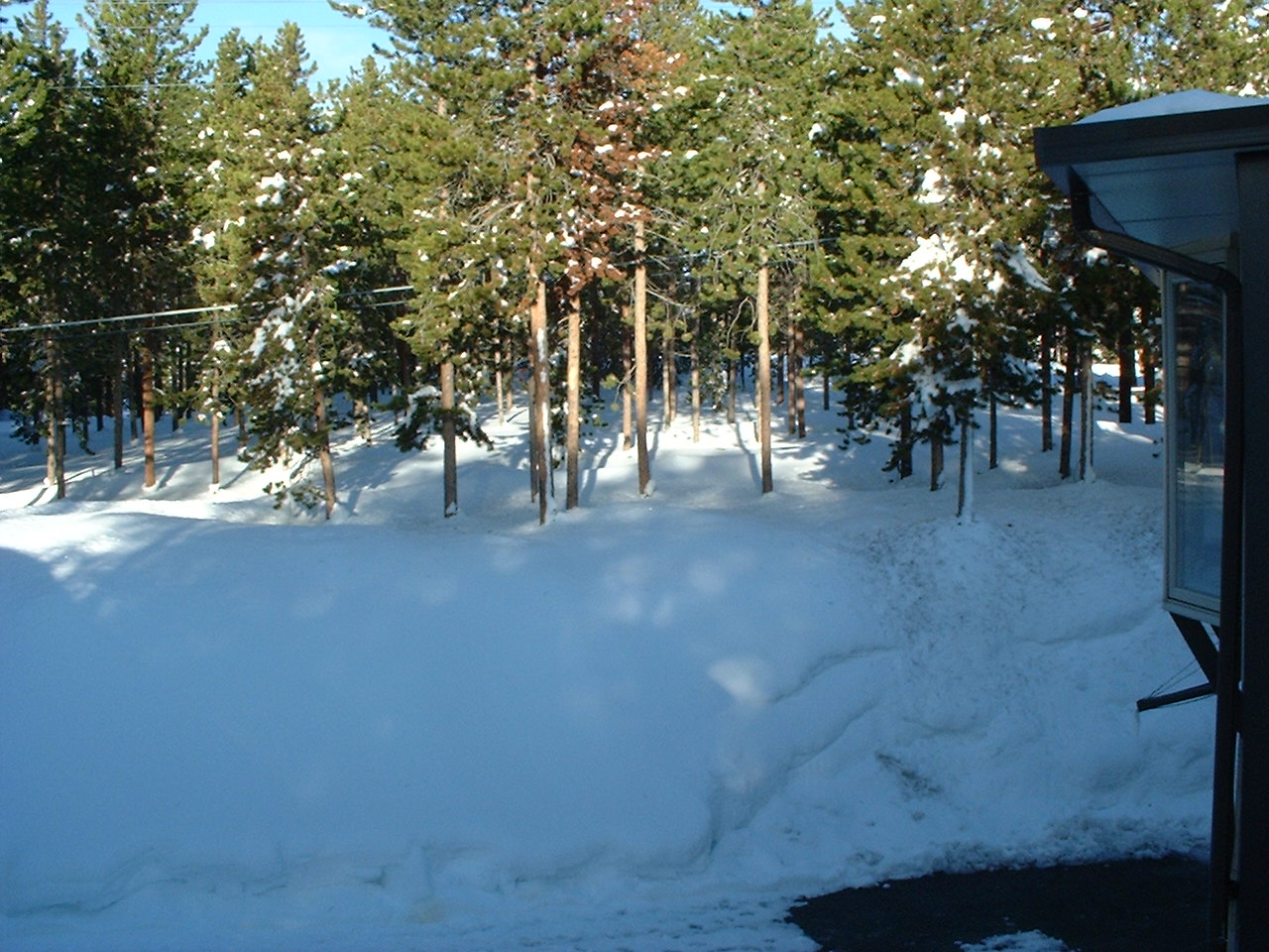

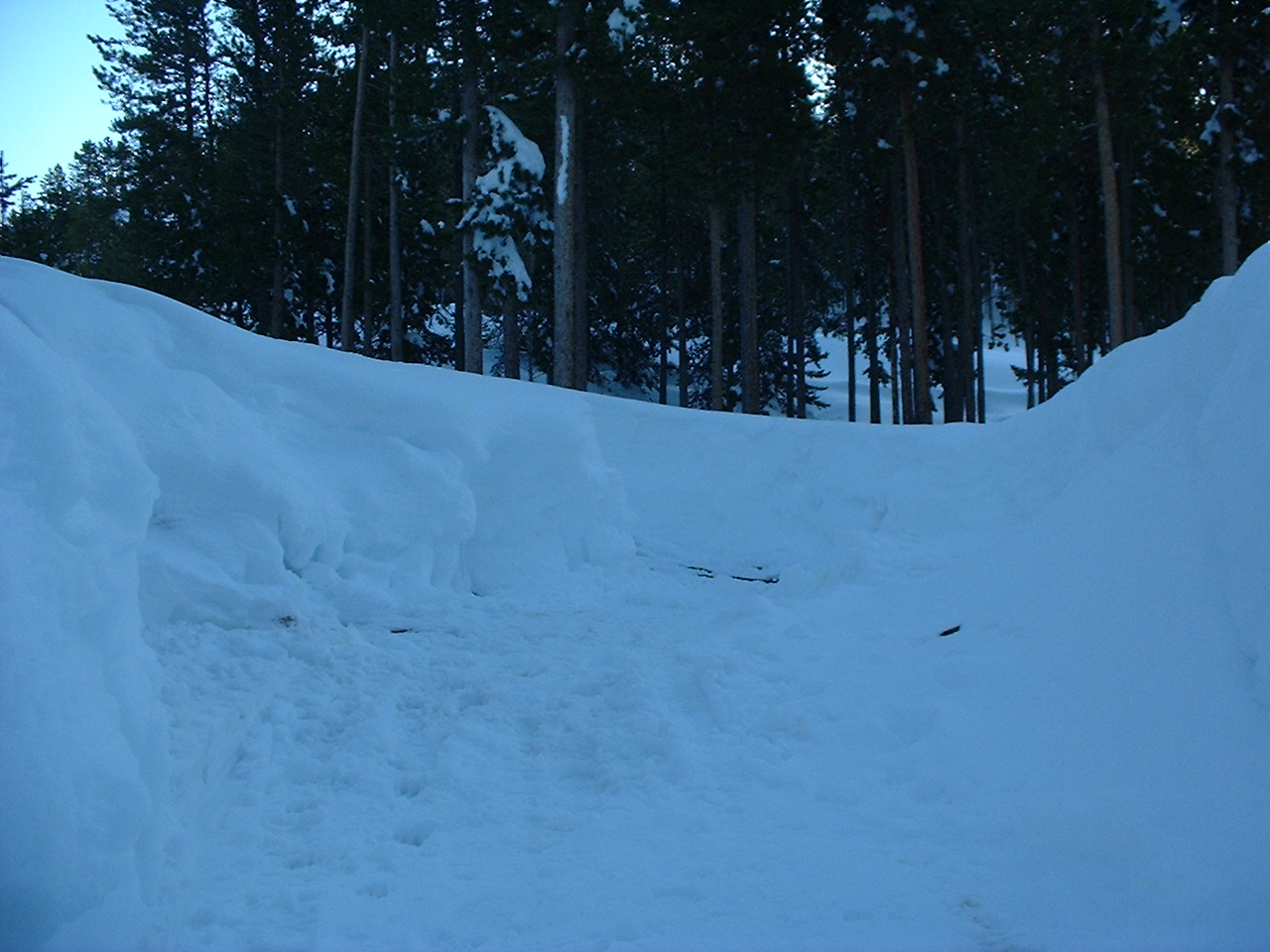

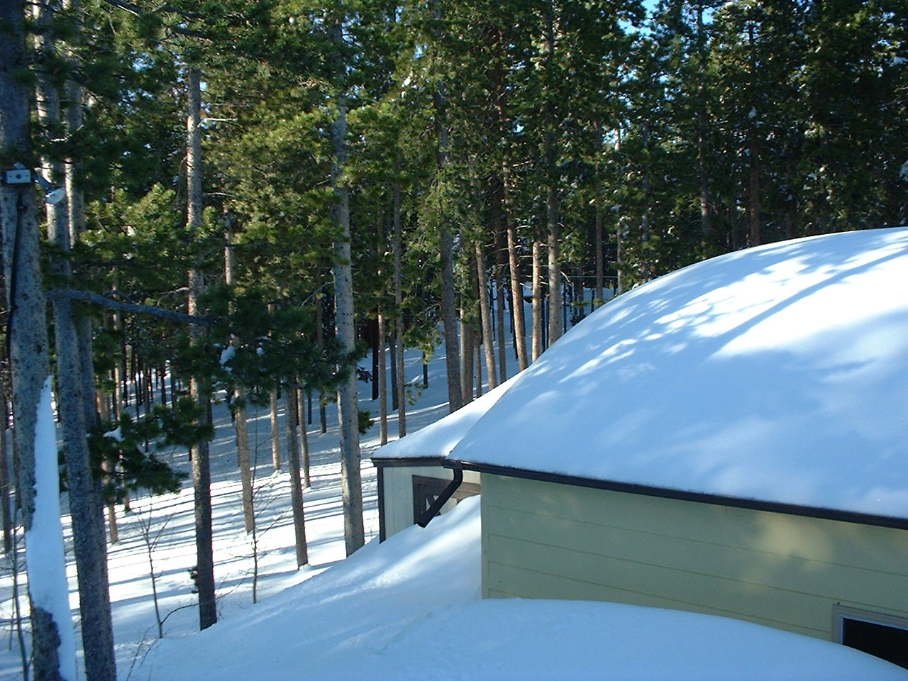

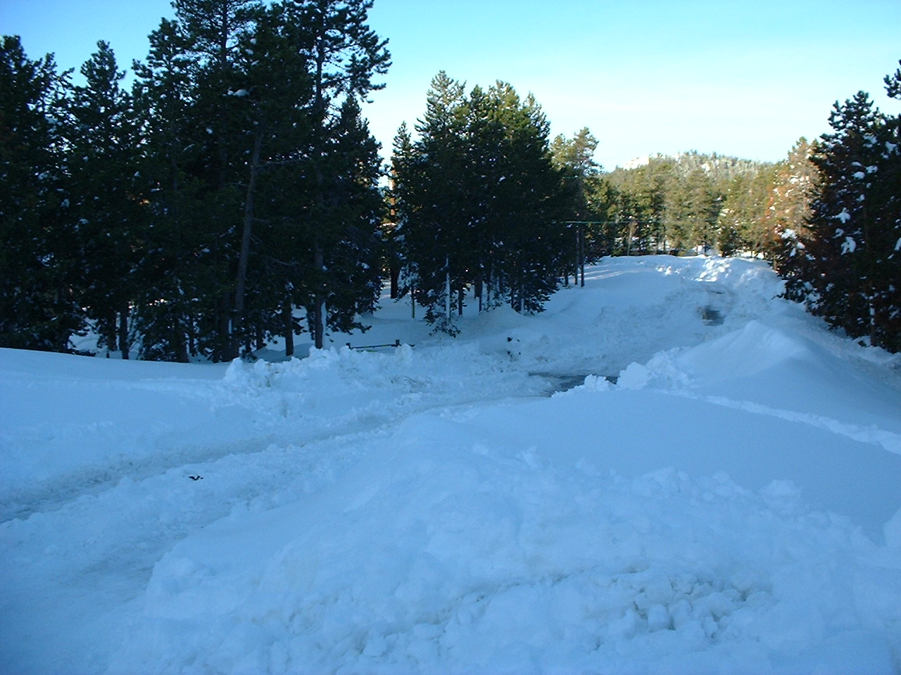

Reading alot about FEL vs Snowblowers, what do you think would
work for me??????????
I live @ 8200 ft in Colorado, get up slope conditions from Denver.
Need insite on how best to handle a big snow storm. Been reading
the board for about a month (just got ID to post) and see I
have much to learn, had trouble moving around, let alone making
this entry (thread - new lingo?). I get about 200-300 inches a snow
a season, June to September. Worn out a Honda 1132 & working on an
Ariens 1332 (13 hp-s) walkbehind, does the job, but getting older.
Just purchased a B7800 w/FEL and rear blade. Needed extra hp-s, at
this altitude you loose 20%-30% of your power. Look at these snow
pictures from one of our big storms in 2003. Will the loader push
this kind of snow? And pile it up high enough? This was spring,
March and heavy wet one, do you think tractor blower is high/big
enough to do 6-8 footers?
Some storms you can keep up with, others with 50mph or 60mph winds
you just can't (with my current blower). Have F250 4x4 with 7 1/2'
snow plow, becomes useless after so many feet. County's 6-wheel drive
graders, all-wheel chained with plow on front can only make 1 path
before frontend is just pushed back into main opening. They use
hugh frontend loaders that you can walk in their buckets to widen
after. Have 2 driveways about 200ft each.
This sound like upper NY state or South Bend, Ind with lake effect
snow. Rocky Mountain's trail ridge road already closed for the winter
10/20. It's about 60 miles north of me by the divide.

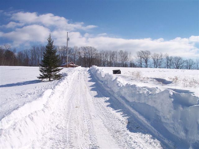

Thats some nice lookin snow youve got there ! ;) IMHO with that type of snowfall I would go with a snowblower mounted on your tractor. Infortunately most units hook up to the 3PT hitch so operating in reverse, but many guys on here do it no problem ! If I had the money to go that route I would, except I think I would like to have it mounted on the front of the tractor ! We have been plowing here but the snowblower is nice getting the snow out in the fields if you can ! :) Here is a shot of my drive last winter.

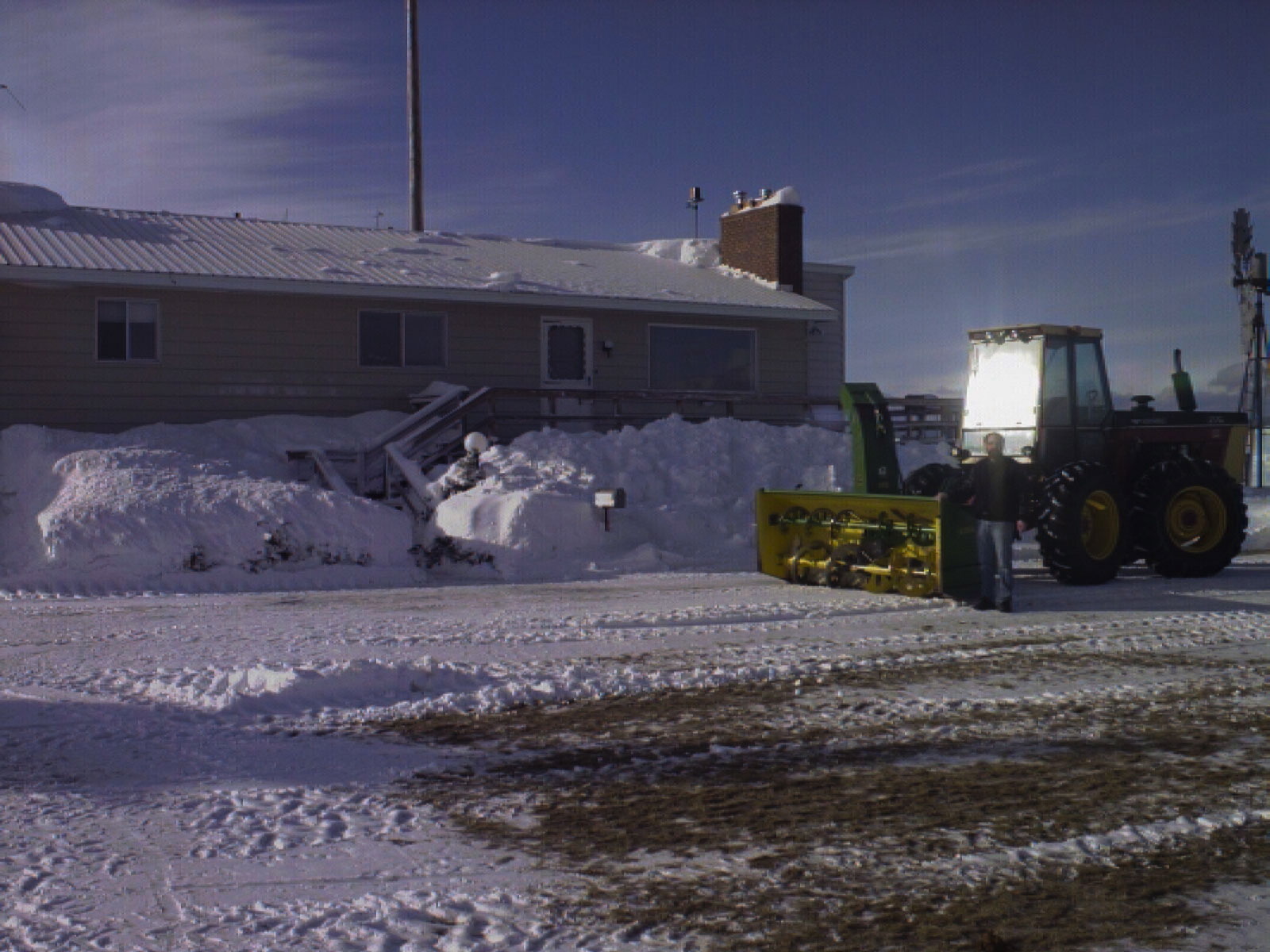

Get the snowblower it's the only way to move alot of snow.

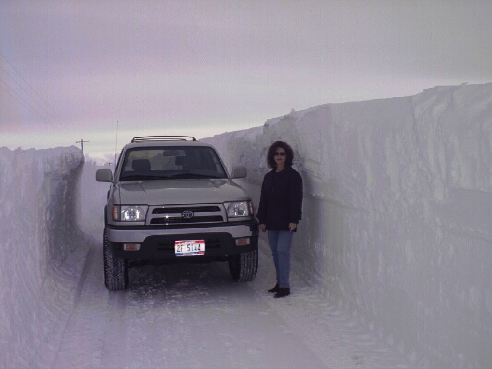

Attached are some pictures of my wife after one blizzard and my snowblower. Lived about 10 miles from Yellowstone Park a town called Ashton, Idaho, my son lives there now.

Yes, your pics do look like the snow we get here in the snow belt of upstate NY. I'd get the largest snowblower your tractor can handle plus use the loader. Thats what I have to do here. There is a lot of truth about the plow truck being useless after a while. That happens here about midway through the winter. The truck can't move the hardpacked snow banks but the blower and loader can. I have a 64" PUMA for my tractor that does a great job. This will be my first year in the past 20 or so where I'm not going to hook up a plow to my truck. I enjoy the seat time and the neater job the tractor does.

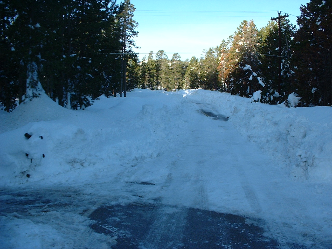

We don't normally have the snowfall you do (although we did get 62" in one storm about 15 years ago), but I do have a B7800 with FEL and rear blower. I recommend that setup because of the flexibility, as SkunkWerx says. I have an old 72" blower, which the B7800 has tons of power to handle, but it is awkward to work with because it is so much wider than the tractor and the FEL bucket. As SkunkWerx says, 50" to 60" would be the way to go.
Yes, you can lift the blower and take off layers (as long as the snow isn't too packy, which leaves the packed wheel tracks almost impossible to remove). I used to have to do this on the first pass with this same blower on my previous tractor that did not have a live PTO.:eek:
