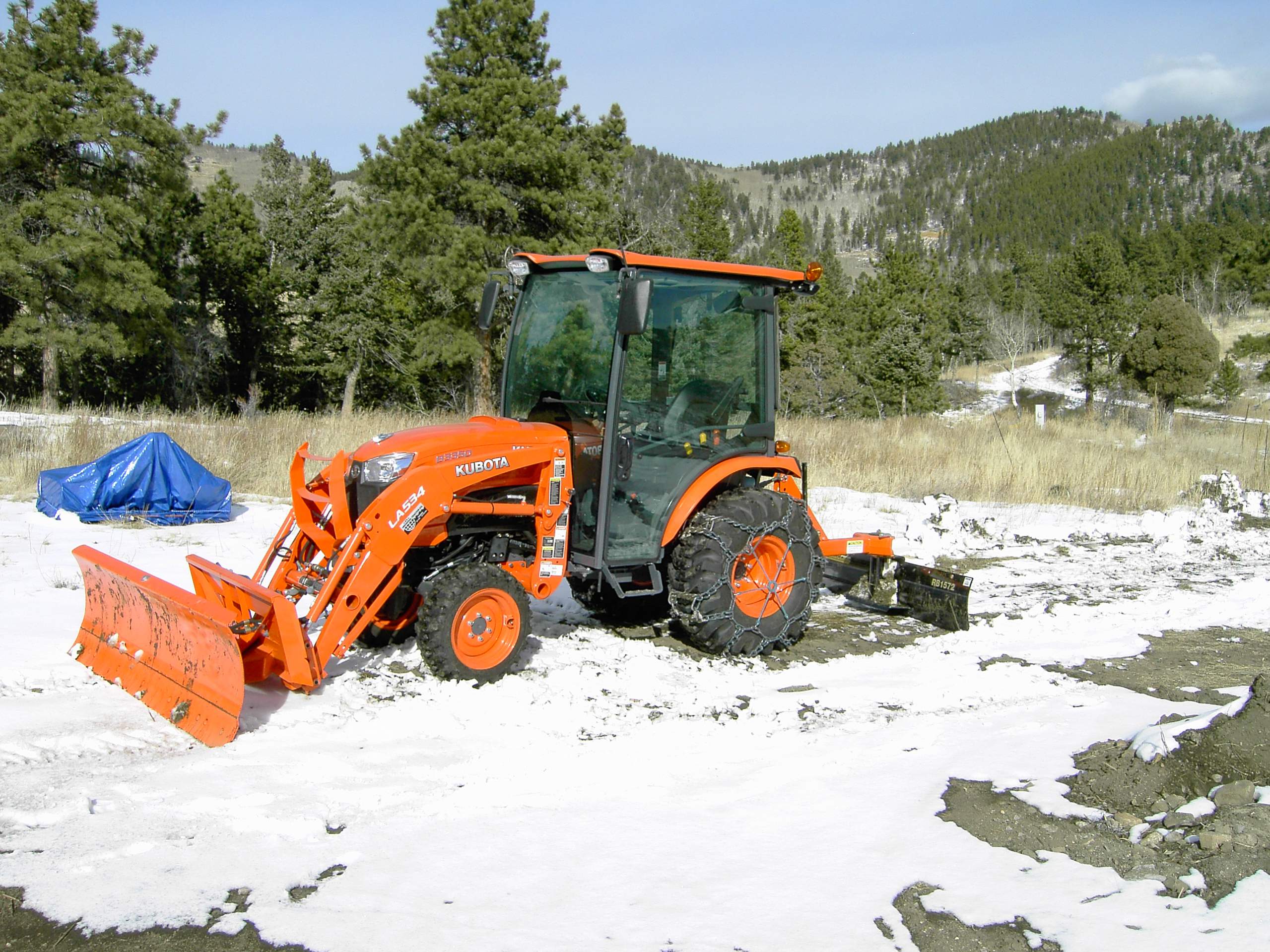

I just got a Kubota B3350 with
Front loader 60" bucket
72 Hydraulic snow blade with a 3rd function valve
72 rear blade.
The dealer was excellent and spent many hours teaching me in how to drive the tractor (I have zero experience/knoledge of tractors)
I need to clear the snow in a little less than a mile dirt road, in the mountains, with some areas of steep grade so I can get the suv to the road.
Q1 how should I orient the rear blade? with the convex part forward of backward
Q2 how should angle the rear and the front blade?
Q3 the front blade has a pin that allow the blade to be fix like dozer blade or to be floating, I set it up floating for snow correct?
Plase any tips very appreciated, even the more obvious to all of you are new to me.

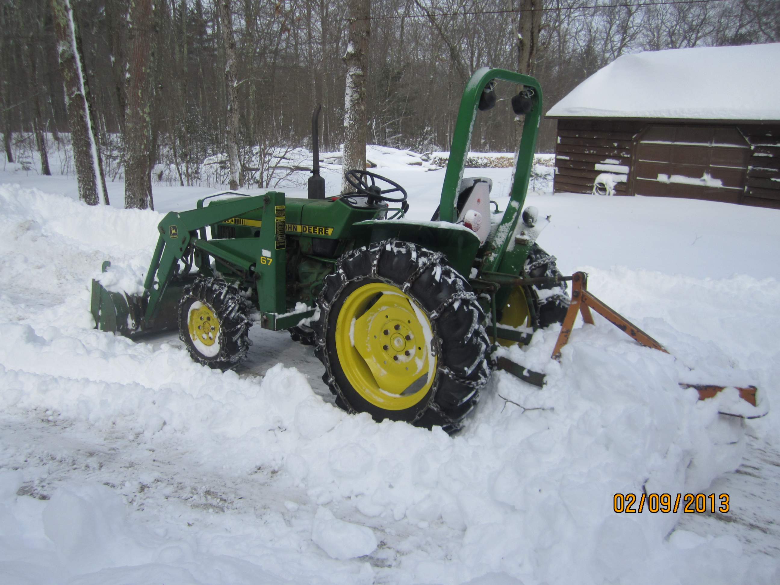

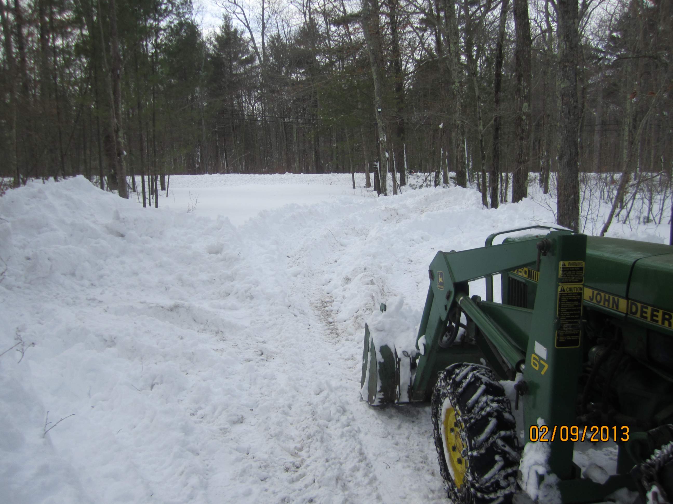

s219 gives good advice about the rear control arms. I bent my adjustable anti sway bars on the back of my tractor using the rear blade just like you're using it in your pic. I know it's very tempting to be able to move snow forward and backward as it is so efficient but I'll now always turn the tractor around and use the fel to "push" a snow pile. The rear blade I'll simply use to "pull" snow and with it angled for long runs. Here's a pic of my old tractor dealing with a 27" snow event. I'd push and pull snow. Go as far as I could with the fel and then back over the snow the rear blade left and push that with the rest. The rear blade is useless with this deep of snow unless you mitigate its depth with the front fel or plow first and then clean it up with the rear blade going forward..

Looking at your road, I think you'll have to start at the top of the hill and work your way down.
You install "washer" on the shoes of your blade, the more you put, the more your blade will "lift" away from the ground, as stated, about an inch off is good until you have a good base.
Angle your front blade, starting on one side of the road and pushing to the other, you will need to do a few passes, probably 3, looking at your road. This will create a bank on the side you've plowed to.
Next time, you can push the snow on the "other" side, changing the angle of the plow, the other way.
I would turn your rear blade the other way (opposite to whats in your picture), keeping it straight will allow you to pull snow away from garage doors etc.,
