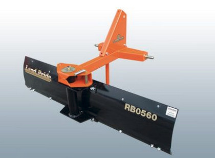

I haven't done snow removal in a long time but one of the best tips I learned is always put snow to the downhill side and pushpiles should be placed where they will not melt back over the drive area creating more ice. Good luck and have fun.
/ Need snow removal help #42
Sorry, I guess I left that part out! Yes, I reverse the blade and go forward with the tractor - I actually did that today just to dress up the gravel a little. I keep the road in good condition and don't let it get potholes (I grade it often enough, I guess) so reversing the blade works for me.
I just recently built a pole barn and added about 200' of road and I've been grading that with the cutting edge of the blade forward because I need to 'rough up' gravel to continue to smooth it out. I do a couple passes that way and then reverse the blade to give it a 'finish'.
Gnawbone, Thxs.
If you see the picture of my tractor I have the rear blade like you said because. the only time I tried was easy to move forward with the blade in that position without getting stuck in the gravel. a couple of the member make me aware of the dangerous to damage the rear triangle with the blade in that position (THXS)and I assume that would be the case if I use it for pushing where the blade should be in reverse, but if I only move forward and I use it as a complement of the front blade may be OK. If I understand correctly that is how you do it.
In summary if I use the rear blade in reverse I should not use it to push, If I need to push snow I should turn the tractor around and push with the front blade. Does it make sense?
BTW my rear blade is very simple and it does not have a floating position like the front one.
/ Need snow removal help #43
Your rear blade will"float"up and down because the three point does not have down pressure.
