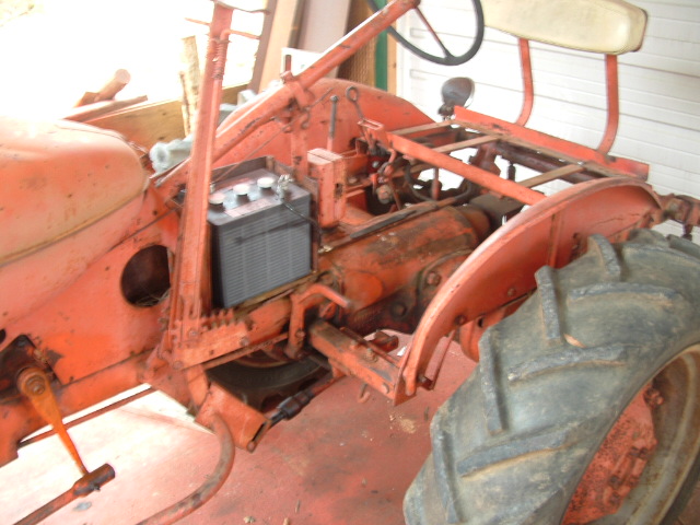

Matt, I took some pics of it today. It seems this particular B came from the plant with the snap coupler. The bell mounted like a drawbar on the front of the final drivers.
I don't have the bell, but it still has the latches. This one is pretty neat, or will be when it's done.
#1 this pic shows how the front lift mounts
#2 shows the snap latches and the homemade 3PH that sticks 3' behind the tractor
#3 shows the selector valve to choose front or rear

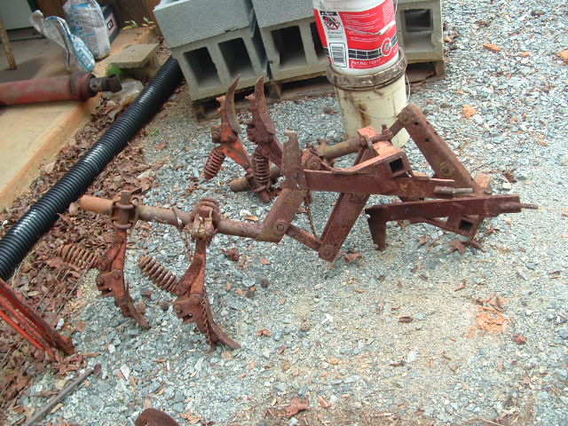

Here is one side of the front cultivators. The pin sticking out goes into a hole on the front radiator support and it has 2 slotted holes that fit onto the boss on the torque tube.
The second pic shows the way the rear toolbar mounts on the latches

Nice tractor ! that one looks to be in good shap for a restore . It looks like it mostly complete , you can yous a few parts from a CA or C such as the round door to the toolbox that is missing . It looks like you have the quick hitch cultevator . Does it have the ajustable frount axle if it does then its probably a 1945 or newer ? I'll try and dig up a picture of my CA after I restored it. These were built to last , good luck with the restore

Matt, it does have the wide adjustable front axle and the cast,dish rear wheels. It also has wheel weights inside the rears.
You're right on needing the toolbox cover, and I'll need a grill screen, and the snap coupler bell but other than that it is complete. The engine was pro rebuilt by the fellow I got it from, but the owner installed it and didn't get the firing order right so he couldn't get it started. I put the plug wires on the right plugs and charged the batt and she fired right up, good oil pressure and runs like a kitten. The rear tires don't match, so I'll have to buy one tire as it has 1 new 23 degree firestone and 1 worn Silverton. The wheels are all nice, no rust spots, all in all I'm happy so far. Later, Nat
