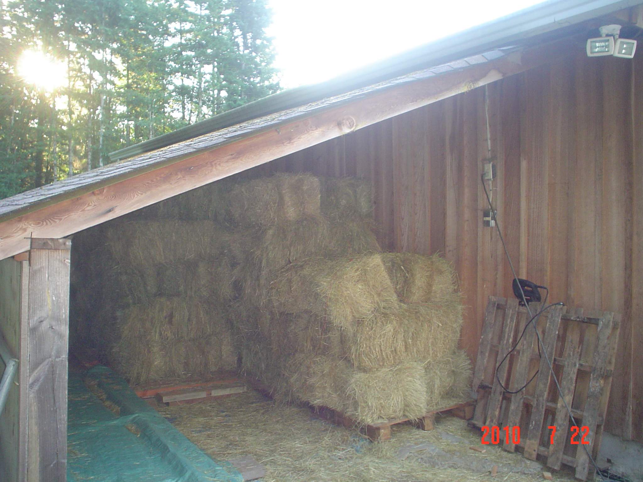

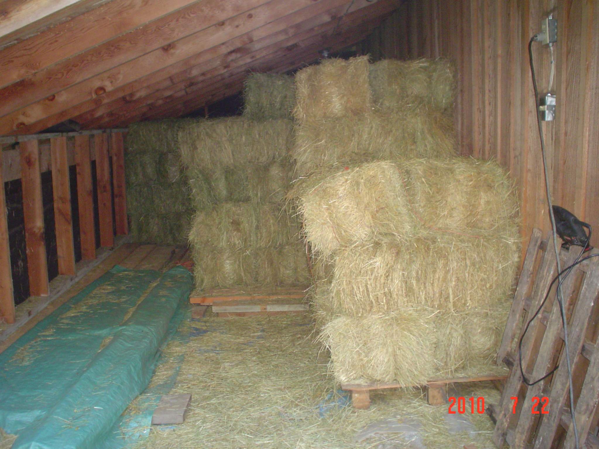

   / Need some hay barn wisdom. #4
Put the hay shed on the left side of the barn a couple of years after the main barn was built. Has a gravel floor so put down a large old tarp and then pallets to maintain some air flow and keep the hay off the ground. Right now there are 110 bales in it and 30 more coming. Out our way we do try and keep some air space around the hay as it can get moldy because of our sometimes damp climate.
   / Need some hay barn wisdom. #5
Off topic a bit but I thought I would mention what I do to deal with humidity and sometimes short drying times in the field.
One, we always stack our hay on the side as it will "breath" better. Two, we buy salt in a fifty pound bag and broadcast it on the layers as we stack. Not too much, kind of like salting your breakfast eggs. The salt absorbs moisture and the horses like the taste.
