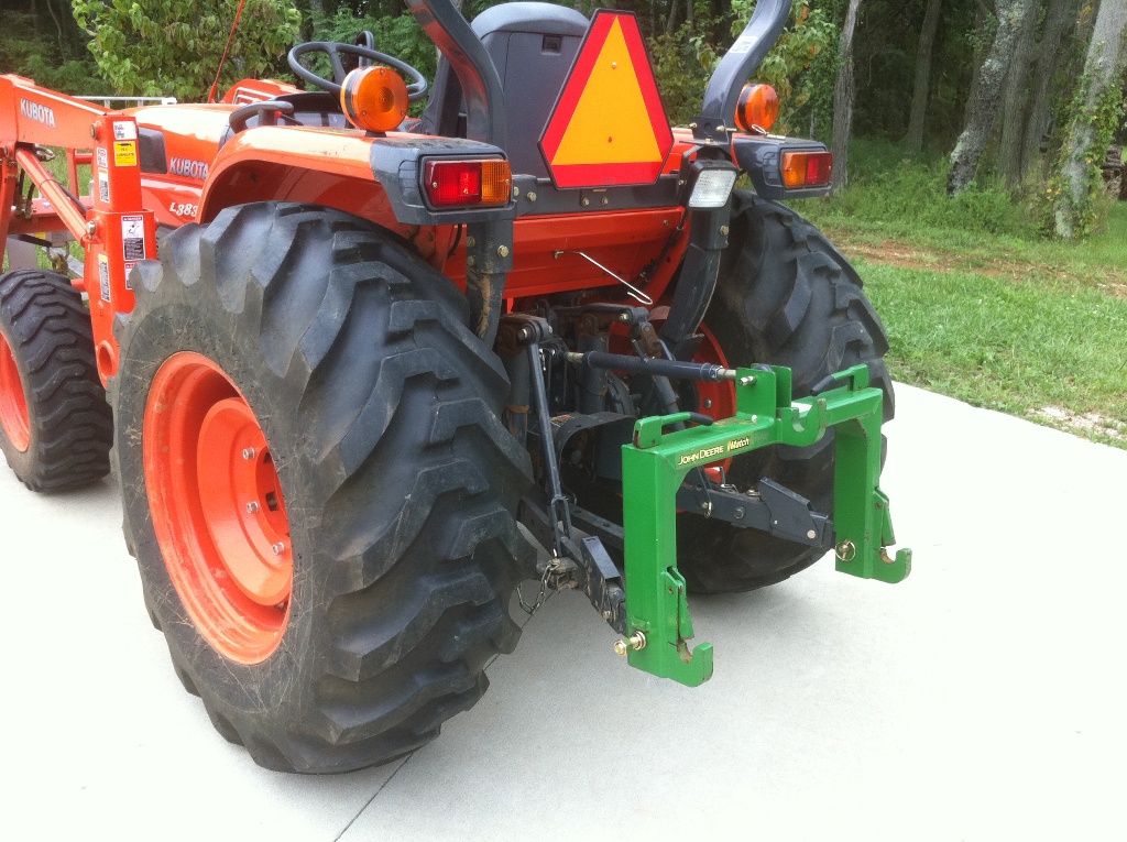

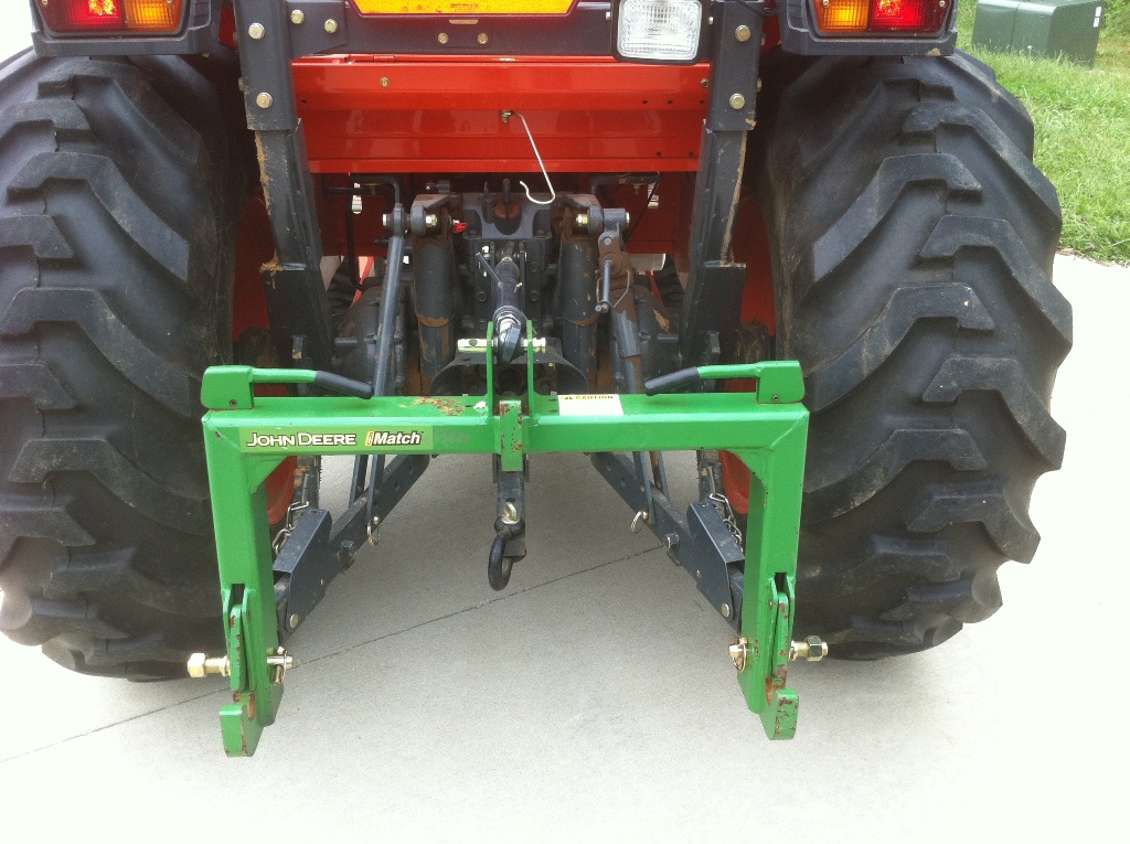

Here it is! :thumbsup:
The Green really clashes with my Orange! :laughing::D
Fits very well and looks like it's gonna work with all my implements... except the trailer mover. :licking:
The trailer mover is too wide at the bottom.... really strange. Will require major surgery to make it work... I may just sell it. I really like it though. :(
So the next step is to add mods to the QH like chain boxes and stuff... also a 2" receiver! :thumbsup: Then it will go to paint... Kubota gray!
I've seen some nice mods on this site. Time to start collecting some pics! :cool:
