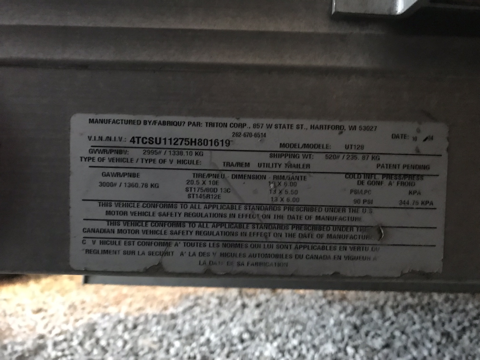

Well, I need to verify the model, as the 10" rims were the original, so it is probably not the UT128... I will look this evening and correct that. However, speaking of rims and weight limits… I assume, this is just like axles... so if you have rims that are rated at 900#'s, that means you should be able to carry a load of 1,800#'s if a single axle, correct? The reason I ask, is b/c the highest weight rating I seen on 10 or 12" rims were like 1250#'s and this trailer is supposedly designed to carry up to 1,660#'s.
My mistake 20.5 x 8.0 - 10 where the rim width is 8” and the tire diameter is 10”, right?
http://www.bigriversltd.com/files/6313/6656/1212/UT128_-_2004.pdf

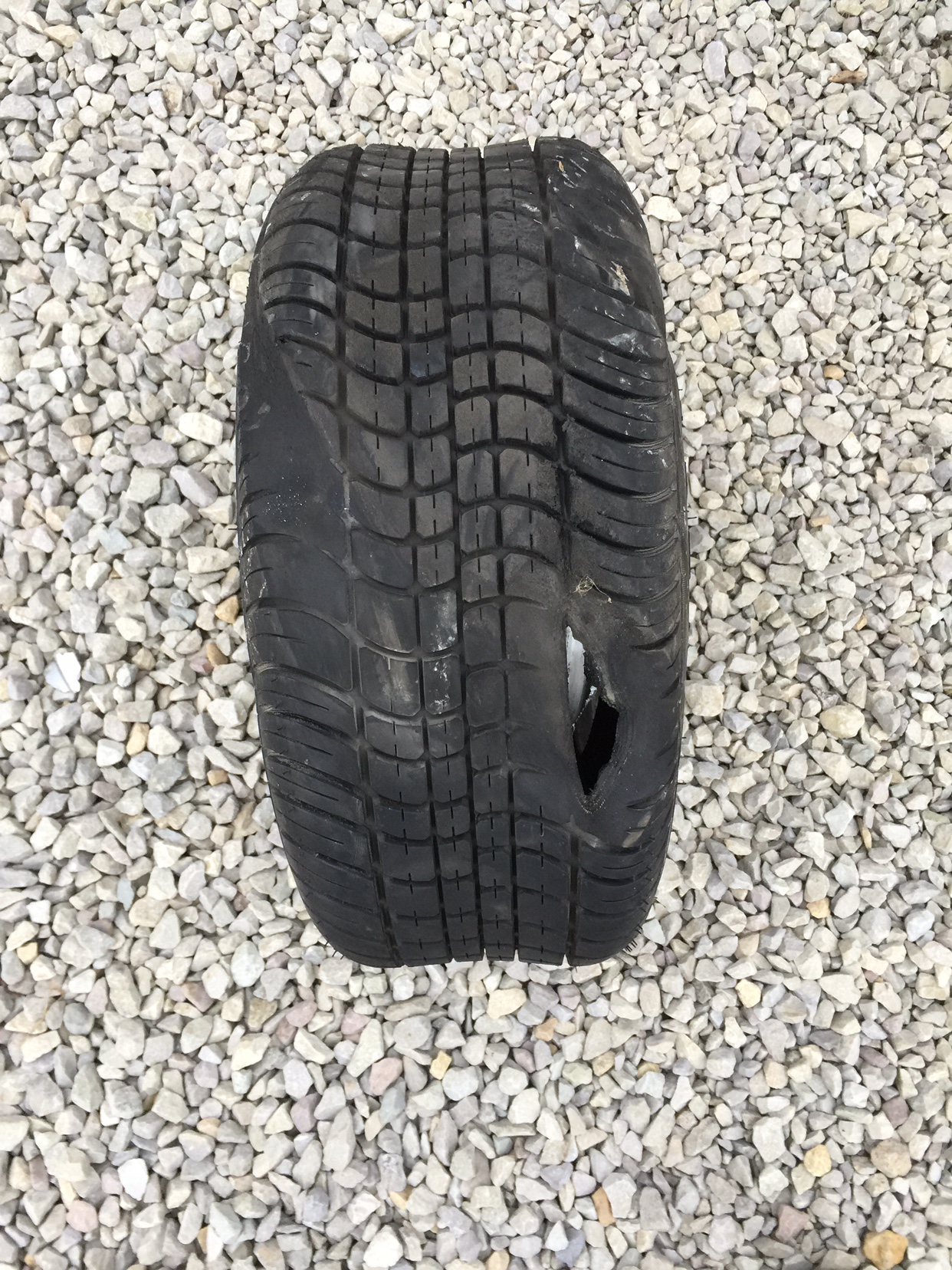

Your failure seems odd, I think we are just trying to help you figure out if this is an anomaly due to bad parts or an inherent problem of the tire type/size.
The fact that you were able to recover lugnuts and 2 were together makes me wonder, I've had lugs back off and even studs break, I've rarely found a lug much less multiple lugs together.
My worst was a F550 pulling a gooseneck with about 12k lbs on the trucks rear axle, all 8 studs on the left rear broke, at 60+mph. Needless to say I didn't recover any lug nuts, or the outer wheel/tire!
Ok, good to know, thanks.
Yes, and I actually believe if I would have been able to walk both sides of the freeway from the point that it blew to where I pulled over to the side of the road I would have found them all. I was pretty sure I seen at least 2 more on the other side of the freeway, but it was 3 lanes and traffic was fairly heavy so I didn't risk going after them. I had found those 2 plus the 2 that was holding my spare on the holder. So I was able to put 4 on and then drive a 1/2 mile down the road and buy 4 more plus a bearing cap at the local auto parts store before continuing on my way.

Here is the info off the tongue..... am I reading this right that I can put a 12 or 13” tire of a 13” rim??

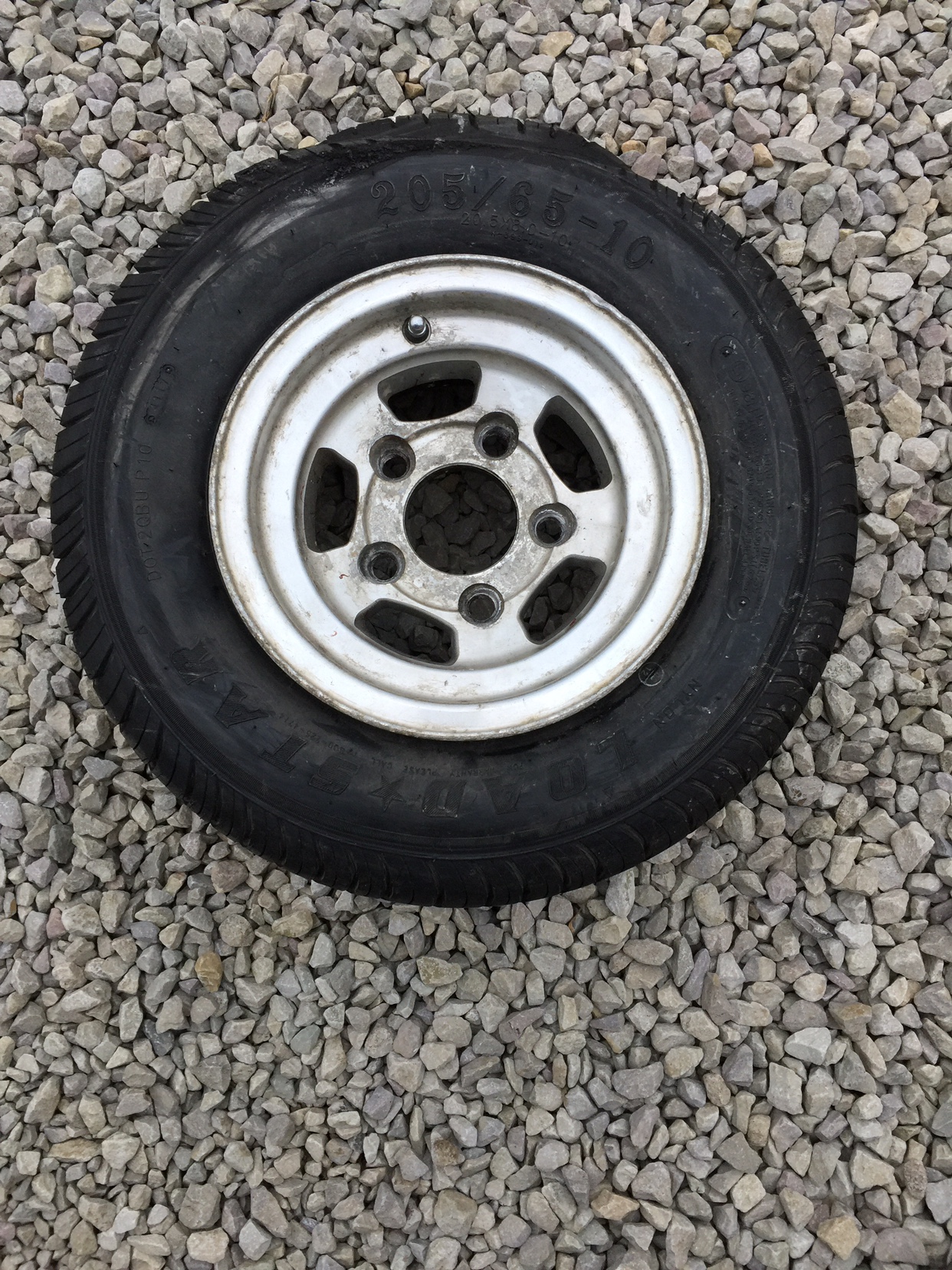

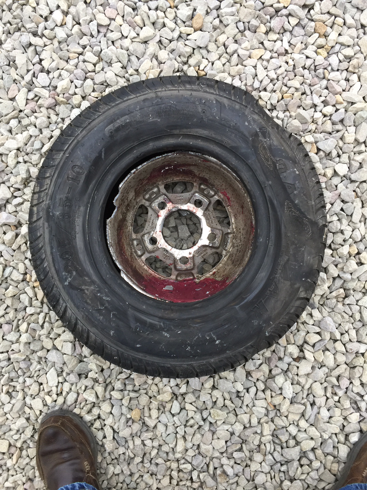

But after finally getting time to actually take a closer look at the rim, I believe the lugs came loose and caused the blowout rather than a tire failure. It appears that the holes in 2 or 3 on the rim were worn out a little oversize.
   / Need some tire advice / recomendations #30
Wow, that tire was dragged for quite some time, maybe the wheel came lose and wedged itself and dragged until it finally wore through?
