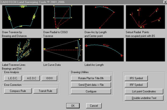

I have two surveying questions? How prevelent are those length units found in metes and bounds like poles, chains etc. do I need to add that to my software? 2. What method would you use to balance HobbyFarmer's plat, Compass rule or Transit rule?

These units are not found much these days except in very old property descriptions. Today a 100' steel surveyors tape is commonly refered to as a chain, but when called for in a property description it means Gunter's Chain, which is 66 feet. Everything else pretty much descends from that. An acre is 10 square Chains, a rod or perch is 16.5 feet which is 1/4 Chain. If you get into varas it is a whole 'nother story. There are about 30 definitions for vara. Compass rule was traditionaly used on old traverses. Be sure and balance the angles before applying Compass rule. (N-3)180, with "N" being the number of sides to your figure.

TNhobbyfarmer, Thanks for the invite, may be able to visit someday. I really like that country out that way. I think this year is "get the cabin finished year" though. Keep posting what you find out and we can add info to the plat map as we go. I posted the maps so when (if) you hire a surveyor you will know exactly what you need done and wont waste your money. I've been writing software to draw plats and wanted too see how it did with large metes and bounds. Based on what Bruce said I wont add pole units, just keep things in feet. I need to add the balancing routines.
Bruce, I'm sure you mean (N-2)*180. I've always let my data collector do the adjustments and then just download the COGO. But I need to add that to the my software.

Here is a screen shot of the software I'm working on. I'd like to add GPS overlays to it.
I hear that by late next year consumer GPS units will be accurate within +-1ft. Currently I think it is -+10ft. So you might be able to get a coordinate on a known corner and we can overlay it on the plat.
