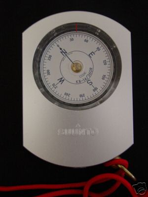

Bob:
I'm sorry, but solar noon is beyond my area of expertise and if it would allow you to calculate astronomical North, it would only do you any good if your plat was based on True Bearings. If you know of two corresponding monuments in your subdivison with line of sight between them, simply take a compass reading between them and then by matching your reading to the plat you can figure your rotation, or declination. By matching the local declination in this manner you can override any effect of the minerals in your area. I practice in a very iron ore rich area and it works for me. Because of the brush, expect your measurements to be short.
When I speak of doing a solar observation, I have an total station set up on one of my hubs and am back-sighting another hub. Through the use of a solar filter, I take three readings on the location of the sun direct and three readings with the scope reversed. I can calculate the True bearing of my hubline at this point and rotate everything to match.
HomeBrew2 is has good advice about basis of bearing. It's unknown in most cases. The really old surveys ( 1800's ) hereabouts give the declination used and from that you can calculate today's declination. What I have found by doing solar observations is that the old surveys run within 15 minutes of True, while more recent ( 1940-current ) surveys in my area are anywhere from 1-6 degrees off.
I think what zeuspaul means by "first try" is that it will probably take a couple of turns before the two distances intersect. I have been doing this so long that I usually just pace the distance if under 500 feet and allow an extra step ( or more ) per hundred feet if brushy. I don't start cutting brush until I have found the monuments. Tie two pieces of flagging on the line you want to hold and have the head chainman work backwards and use them to line up on, tying more as he goes ahead. My neck of the woods is full of brush, briars and cut-over timber and its not uncommon for me to have to tie a piece every 25-30 feet. We have a lot of tracts here that border reservoirs which are monumented along an imaginary zig-zag contour line every 200-500 feet and by using this method I can generally wind up within a 5' radius of the corner on first try, then use the metal locator. If I drag the chain with me I can usually be a foot or less but that requires the use of an extra man.
I have two big old brass Gurley surveying compass' that I use sometimes on the larger retracements, but for everyday use I prefer the Suunto KB14 360R in Azimuths rather than Bearings. It will generally keep me within 15 minutes and that is well within needs for most cases.
No offense taken, I realise that without tone of voice and body language things are not always as they may seem. I need to constantly check myself as I have a sarcastic wit which is not appreciated by many. :)
Bruce
