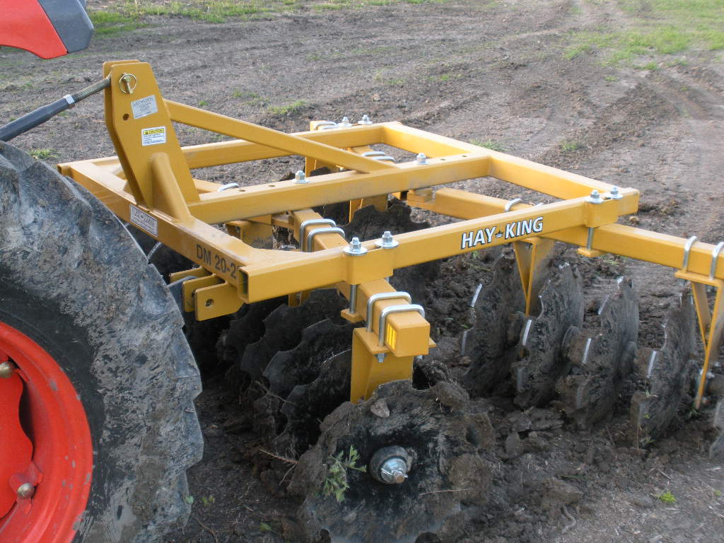

I ended up going with a Hay King 2020 3 point disc.
It is manufactured locally in Central Texas. At about 900 pounds it weighs more than the Leinbach and TSC Discs I was looking at. It has the option of adding scrapers which is something I like given the clay soil on my farm.
Pics below. I guess I should have taken some snaps before it got dirty. Maybe next time. ;o}
They look ok. Have you looked at any others?
