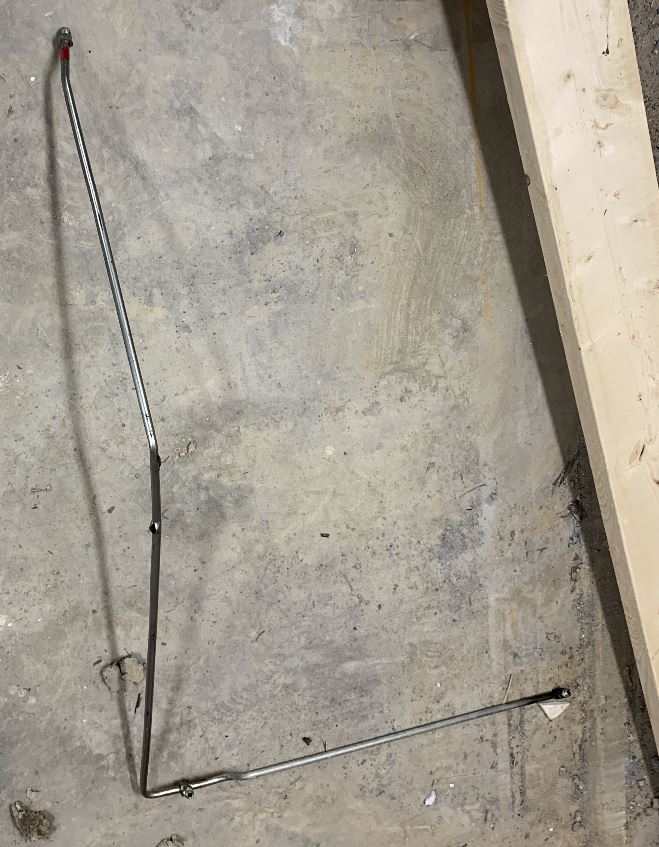

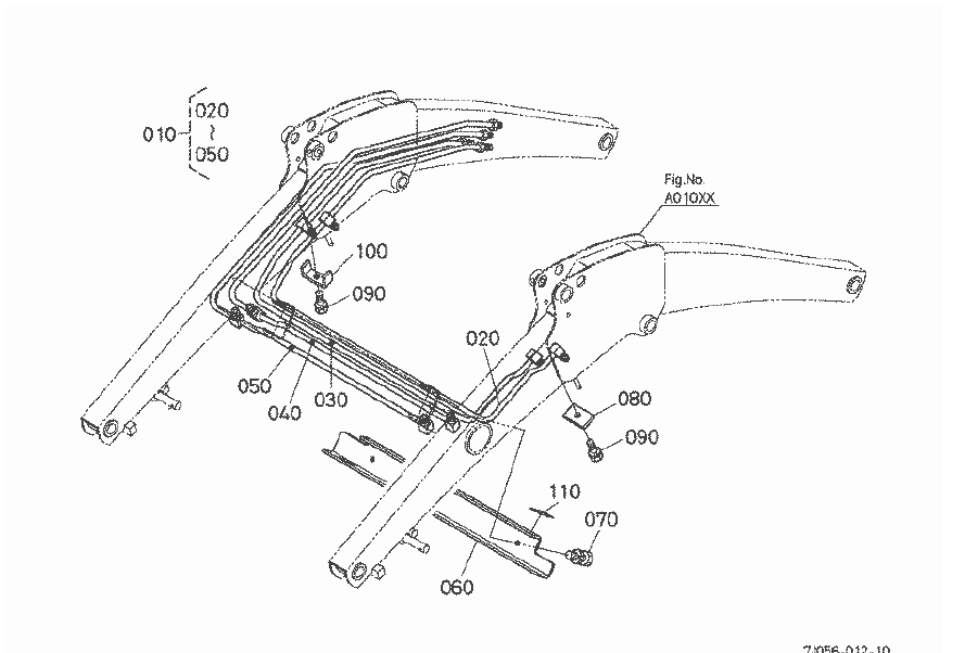

One of my main tubes for my hydraulics burst today. It is 1 of the 4 tubes that run across the fel. It's either number 40 or number 50 on the parts blowup. If you look at them on the actual tractor, they look identical, but the 2 lines have different part numbers, so they are no the same. The one that burst is colored red, but I don't know if that would help the parts dealer to identify which is which. Is there something else I can look for to determine which is which?

I thought about getting one made, but this hard line fits in the structure of the FEL. It's a somewhat snug fit. I also thought about possible cutting the pipe at the leak and using a union to fix it from a brake line. The line is somewhat complex the way it is bent and also has a female fitting built in the middle of the line. Here is a pic of the line.

Curious to learn how the tube "burst". Was it due to corrosion, physical damage, or...?
I'm going to venture a guess the position in the diagram is accurate, so you should be able to determine based on the physical location. Another possibility is to note which function this tube is used for and call your dealer. The tube description has a numerical reference (tube 3 or tube 4 for item 40 & 50) and it is likely the dealer will be able to match up tube id with function.

The tube was in good shape, the tractor is only a year or 2 old. I was on a hill with the back end of the tractor on the upside of the hill. I had my forks on and was pushing tree branches down the hill. The forks were pointing down and dug into the dirt. The weight of the tractor lurched forward hard and the forks were in the ground and my guess is it created too much pressure in the hydraulic system and that is why the tube burst. I had this incident happen before on another tractor, but it was the hose that burst. I was surprised that the tube burst before the hose.
I did call the dealer and they pretty much said to go by the picture and where it is located in the picture, so I did. I got it ordered today. It will take a week or so to get in.
