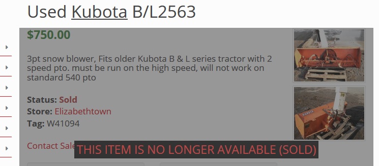

I found a clue that enforces my opinion that my 540 PTO is too slow for a B/L2563 snowblower. B_L 2563 ad with PTO speed reference.jpg
   / Need to increase PTO speed to use a Kubota B/L 2563 snowblower on a 540 PTO? #16

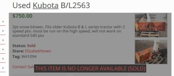

I found a clue that enforces my opinion that my 540 PTO is too slow for a B/L2563 snowblower.View attachment 526159
If you want you can purchase a 540 to 1000 RPM speed increaser from HUB CITY to fit your mule and not have to do any work to fix the snow blower.
The smallest speed increaser being the model 390 from hub city is $808.00 as of the October 26 farm show issue.
Hub City Inc
I guess you will have to decide if buying all the new mounting hardware to make it a rear mount is worth the trouble versus a simpler rear mount 540 RPM snow caster.
