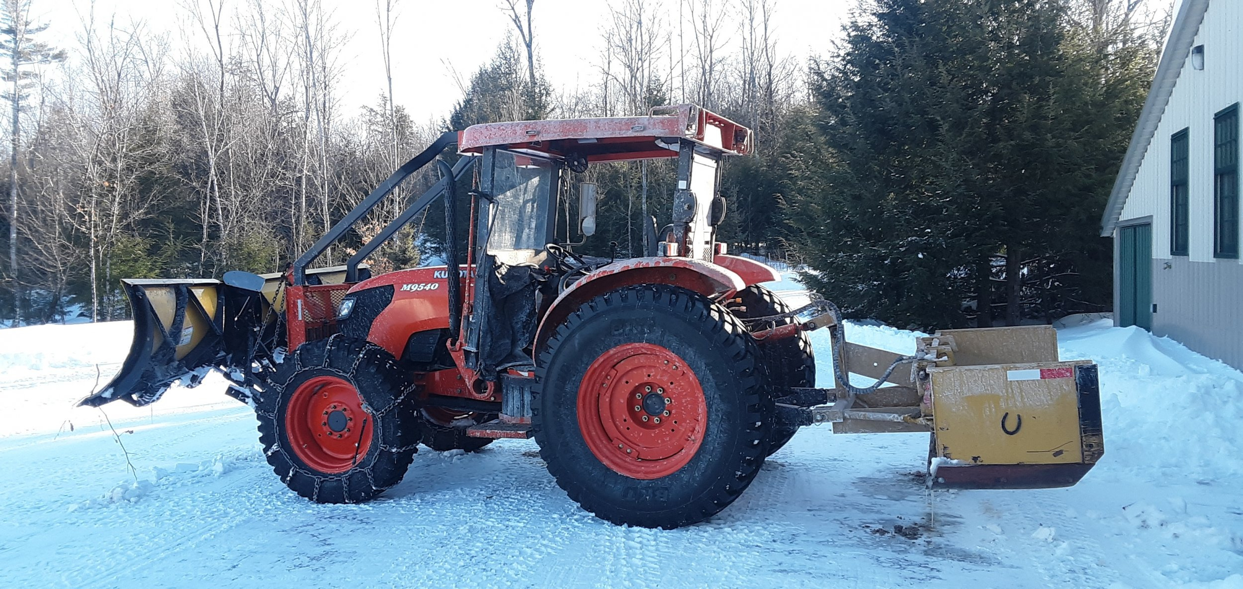

What's the HP on each of your machines? I have an 84" hydraulically driven front mount blower on a 60hp tractor and it takes every drop of power the tractor has. In any depth over perhaps 6", I'm running really slow. I love the front mount vs rear PTO mount, so it's worth it, but don't underestimate the power required to blow snow. For a 96" blower I'd want 70-80hp, if not more. If you have less HP, I'd go for a narrower blower, or plan on moving very slowly.
What about traction? I would be nowhere without rear cleat chains, and steering is very difficult without front chains. I've gotten good at brake steering, but even that doesn't work so well. I really need front chains with the front blower. I have very little experience with skid steers, but the snow clearing I did with a wheeled skid steer had very poor traction. Tracks might be better, but I have pushed snow around with my rubber tracked excavators and traction is again challenged. In contrast, nothing will stop the tractor with the cleat chains. You could put studs or chains on your skid steer, but then I'd worry about road surface damage, and drive train stress.

well thats weird. i have an 84" blower on a 45HP tractor. ive blown 2' drifts with no issue. my pump is set up for my tractor HP, i wonder if yours is set up correctly.

I think we have the exact same Erskin blower setup. And I think my tractor is closer to 50hp at the PTO, not 60hp. I'll get more experience with it this winter, and there is a possibility that my turbo wasn't working correctly last winter. What I know for sure is that the 84" hydraulic blower with PTO power pack puts a significantly higher load on the tractor than the 74" rear mount mechanical PTO unit I was using for the past 15 years. Some is the wider width and associated greater load, and some is power loss through the hydraulic drive.
