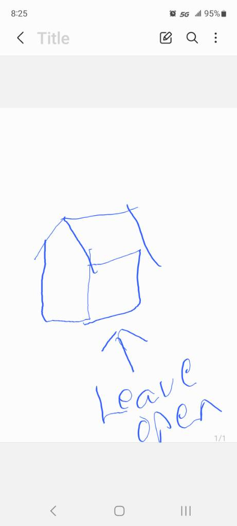

Tupperware. They make heavy duty "boxes" of all sizes and shapes. Get the correct size - turn it upside down - put it over your inverter and battery - attach to post. Leave the bottom open for ventilation.
Besides - Tupperware just went out of business.
