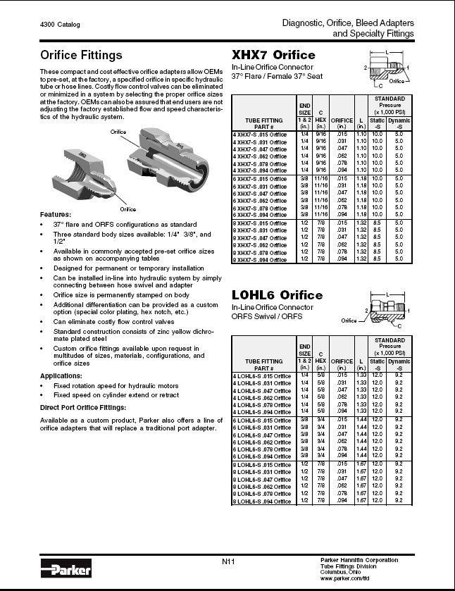

Andy, I am not very good at tracking things down on a lot of websites, :eek: could you please put a link to the page that has the restrictors?
Thank you very much.
This is not from Andy's referenced site, but anyone who carries Parker fittings should be able to get these. Catalog page attached.
