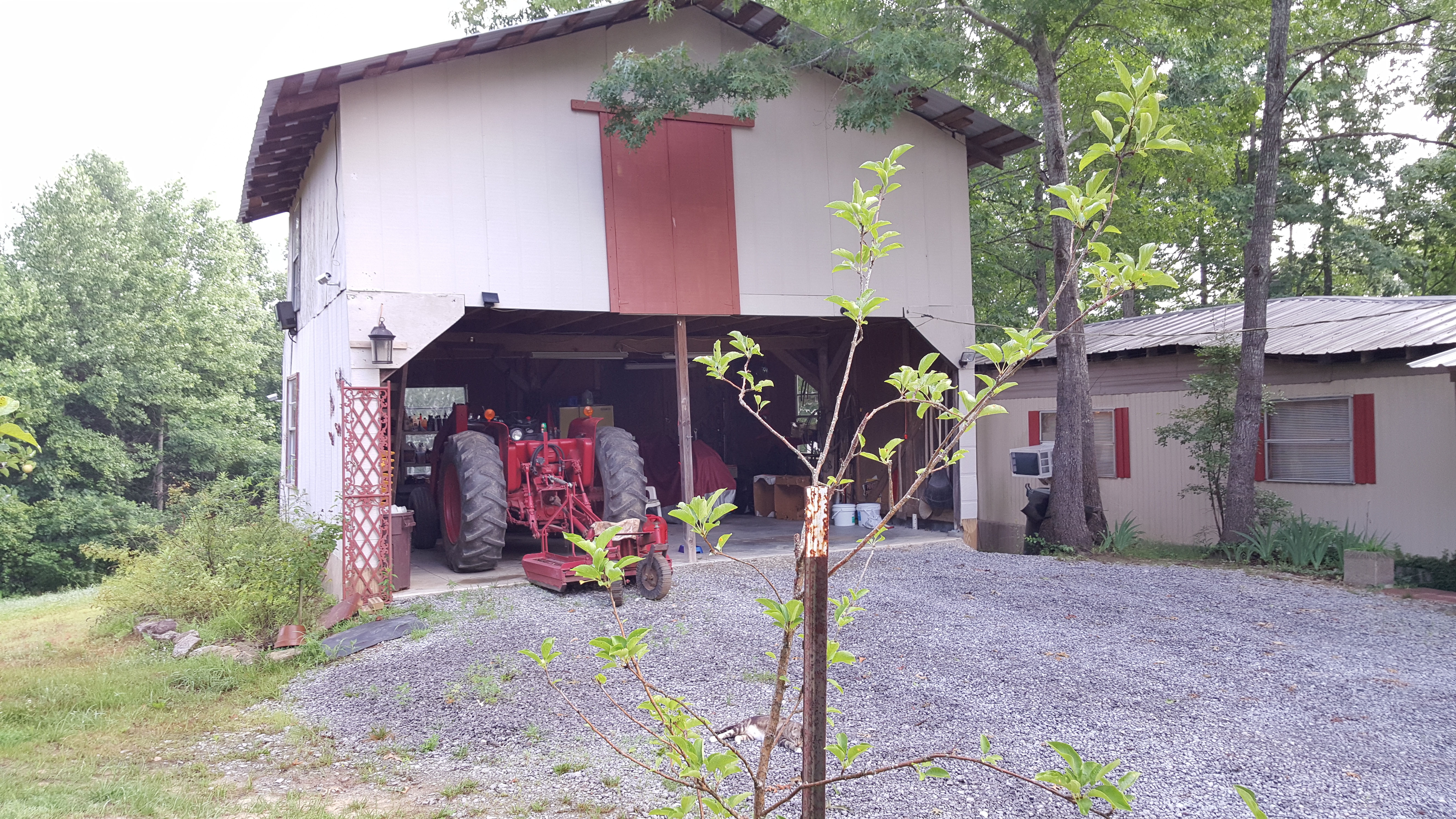

According to a phone app. the distance between my barn and the closest part of the pond is 277 ft. I figure I can run underground power down there easy enough and bury next to it a pex pipe thus utilizing a submersible pump to push the water up to the containers with a float to cut off waterflow once containers are full and turn off pump each time we depart.
Now I must figure out needed wire gauge for the 280ft electrical run and the right size of pex pipe necessary for quick effective refills...or I can even utilize the 3/4" tubing I already have at hand. Decisions decisions LOL!
Pics of the pond and the barn.

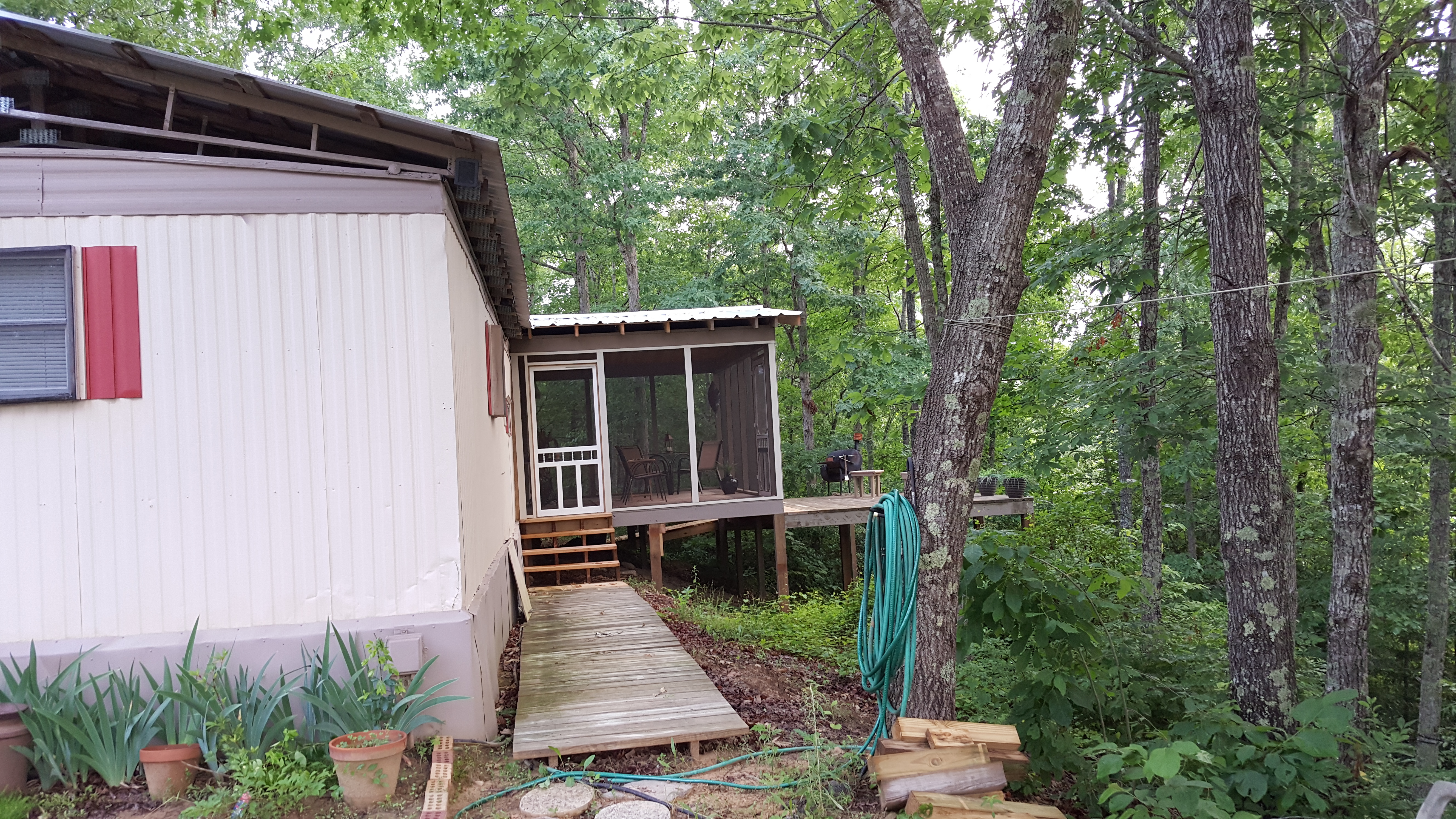

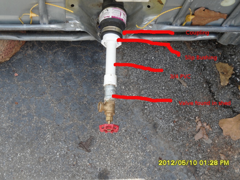

<snip> since I've noticed that even though the water freezes within the container the integrity of the tank is still in tact. I can always drop a heating element in them for the winter months I guess but for the time I'll need to locate/purchase a coupling for its quarter turn faucet so I can install a water hose for easier water transport to the house.
I'm going to get a heat tape or immersion heater to drop in the tank.
There are 3 or so different type fittings commonly found on the tanks. There's a youtube video showing each different type. I initially ginned up several pieces to adapt to a faucet:
but I found a solution on line that was designed for my totes: 2-in-female-camlock-to-3-4-in-male-garden-thread-adapter.
   / Need water advice
#43
Yep, exactly the same fitting I found online, thanks a bunch for the lead & the pic newbury! It'll be easy enough to fabricate.
