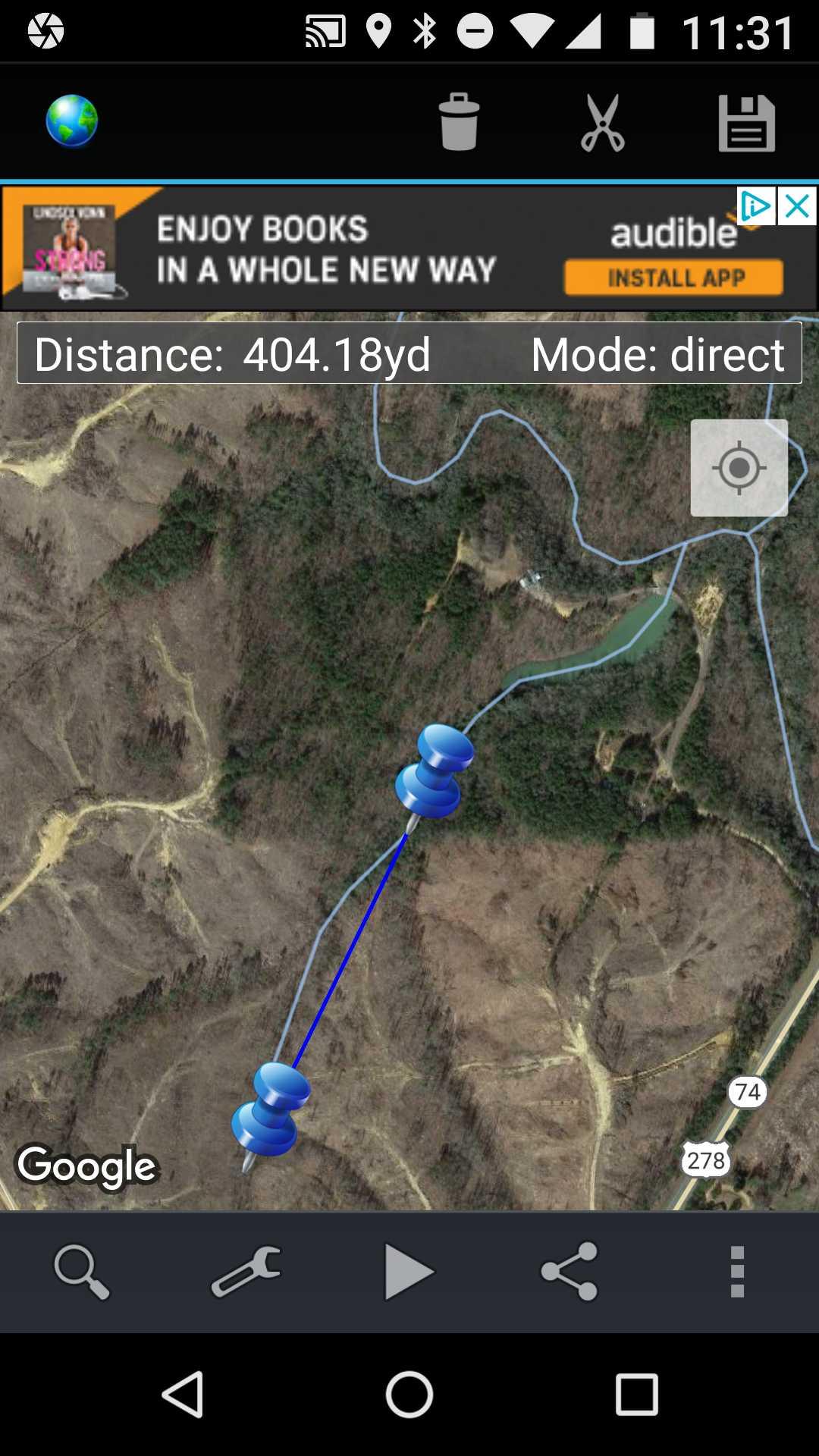

According to a phone app. the distance between my barn and the closest part of the pond is 277 ft. I figure I can run underground power down there easy enough and bury next to it a pex pipe thus utilizing a submersible pump to push the water up to the containers with a float to cut off waterflow once containers are full and turn off pump each time we depart.
Now I must figure out needed wire gauge for the 280ft electrical run and the right size of pex pipe necessary for quick effective refills...or I can even utilize the 3/4" tubing I already have at hand. Decisions decisions LOL!

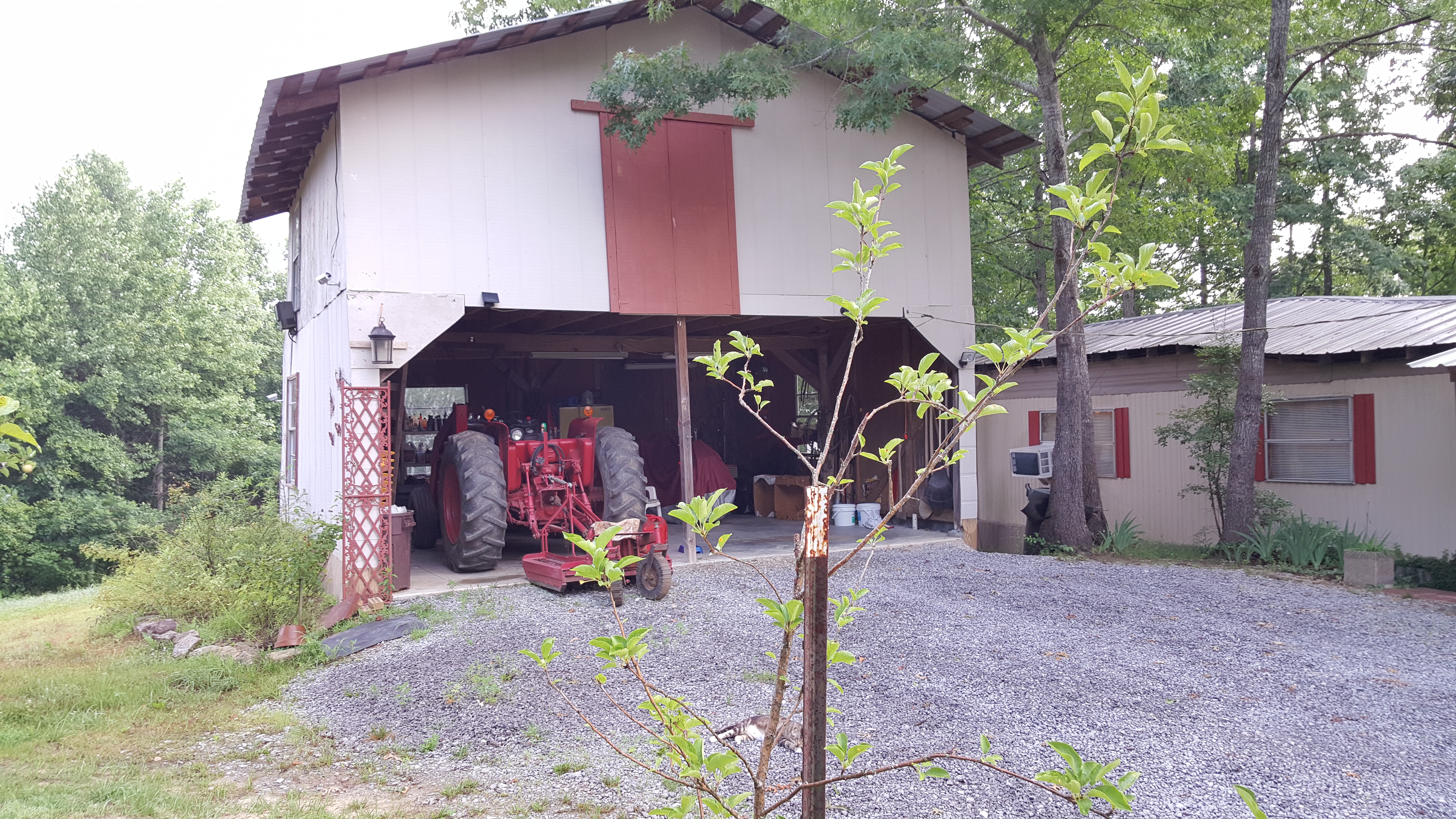

View attachment 538851View attachment 538852
Pics of the pond and the barn.

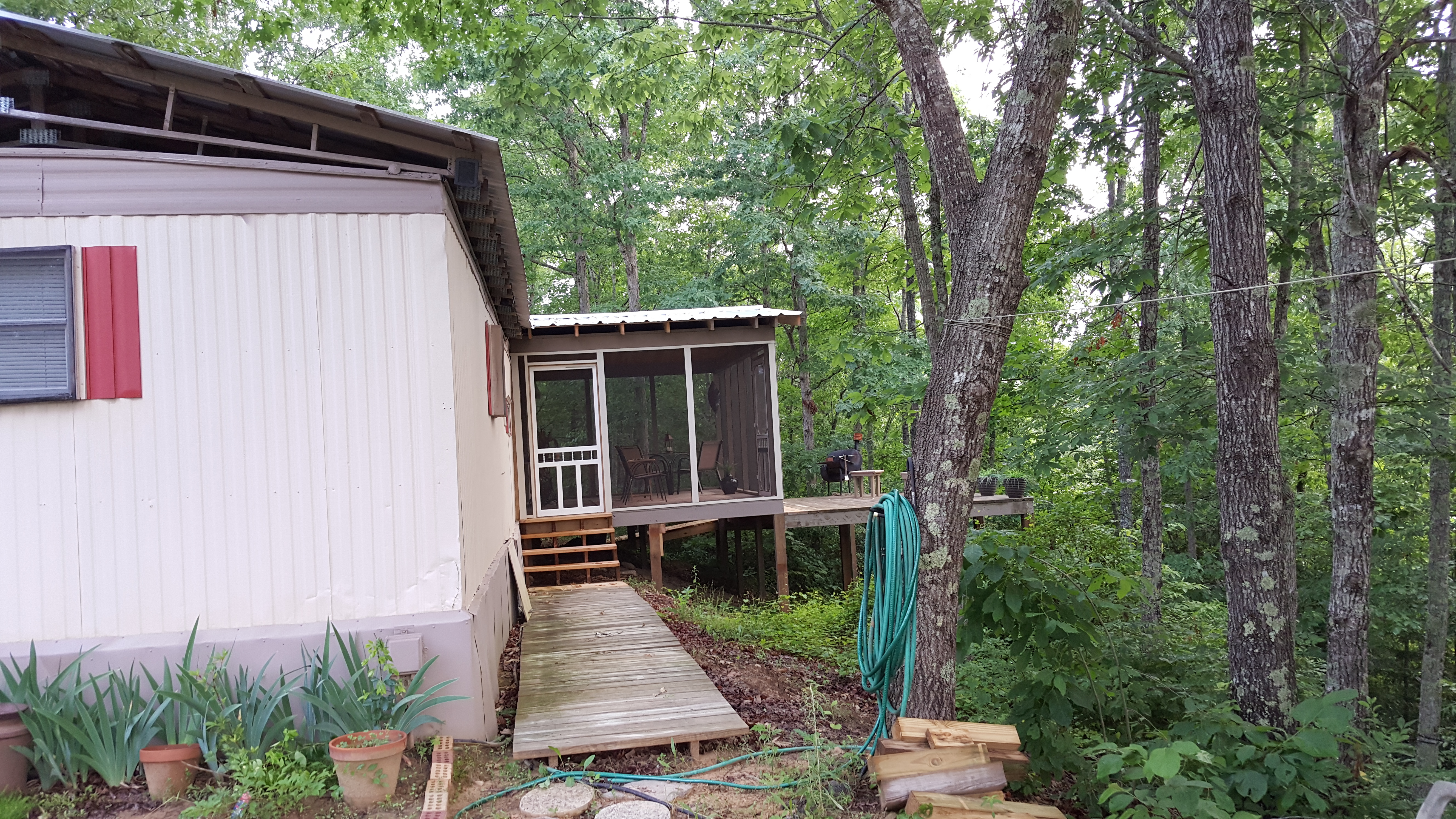

The water line is on this side of the mobile home View attachment 538853

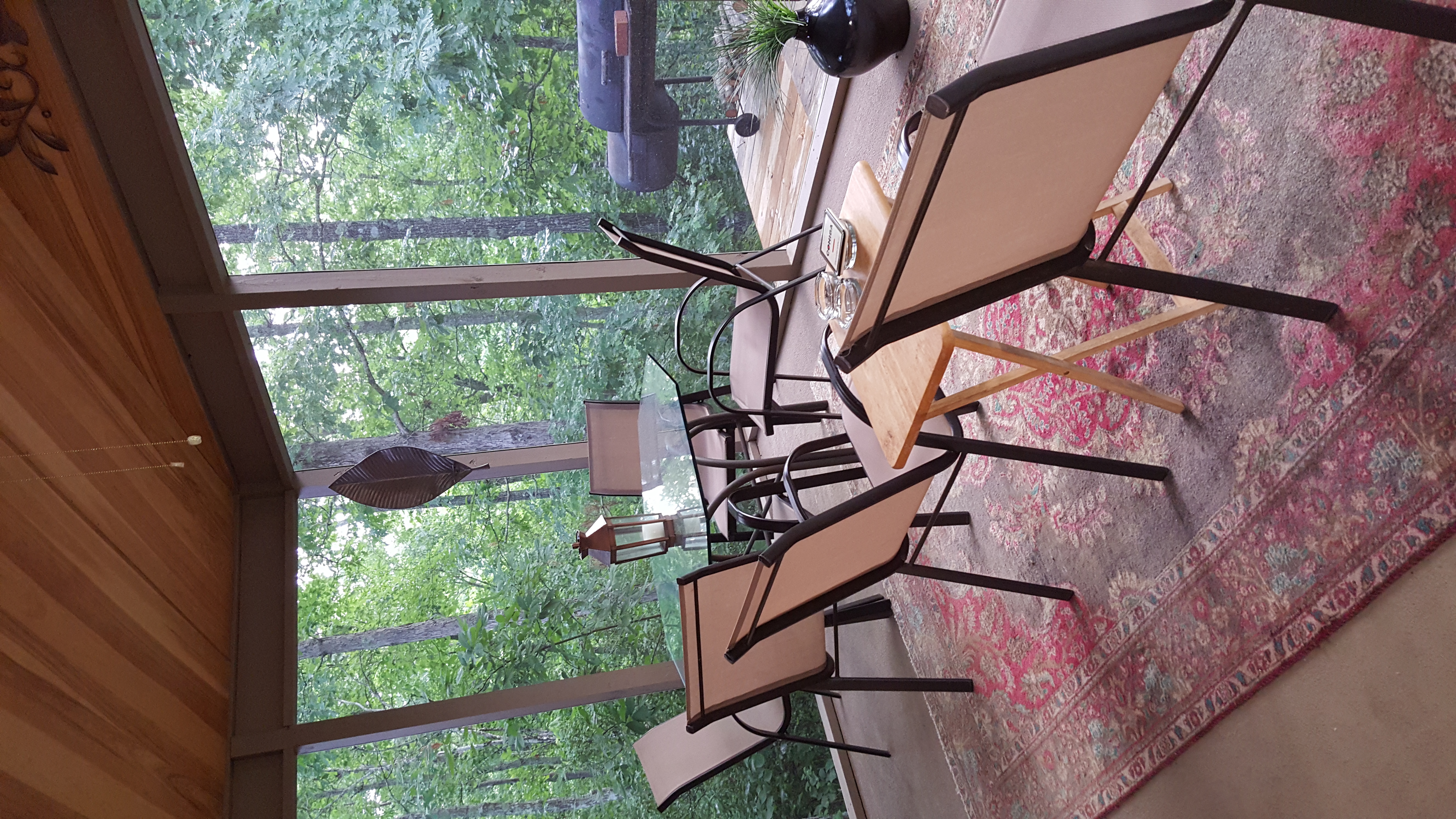

View from our screen room View attachment 538854
