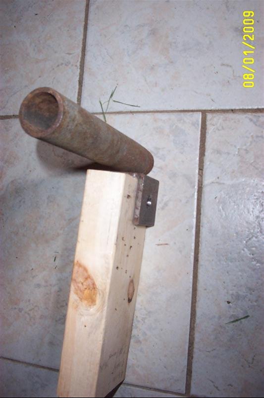

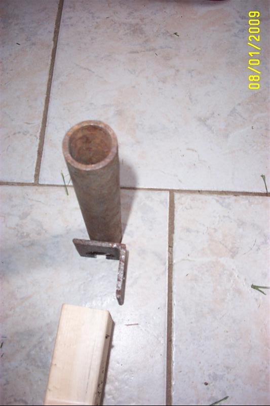

Cowboy357, my thinking was that this is a large cut to make in end grain with a router. I think even a high HP plunge router cutting this size with a sharp bit is going to be a headache. And then you have the problem of needing to use a guide to keep the router cut centered in the 2x4.
Another possible idea would be to weld either a section of channel to the bottom of the pipe or a single tab, and then bolt or screw the channel or tab to the 2x4. Or just use a section of angle like in the photo.

I have already built the ramp. The wood alone cost me over $300. I am trying to build the railings inexpensively. I am planning on using 1 1/2" gray pvc electrical conduit for railing. I need 100' of railing and this only costs $30. Plus it is the perfect size for him to hold and is comfortable in his hand and is weatherproof.
The cheapest round wood railing with the flat bottom I could find was $400 and the 32 metal brackets to hold it were about $150. The cheapest 1 1/4" wood dowel I can find is $1 a foot ($100) and only comes in 4' lengths.
If this was a permanent structure for my own home, cost would not be such a concern, but since this is a temporary structure I am donating, I must be a little conservative.
I could just nail the pvc to the top of the 2x4 but I was trying to make it look decent and professional but not so complicated that it would take me a week to build.

I'm not going to nail the pvc to the post. I have rigged up some metal clamps that will go around it neatly and securely without putting holes in the pvc.
I had considered fence top rail but found it was too small to grasp firmly and way more expensive than the schedule 40 pvc and it also failed my strength test.
Not the most precision test, but I placed a length of metal top rail over two bricks 3 feet apart and jumped on it and it bent right down to the ground and was no longer usable.
I did the same thing with the pvc and it just bounced me back up with no damage. I am sure the 1 1/2" schedule 40 electrical pvc is much harder to bend than the metal top rail.

Your Probablly right 2manyrocks , After reading more of what tallyho8 is trying to do it would be very time consuming as well . looked good on paper though :eek: .
