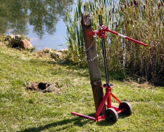

Thought this might be interesting to other members that need a way to easily pull fence posts or the like.
I did something similar to his photo, (below), years ago. I sawed the posts off, flush with the ground, ran a big lag bolt into the top. Placed a large piece of wood, about 2" thick, with a hole in the center. Put a chain, with a 2 fingered hook, through the hole, onto the bolt head. And pulled them out, with an old bumper jack.

Mike,
Excellent thinking making your post puller. I love that it's so portable.
One thing I've noticed about those bottle jacks is it takes a lot of strokes to get full extension. I wish there was a way to get that part done a little faster.
If you don't mind, I'll keep your photos to make one for myself. I know just where to use it where I can't get my tractor to.
Rob-

Rob there actually is a way. Harbor Freight sells the same 8 ton cylinder that's hydraulic/air. I'm sure a small pancake compressor will supply enough air. I seriously considered it myself. See it here

Ha, yes I am older than you Mike.
I saw where you posted your age once, so I know.
But if you add a small pancake air compressor, would your unit would be a smidgen less portable? Perhaps there's another way in that line of thinking though?

Rob, I wouldn't add the pancake compressor to the jack. It would only be connected to the jack via the air hose. And pancake compressors are small and lightweight. I carry a Porter Cable in the truck anyway to power up the framing nailer's.
It would only be one more thing to unload off the truck, no biggie as I see it.
I CAN see where the air/hydraulic cylinder would take some of the work involved out of using the jack. However manually using the hydraulic jack still beats the devil out of a shovel, hands down........
