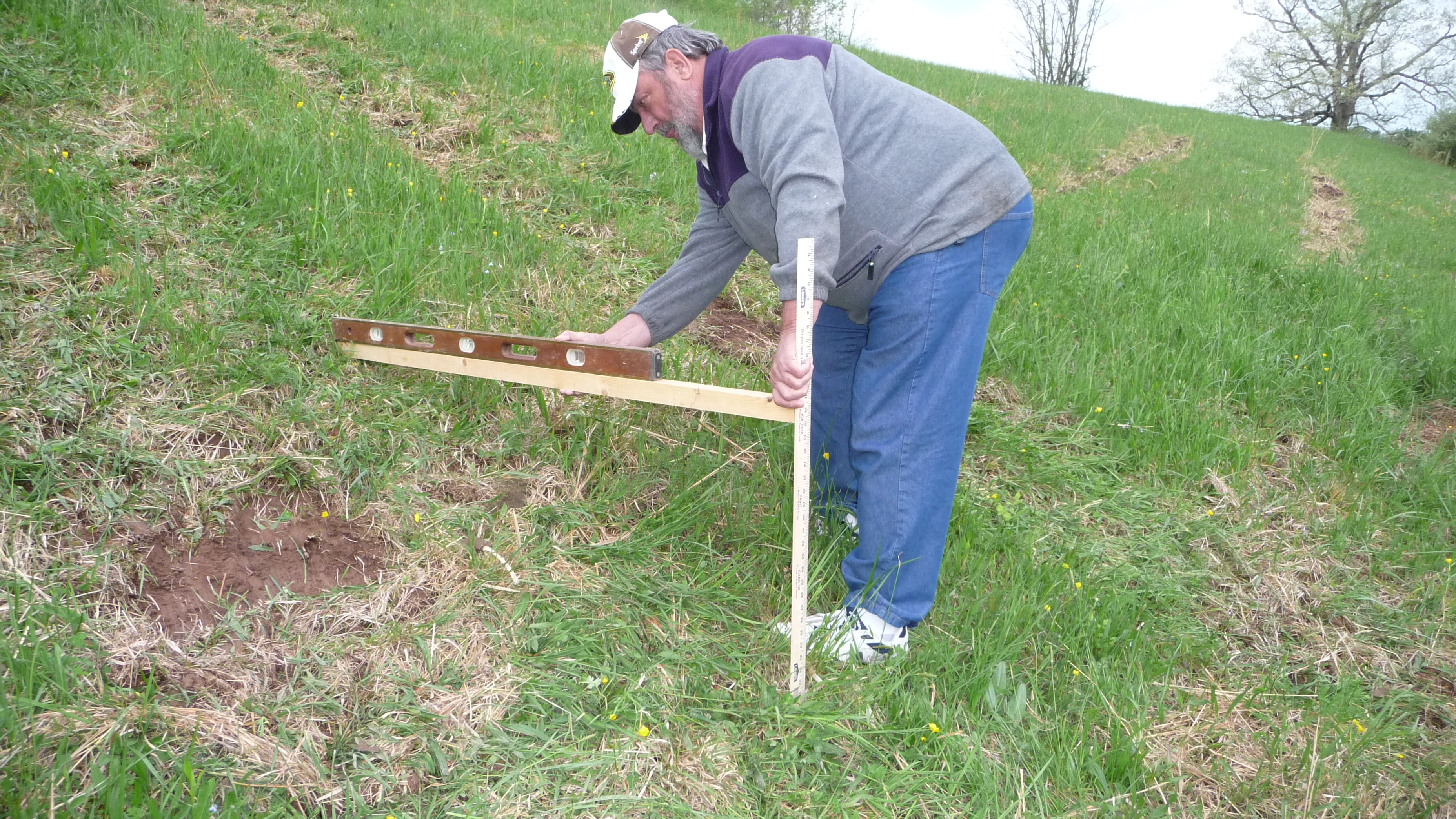

I read the first 14 posts and will chime in here a bit. 1) My eye is calibrated differently. That looks tome like it could be fairly steep. Find the steepest spot and measure how much drop there is per horizontal distance. Use some 2x4s, a helper and a level. If the drop is more than around 40% of the horizontal distance you do not want to be going across the slope. It is always better to go up and down if you have room and a choice anyway. 2) I don't totally agree about the FEL. If you keep the bucket low just clearing the ground it does provide help with weight in the front & in my judgement is just as safe as without it. HOWEVER, be smart enough not to raise the bucket on a side slope. By the way your weight is significant in the tip-over equation because of the relatively small total tractor weight. You get a feel for that if you ever come close to tipping it. Can't tell from your picture but there may be "room to maneuver" issues with the bucket on as well. 3) The little buggers are pretty stable & forgiving. Even when one starts to tip you can usually feel it coming and reverse whatever it was that caused you to start to tip. HOWEVER, an unexpected hole on the lower side OR a big hump on the upper side can suddenly cause a rollover. Penn State does a live demo (using a robot controlled tractor) of that at their PA farm show in August every year. Very worth watching if you have not seen it. 4) In summary, mow up and down rather than laterally if you can. If the slope is less than say 30% you won't have to worry anyway.

Interesting to hear your experiment with tipping on a hillside. Good info. About slope measurement: A 15 degree slope is about 28%. A 23 degree slope is aout 41 to 42 %. I agree with your conclusions about the BX on a 15 degree slope. I can also see it being tipsy on a 23 degree slope. A graphic and 2 pics to add:
The chart is helpful comparing degrees vs % slope. The picture with the lumber and level is a 40% slope portion of the hillside from longer view in the other picture. That is essentially the steepest part. I use that hill for testing brakes and other steep ground things I run into.
