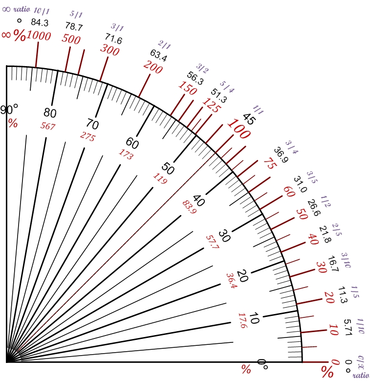

Since JWR's chart didn't show in post #18, I will post one that shows angles, degrees and ratio:

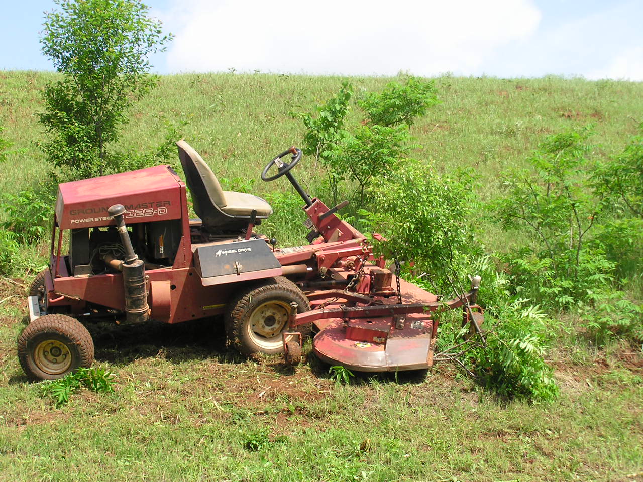

And side hill mowing the 1/2 ratio, 26.6 degree, 50% slope, back of the dam.
   / Nervous about mowing this hill with my new BX1870 #25

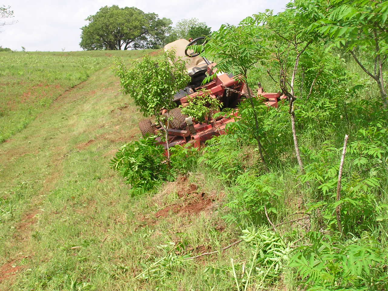

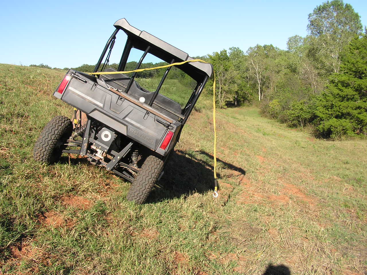

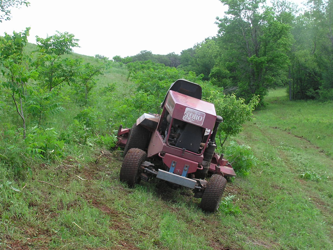

Good chart with a little more detail than the one I had. It is always hard to tell from a picture but 2 out of 3 of your pictures don't really seem to be as steep as 50%. A 50% slope is pretty much my limit for mowing with a bush hog unless it is just a short section I can come straight down.

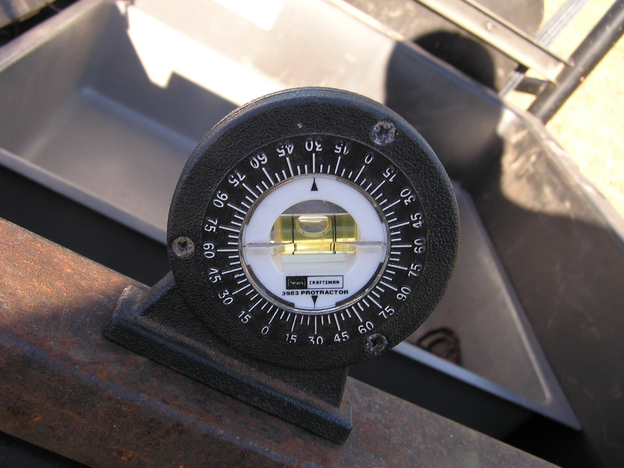

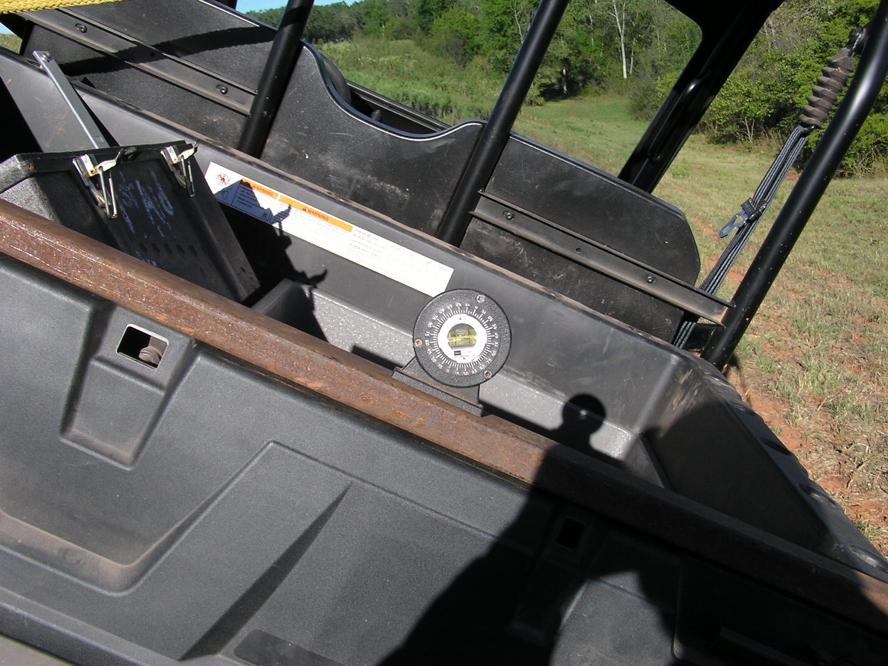

Yep, that is why I took these pictures in the same area.
The hanging tow rope compensates for any camera lean and shows true straight up and down. The protractor shows 30 degrees of body lean on the 50% slope.
