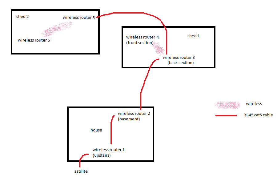

Okay, I'm used to cable Internet in the city. An actual cable comes to my home and a modem is attached to that. One cable from that to a router and a couple switches and I'm good to go. Router provides wi-fi for tablets. All the sub-nets I want, all the firewall rules I want, port forwarding, passwords, whatever.
Out in the country there are no wires. So I have a wi-fi 'router' (supplied by the service company) out in the yard that gives me access to the Internet fine. My TV supports wi-fi so we get Netflix and I can reach TBN. They gave me one fixed IP address so my wi-fi camera can be accessed from outside.
But I have no idea how to hook up non-wifi equipment to this network. Like my printers and scanners. How do I make them network accessible now that there is no Ethernet to plug into? :confused:
   / Networking Woes #13

This is a possibility. Get it set up and hook a small switch to the Ethernet port.

Davrow,
use a wireless access point. Has ethernet jack for nonwireless. It talks wireless to ur wireless router.
   / Networking Woes #17
You should be able to distinctly name the different gateways (SSID) via the router interface ?
