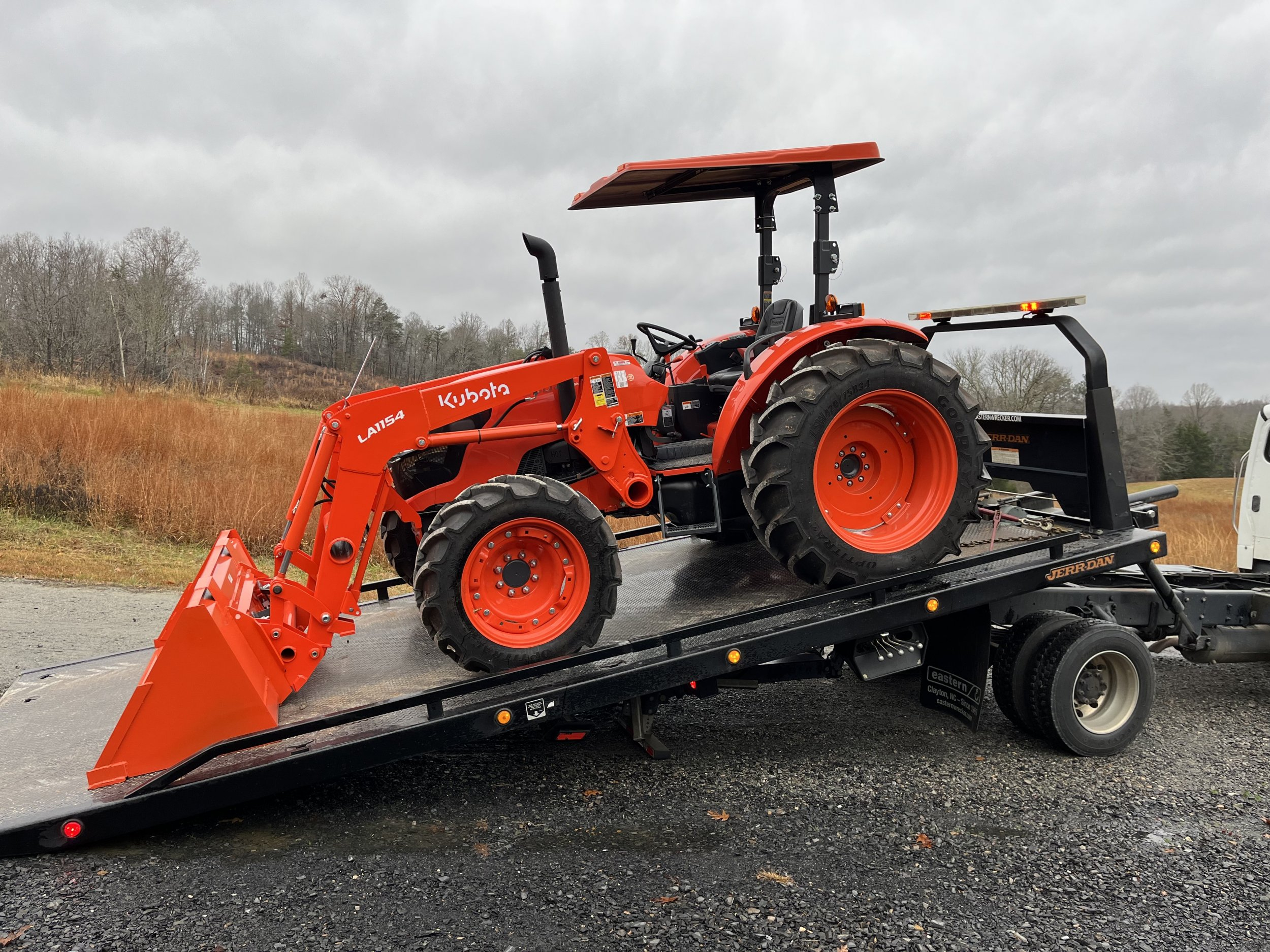

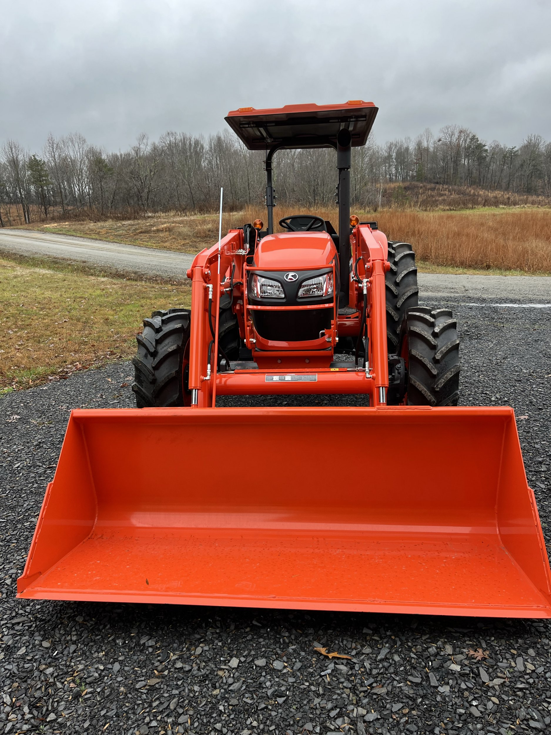

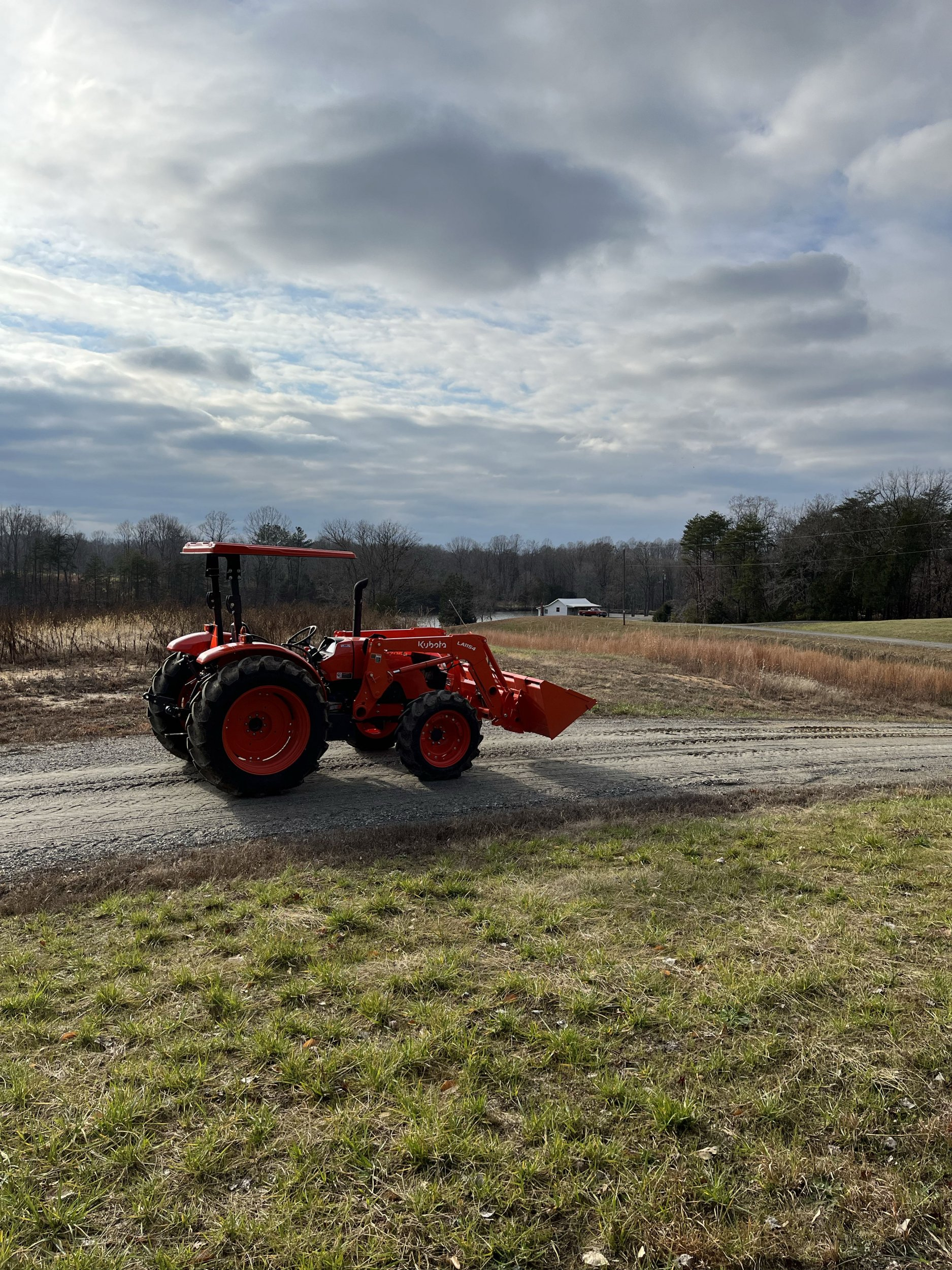

Here’s a couple pics. The one picture shows the first work I did with the M7060 which was pick up a full bucket of mixed wet gravel and dirt. That’s a deep 84” buck so holds a lot of material. Had nothing on the rear and tractor handled all that weight with no issues at all even going down one decent grade.
And when I went back into edit I now see the option for “none” for a prefix. Guess I missed it before. Lol.
