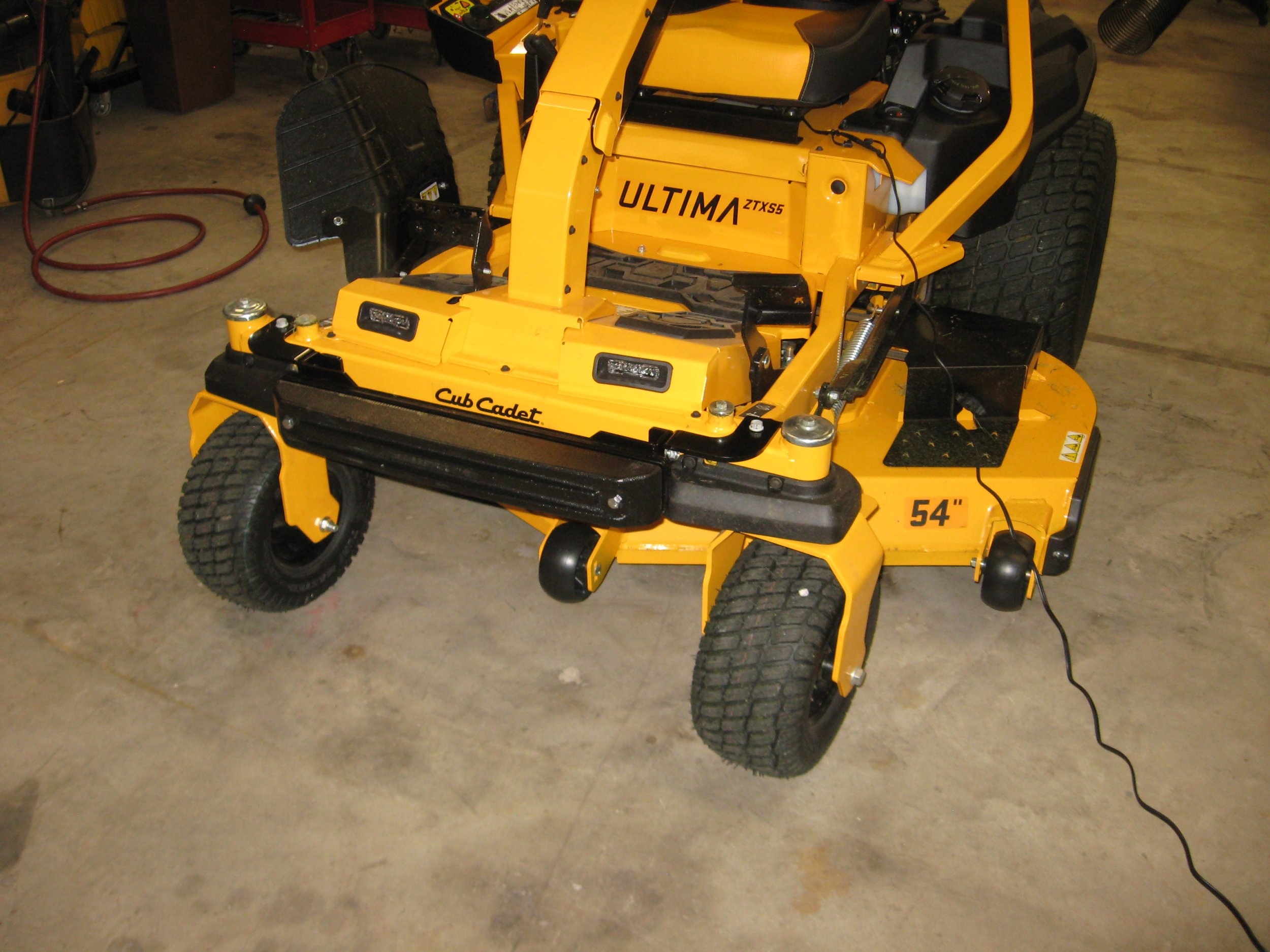

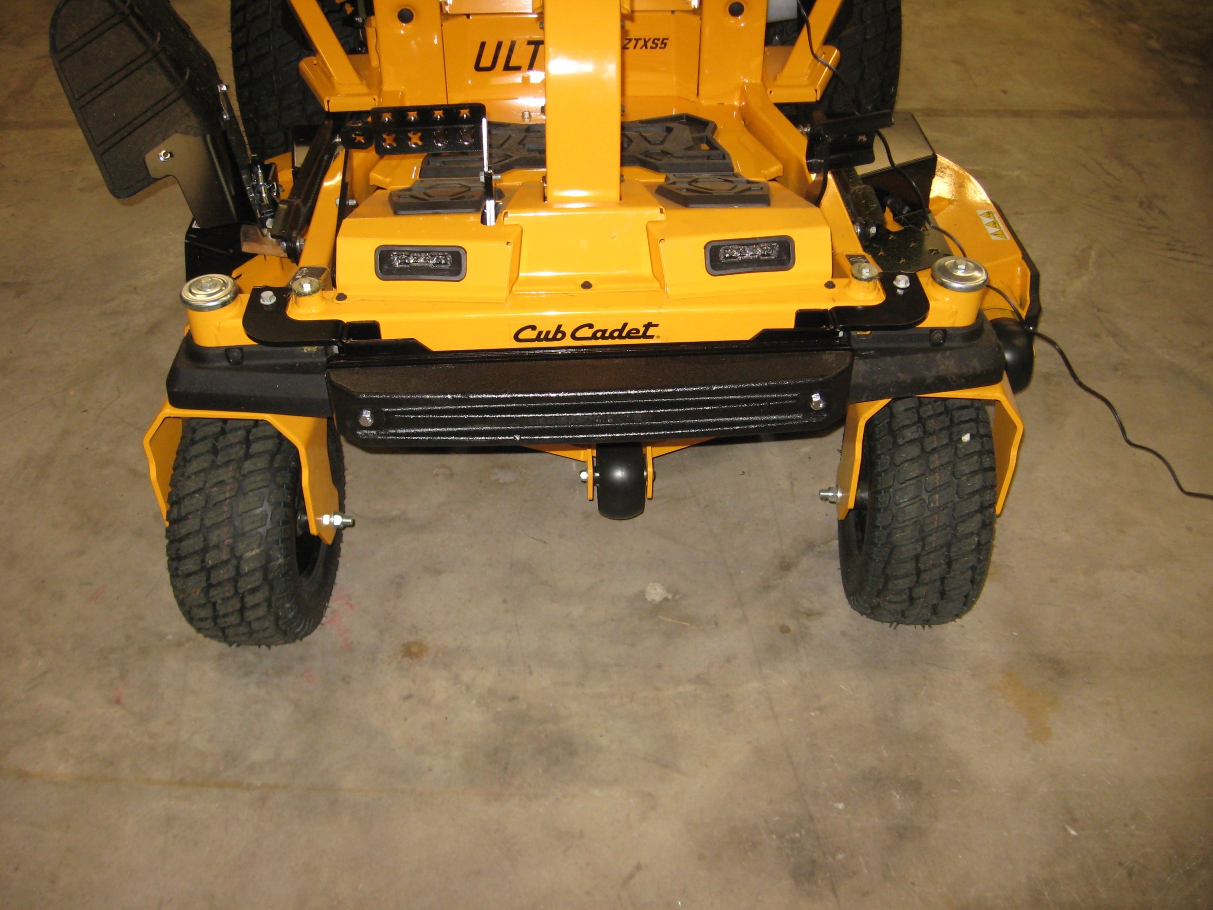

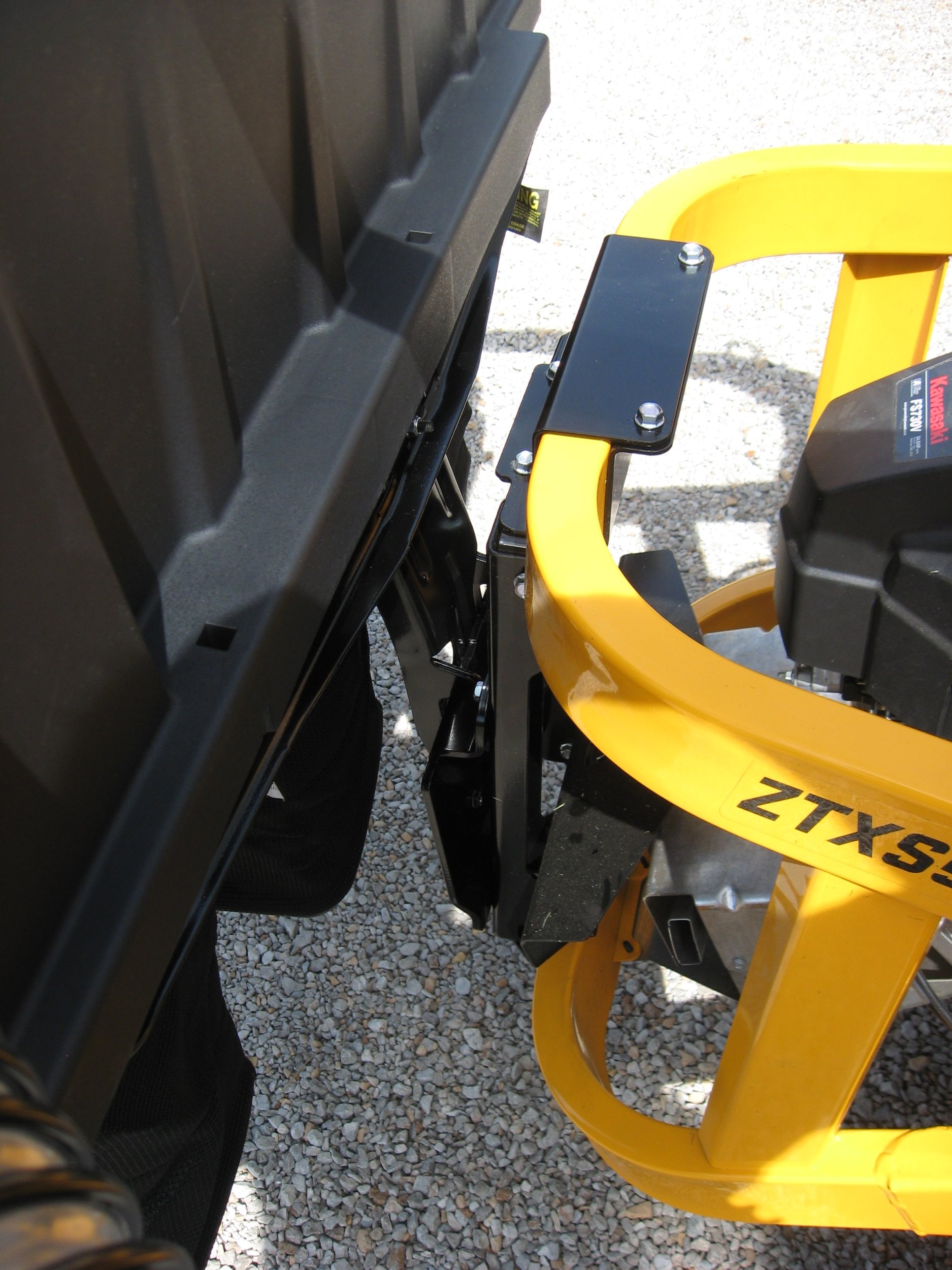

Installed the front weight kit today. This consists of four brackets and four weights. The big weight is cast iron and weighs 32 lbs. The other three are flat steel plates that weight 4 lbs each, totaling 44 lbs.
Will try mowing with the extra weight and see how it affects steering, balance, etc. I expect it to help all of those and maybe even improve the ride, but that may just be a pipe dream.

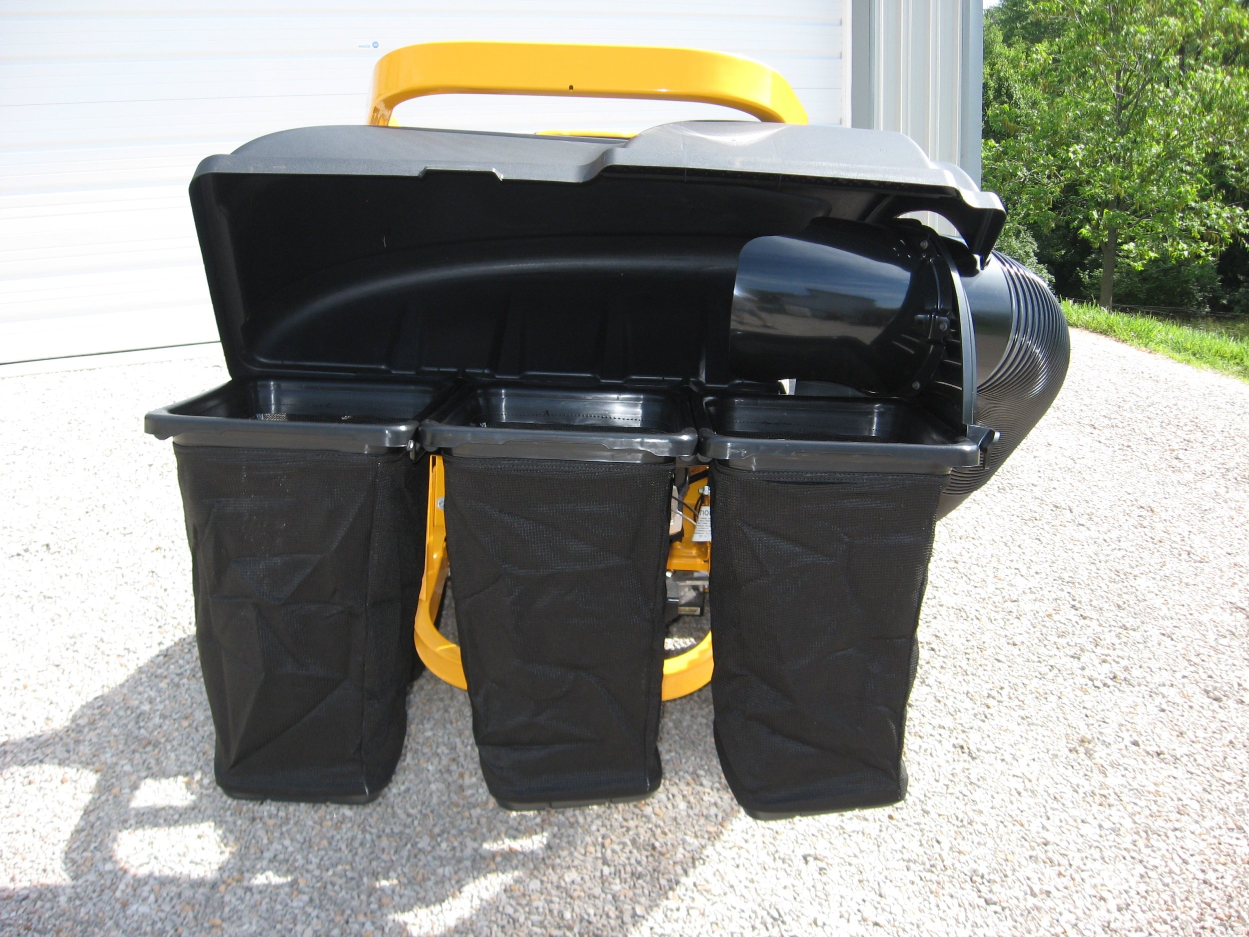

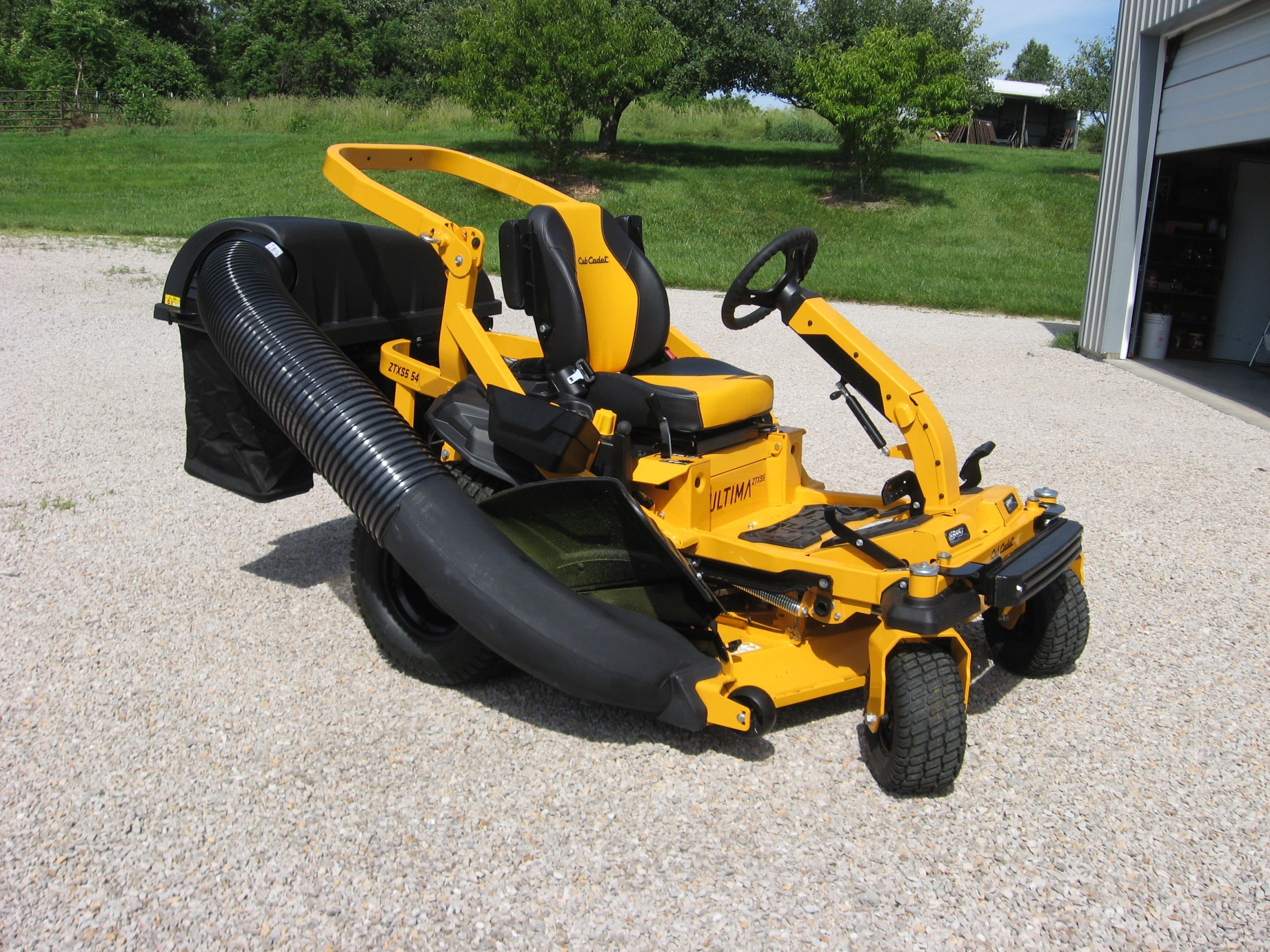

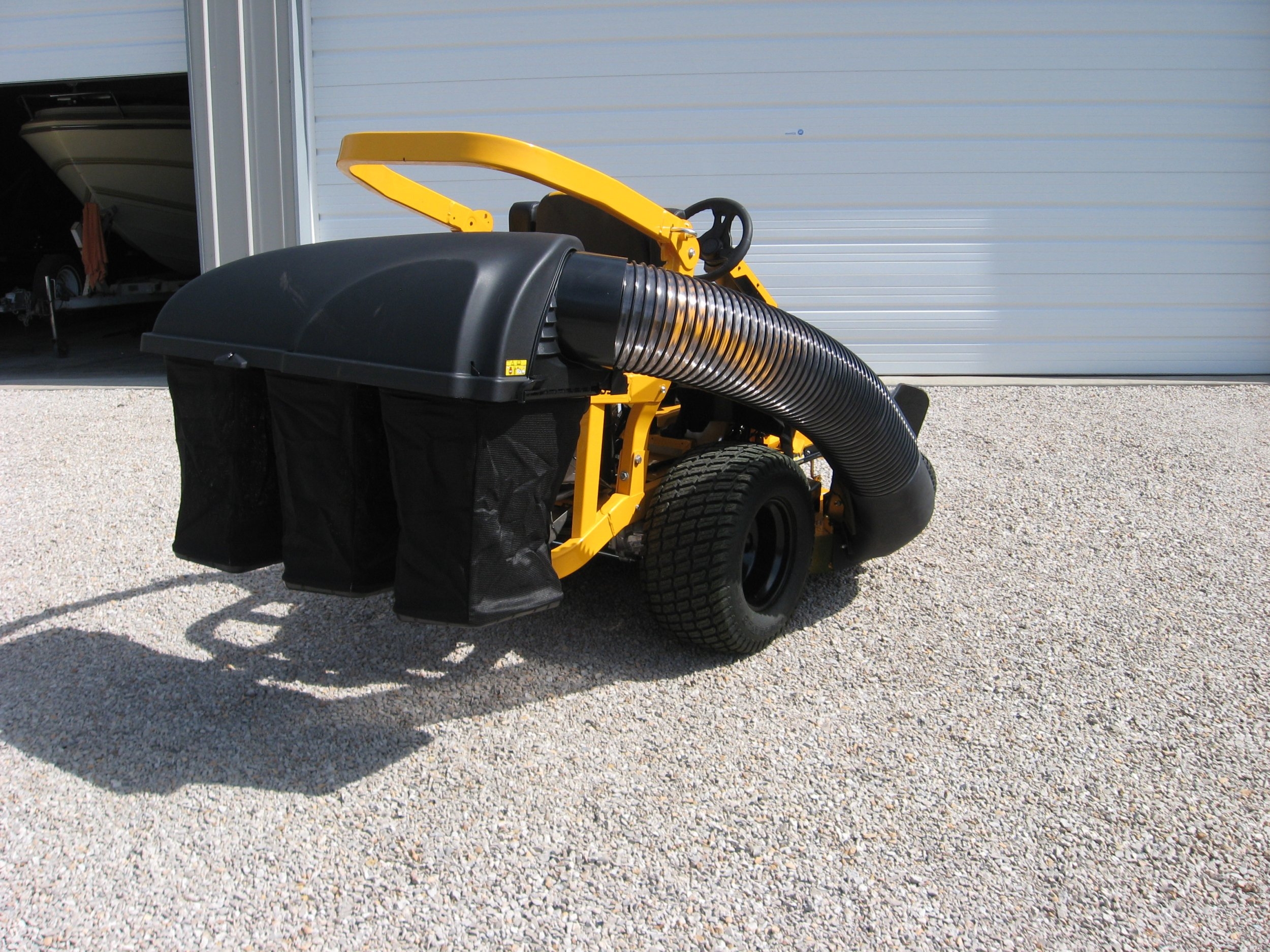

Spent the rest of the afternoon assembling the bagger. More to come on that in future updates....
View attachment 872108View attachment 872109
I'm under the impression that ZTR's drive like a buck board unless they've got suspension, or a suspension seat. That was a warning I've heard repeatedly.
If you end up adding a suspension plate to the existing seat, or replacing the seat, I'd love to know how much of a difference it makes for you.
Your dealer could have suggested this.

Didn't know this was an option. Very curious to hear your thoughts after mowing with it.

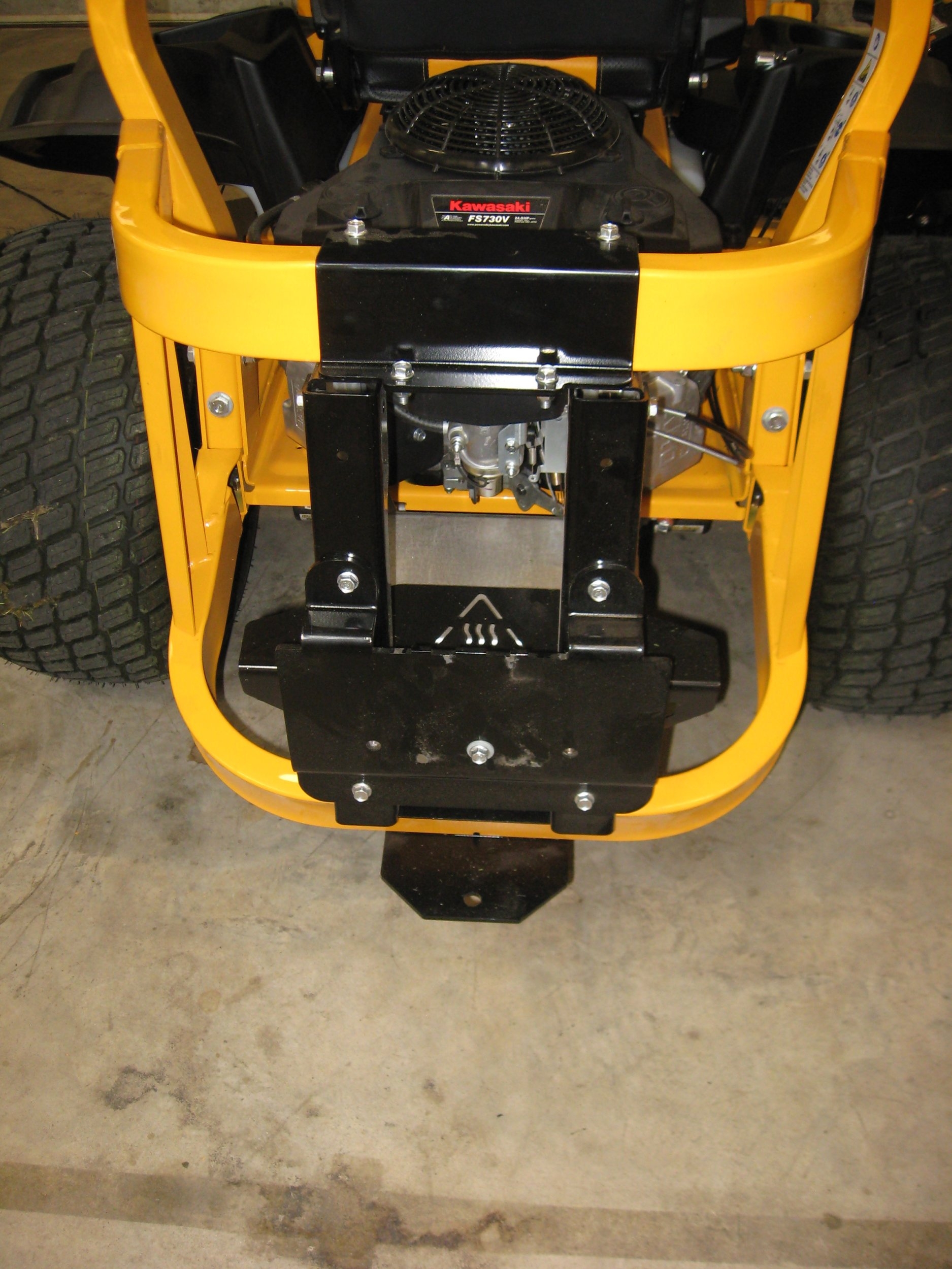

As far as I know, it's not a stand-alone option (but it should be). It only comes as part of the three-bagger kit. That kit is also used for some of the regular ZTR models, so it comes with brackets that only fit those, which are not used on the ZTXS. You have to order a special bracket kit for the ZTXS and this is bolted to the front frame with self-tapping 3/8" galv. bolts.
So, this solves the mystery as to why you need "Adapter Kit 490-950-C062 ", even though the bagger comes with the front weight brackets. The brackets included for the regular ZTR's are one-piece, but the "special brackets" are two pieces per side, made specifically to fit the ZTXS models.
EDIT: The front weights ARE available separately as parts from CC. Not a "kit", but you can buy the "adapter kit" listed above for $49.99 and the cast iron weight as a separate part number 719-04271A for $229.71. The extra weight plates are also sold as separate parts number 789-02137 for $44.90 each.

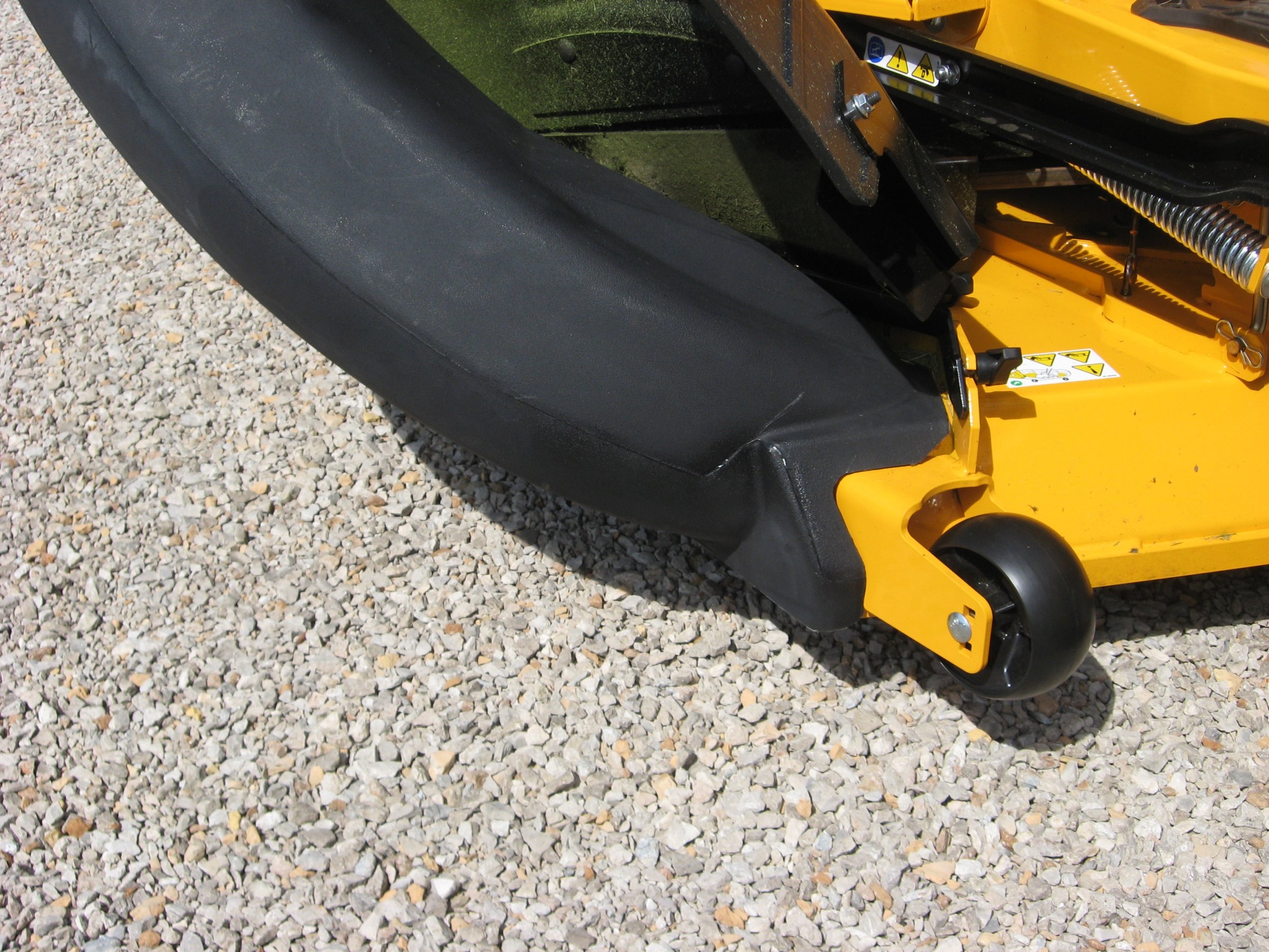

Tested the bagger today, results in next posting.
