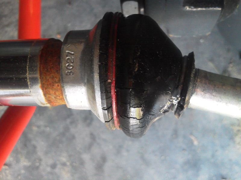

I recently bought a BX2360. I have 4 hours on it and when I finished mowing I was going over it and noticed my steering boots were greasy. Looking further I saw they were dry rotted and split.
To those of you that got them fixed. How long did it take at the shop?
I called the service manager and he said they did not stock them. He would have to look at it first. So I'm going to bring it Monday. He didn't sound happy. Kind of like. Why are u calling me attitude.

<img src="http://www.tractorbynet.com/forums/attachment.php?attachmentid=316084"/>
Probably annoyed at yet another unit that needs to be fixed. At 4 hours, don't back down.
