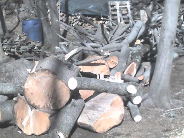

Splitter in action to day on a large maple I took down for a friend, (ice storm damage) He doesn't burn, so all the wood was mine...
At 1500 rpm worked great. A piece or two of the really knotty stuff were a bear but eventually I was able to get them to burn able size...
Notice the trunk diameter...
